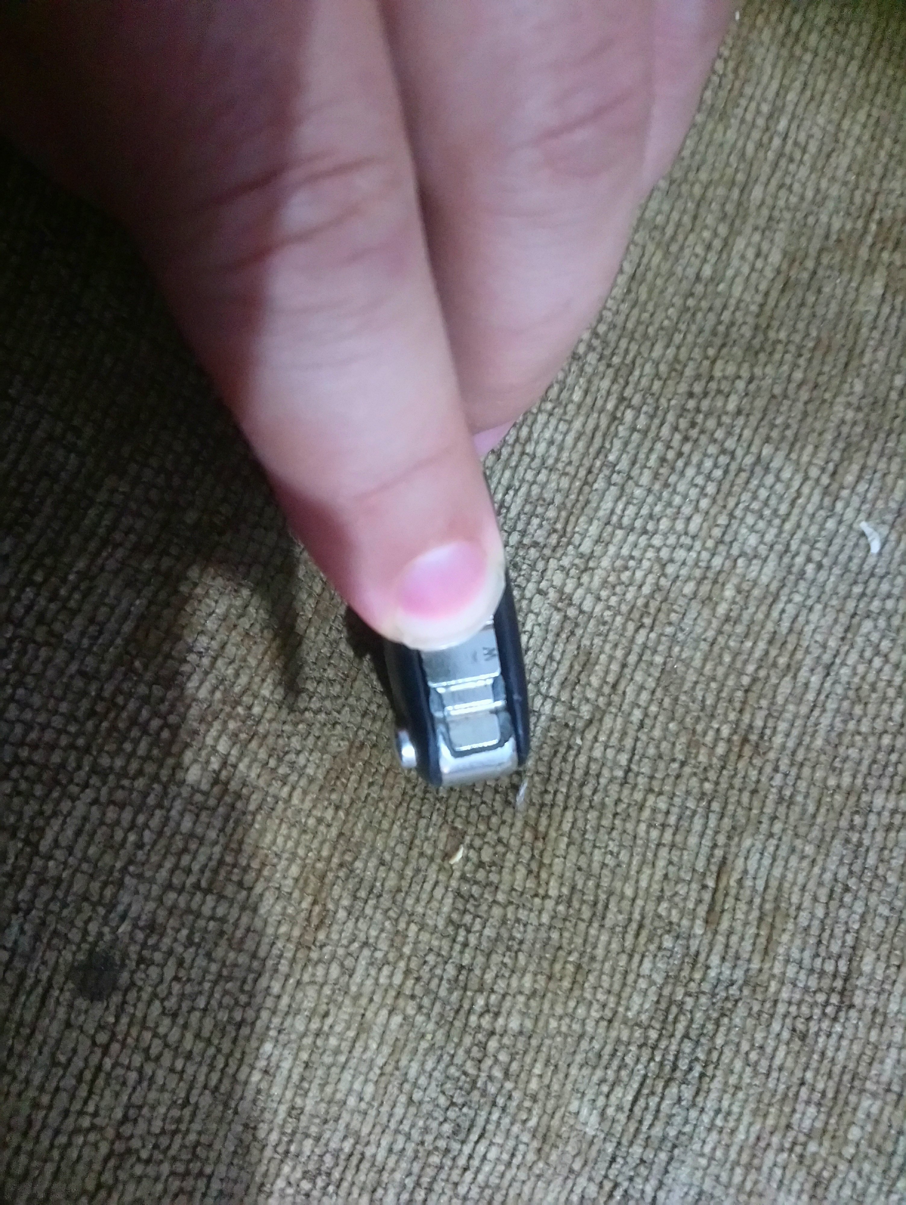

That's the problem! The blade is intact. The broken part is the folding mechanism where the pin secures. If you look closely at the picture you will see the breakage.
