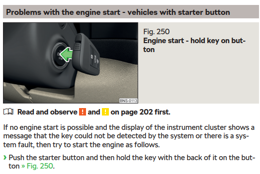

As above, use the key located in the fob to open the door and place key next to start/ stop button as per the instructions in the owners manual.

Yes I know there is a key on the fob but once in car there is no ignition to put key in. It's a push the button start on my SEL.
So question remains, is it possible to start the engine when fob battery dead?
Yes it is - as pointed out by others - simply use the whole fob to press the starter button as per the manual

My key fob died this morning among the mountains...
I could open the car but not start the engine as described in the manual. Luckily I had a spare battery..
