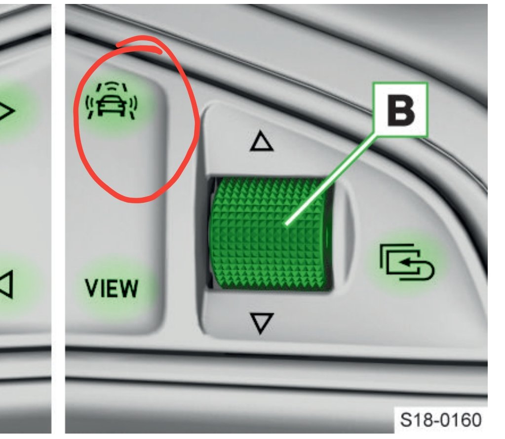

On the right hand side of the steering wheel, press the button with a car symbol with markings around it to enter the assistance systems menu.
Turn 'front assist' off next time. It'll re-enable next time you start the engine and will warn you it's off until then.

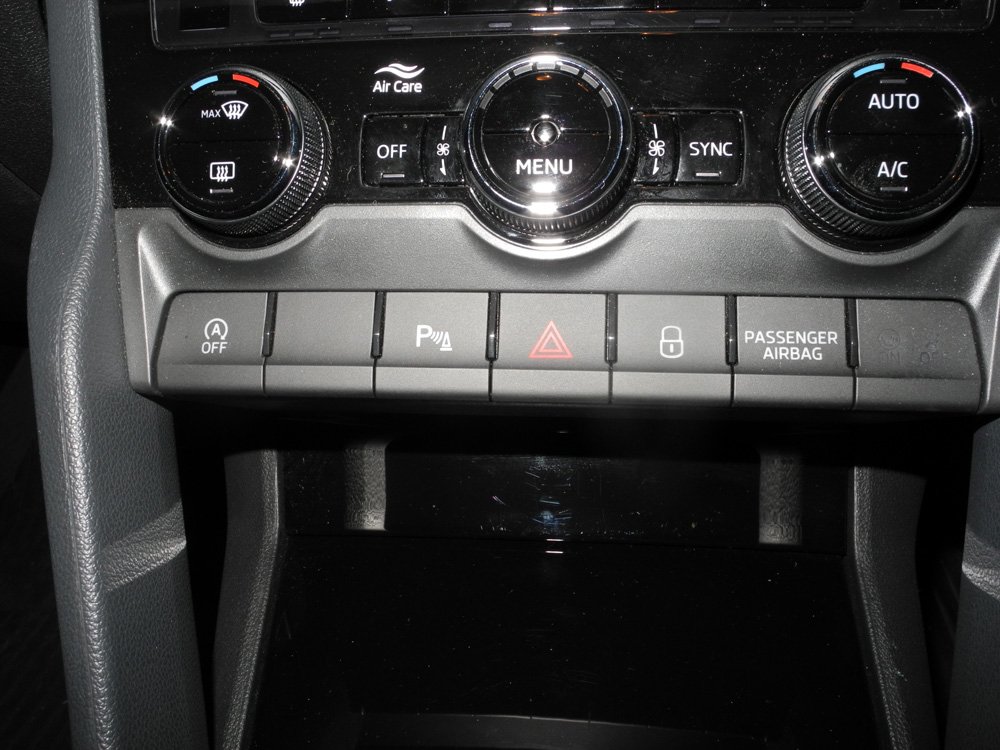

There's very little on the RHS of my steering wheel but that could be because mine is an SEL whilst yours is an Edition. Is the 'front assist' that button with P and 'radio waves' emanating from it?

Press the button circled in red - you can disable front assist there.
This is the quickest way to do it and does not require you to navigate menus on the infotainment screen.
Many thanks, LBFS, but there is nothing on my SEL that resembles your picture - I suspect that it's because you have the more comprehensive 'Edition' model. I am wondering if the equivalent on the SEL is the 'P' button to the immediate left of the hazard flashers.
The 'P' button you mention turns the parking sensors on and off, but doesn't have any impact on the front assist system.
Could you take a photo of your steering wheel? I've looked through auto trader and all the SE-Ls there have the standard Skoda steering wheel with the button to access the assistance systems.

No photo needed, LBFS, it's there as plain as day. I thought that you meant to the RHS of the steering column rather than 'on' the wheel itself. I had never even noticed that button! I thank you with all my heart and offer you a virtual pint of Adnams Explorer or Green King Abbot or both! May I trouble you further? ...........
Presumably, as I approached the long grass that triggered the brake, I should have pressed that button - does that show on a warning light to remind me that the auto brake has been turned off? Would the system be automatically reset next time the ignition is switched on?

Aha, not a problem at all! Abbot will do nicely, though maybe one for when the car's at home...
You'll get an orange (I think) warning light on the dash, under the maxi dot display for as long as front assist is disabled. Front assist is ON by default when the car is started up, irrespective of whether you've previously disabled it.
