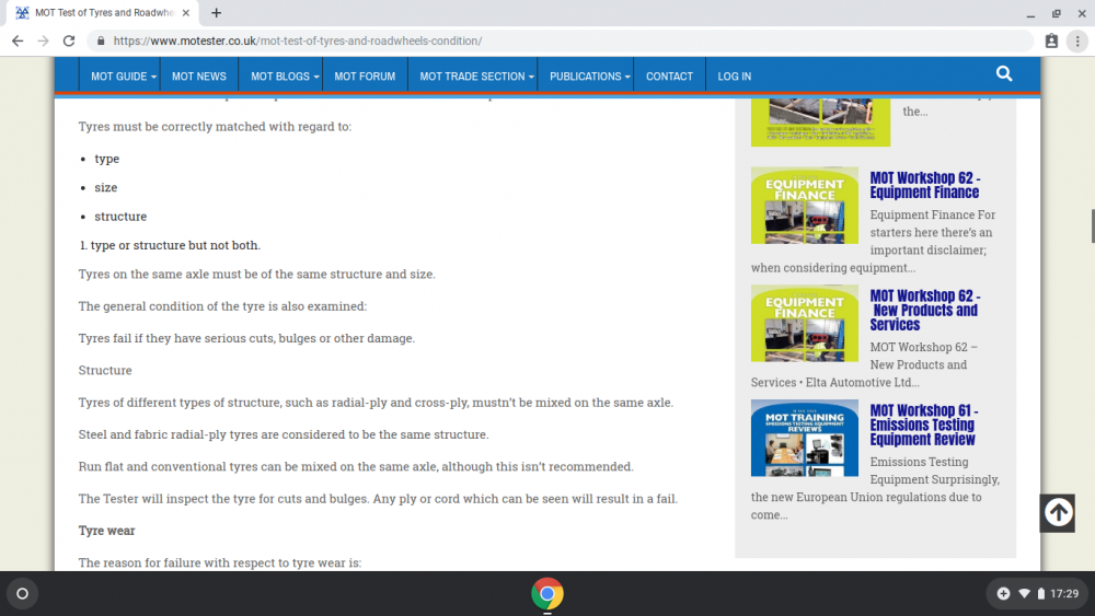

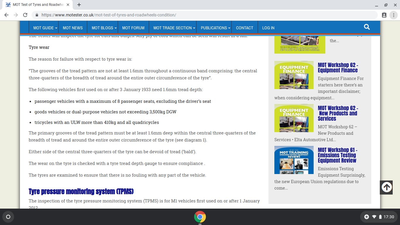

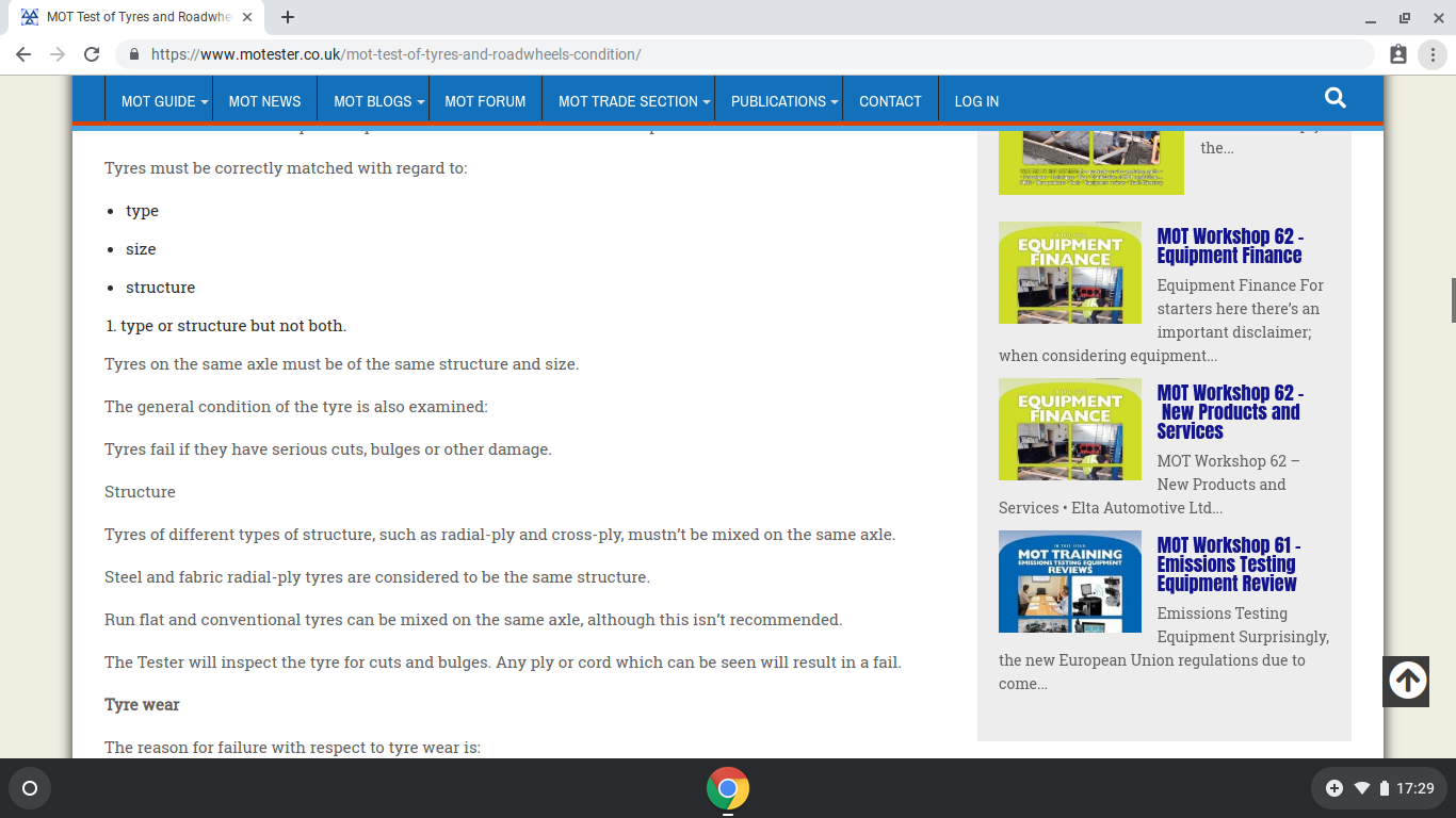

In the pipeline can mean long enough from being in a UK Mot.
Some people in the Tyre Manufacturing Industry will be lobbying the Government Ministers i take it.

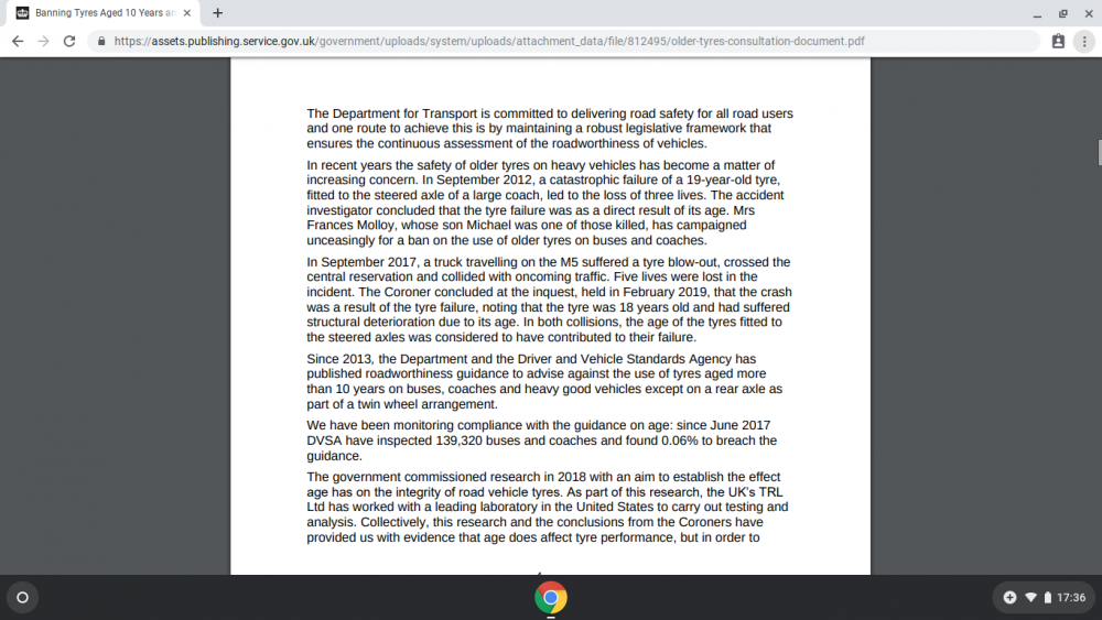

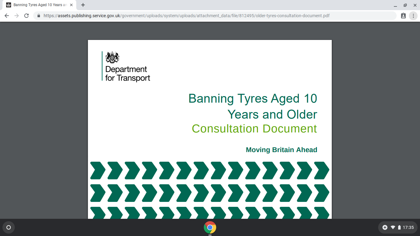

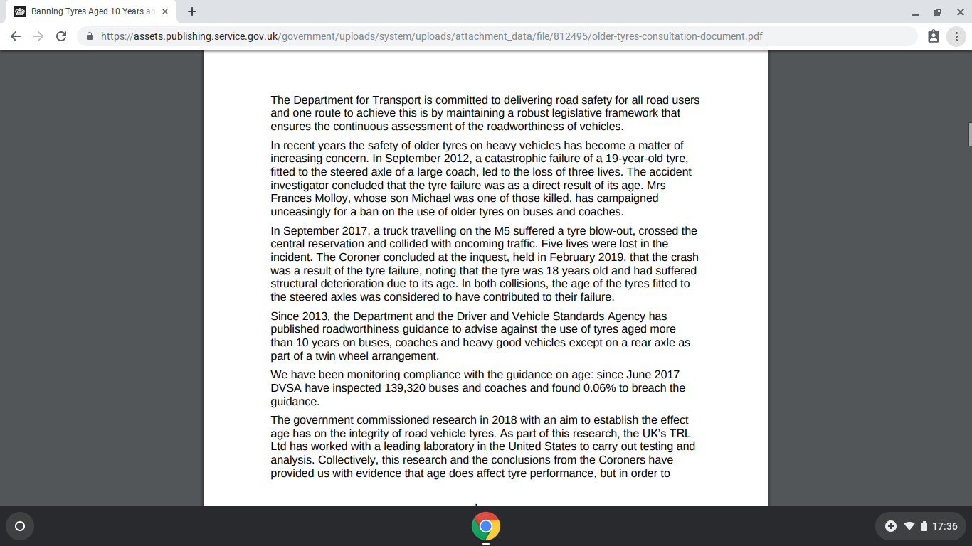

A consultation, and 10 years. More like the thing.
Especially for those PSV's / Public Authority vehicles and Police / Military vehicles out there that might be getting professionally serviced and no MOT yet are unsafe.
The Intro to the above document summarises the intent and scope:
"Our intention is to introduce legislation making it an offence to use tyres 10 years or older on certain vehicles. This is to improve road safety for all users.
Our current focus is on heavy goods vehicles and larger vehicles used to transport passengers. We are also considering if it is appropriate to extend this legislation to taxis and private hire vehicles, and how to enforce the requirements for these vehicles. The vehicle types included in our proposals are heavy goods vehicles (category N2 (over 3.5 tonnes but not exceeding 12 tonnes) and N3 (over 12 tonnes), heavy trailers, including semi-trailers (category O3 (over 3.5 tonnes but not exceeding 10 tonnes) and O4 (over 10 tonnes)) and buses, coaches and minibuses (categories M2 and M3). The full definition of these vehicle categories M, N, and O, which are based on EU Regulations is available at:
https://www.vehicle-certification-agency.gov.uk/vehicletype/definition-of-vehicle-categories.asp
We are also seeking views and evidence on extending the ban to taxis and private hire vehicles.
We are not including cars, motor caravans, trailers (3.5 tonnes and under) or caravans (3.5 tonnes and under) in these proposals."
The consultation period ended on 1st September.
