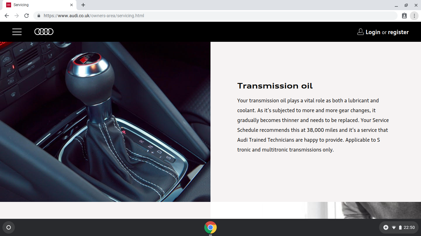

If you happen to have an Audi and they are calling the DSG a S-Tronic then it gets advised to be done at 38,000 miles.

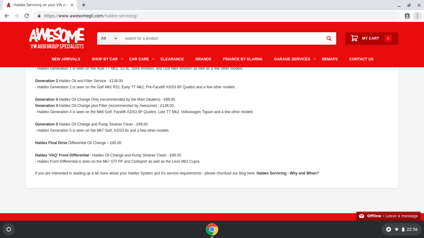

Those with VAQ remember the servicing of that.
