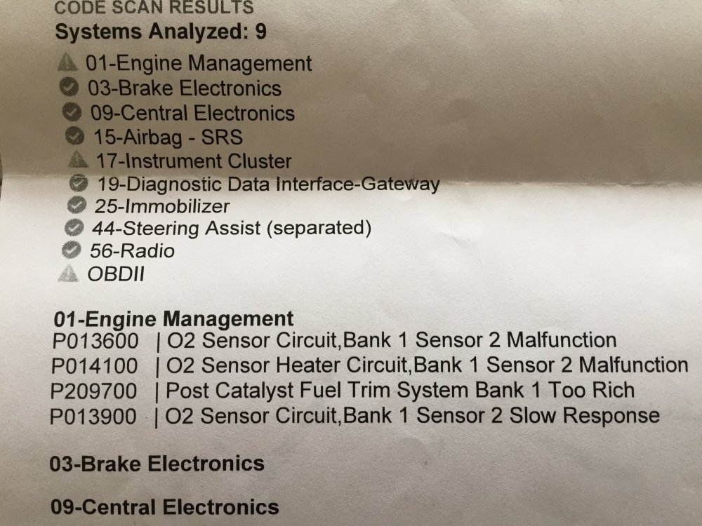

So I took my car to a local garage. They gave me the attached diagnostic report.
My reasoning for taking the car to a garage, instead of buying my own diagnostic equipment, was that the garage would be able to provide expert advice on the nature of the fault and how it might be resolved - and how much it might cost! Unfortunately, the guys at the garage were really unhelpful. They seemed to have a 'cards close to your chest' philosophy, for some bizarre reason. All they did was clear the faults and told me if the warning light came back on, go back to them. My questions about what the faults mean and how they might be fixed went unanswered.
Does anyone know about the faults detailed in the report? It seems the second lambda sensor is on the blink, but I don't know whether this is normal for a car of that age, whether it's serious, how much it'd be to fix etc., so any advice would be much appreciated.
Cheers!
O2 sensor faulty is what it looks like to me.
