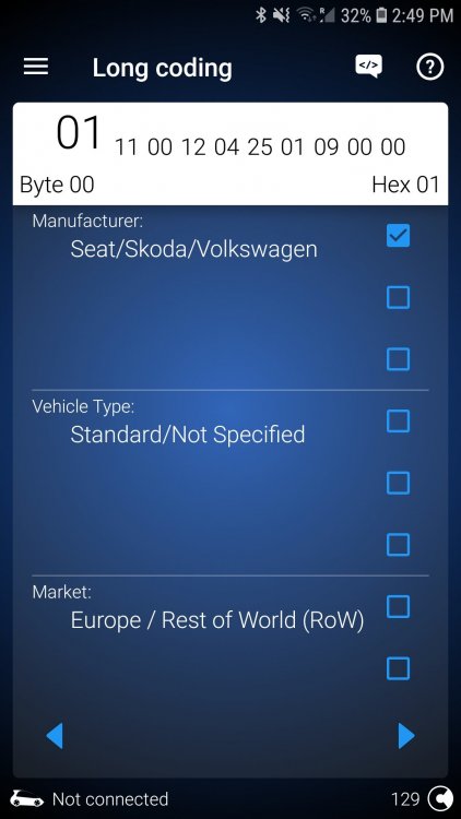

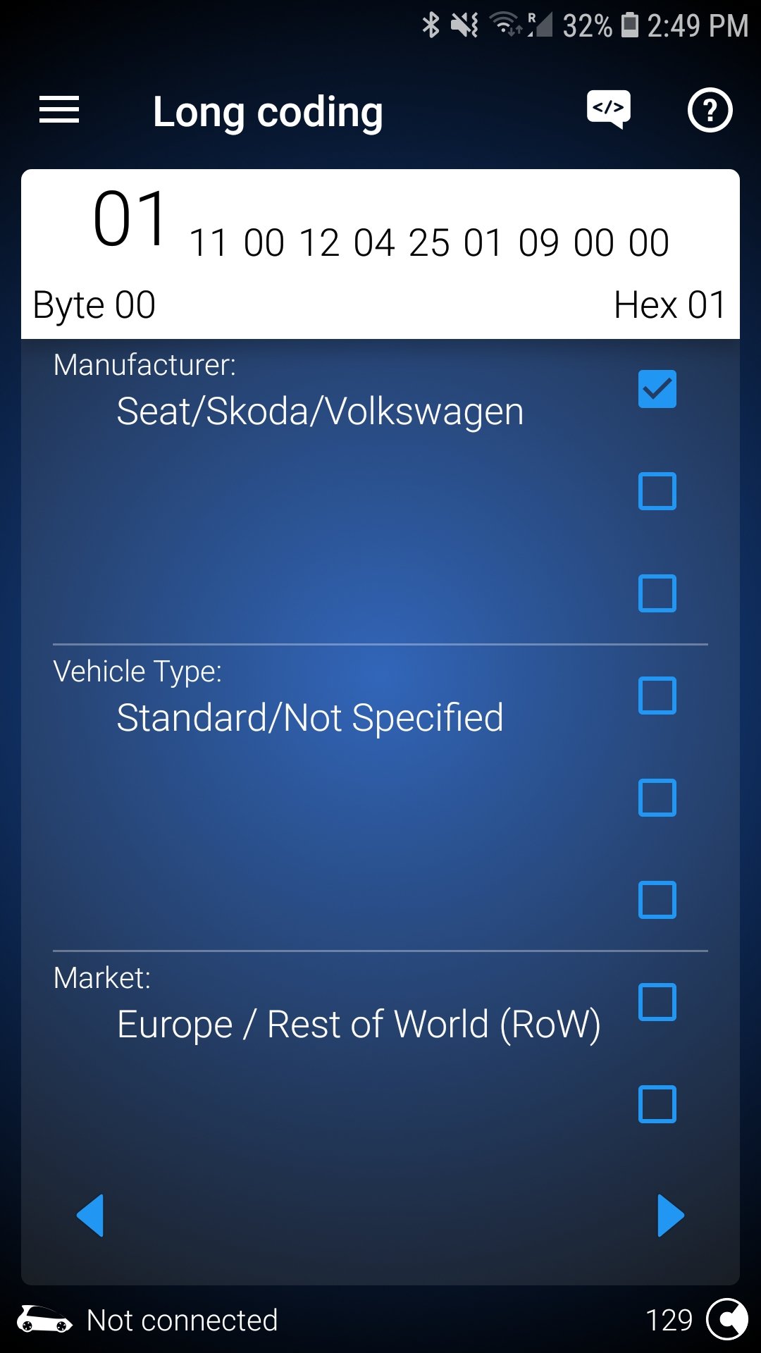

I think it's different for the newer cars.
On my 2015 octavia in that white box as you call it under BYTE 00 I see Manufacturer: Seat/Skoda/Volkswagen and by tapping on the blue ticked box I get a drop down that would let me select Audi.
Note: I've not done this mod, just clicking through OBD11 on my phone :)
This is what I see.
