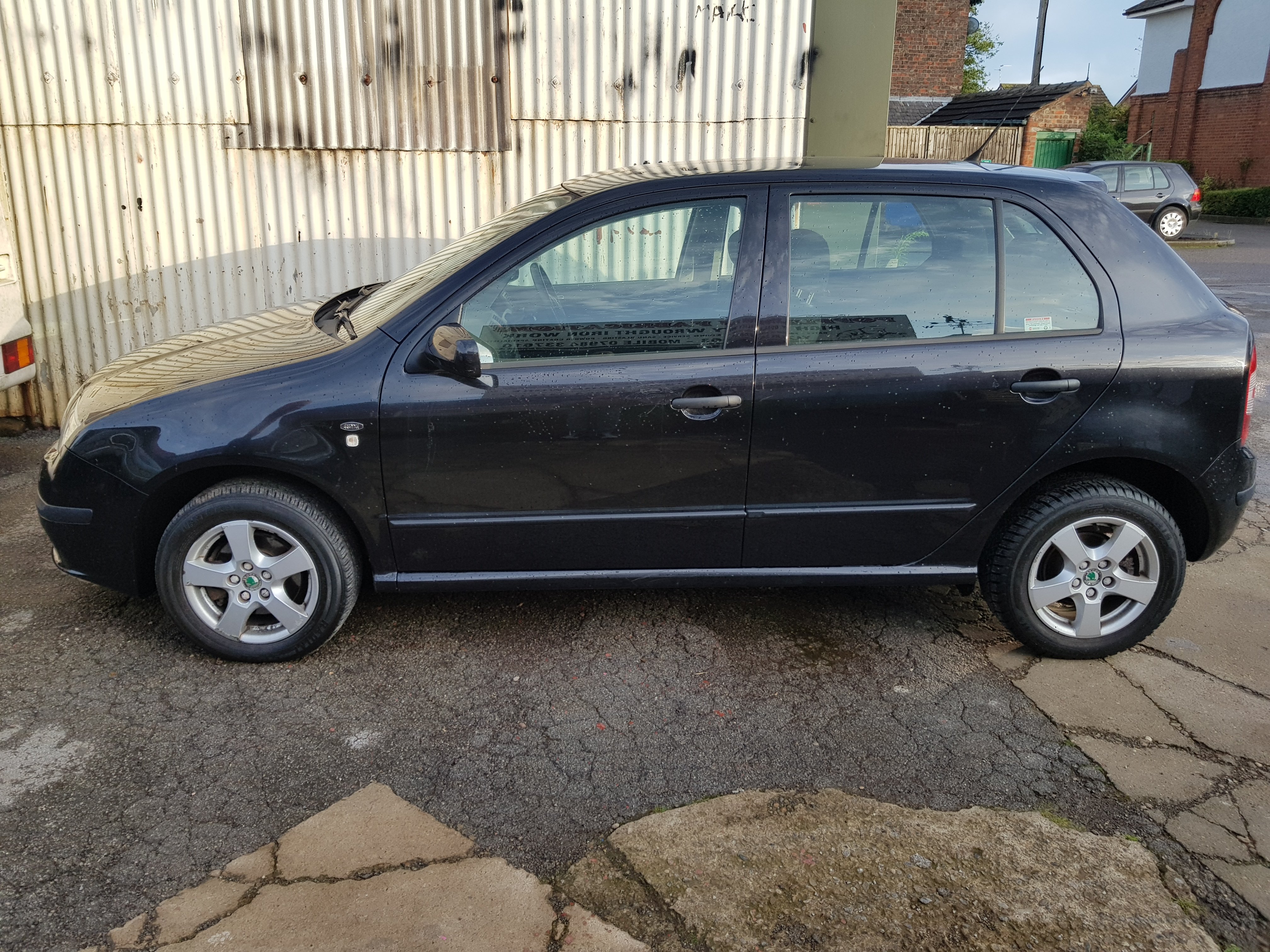

Need mk1 alloy wheel help!
Just aquired the 06 mk1 and wanting to swap the tired original wheels and purchase some new. Ive exausted the forum and ebay, what is a good reliable site for alloy wheels?
Feels like a minefield out there. Also is it possible to fit 17 as standard or too big?
Any help much appreciated, thanks

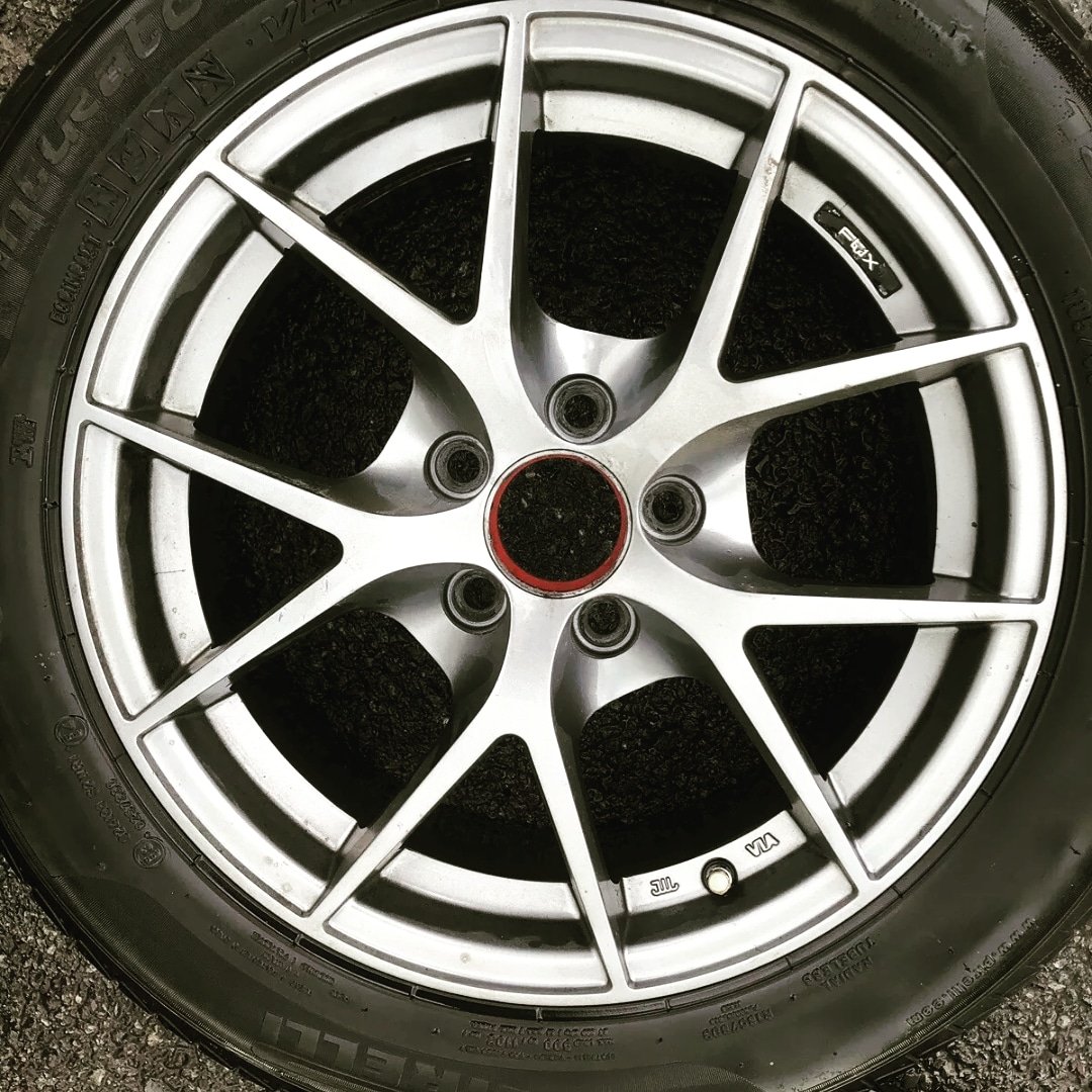

Anyway ive managed to snag a bargain on ebay and got myself some Fox fx005 rims. Will provide a pic.
Second hand but my first bought set, bit of cleaning needed. Once again thank you all for the advice

You may need spigot ring adapters if they weren't on a VW group car before.
Check what wheel bolts you need. Shoulder angle etc.
Also need centre caps.
Can get Skoda decals to add to centre caps.
What size are they?
What size are they?
Hi,
They have the adapters included, they were on a seat 1.2 before and looks like just lug nuts. Im going to measure up for the centre caps and are 15 inch.
