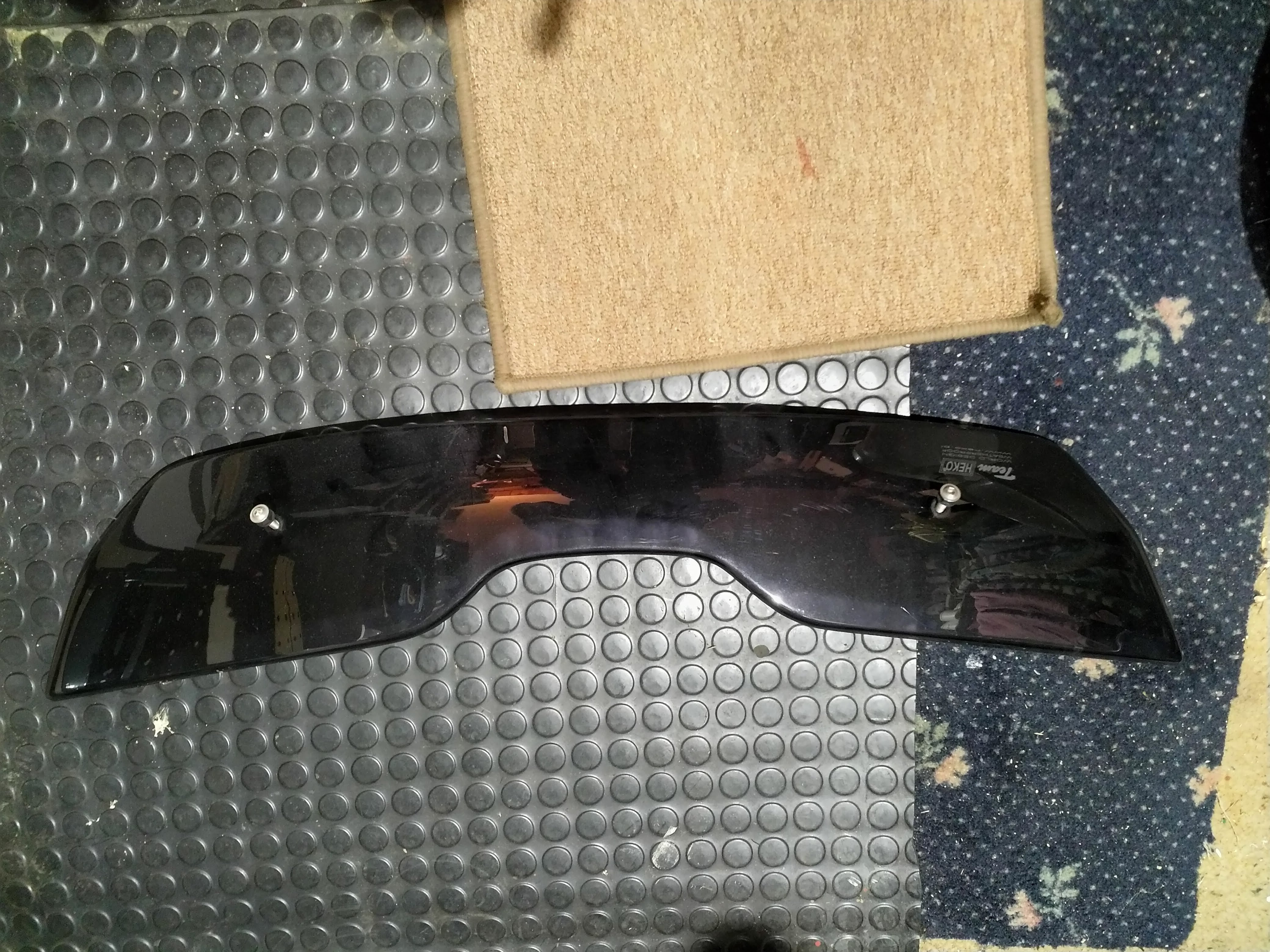

This thread reminds me, I had a front grill blanking plate for my Yeti but have not seen one for the Fabia.
I bought one from Team Heko
