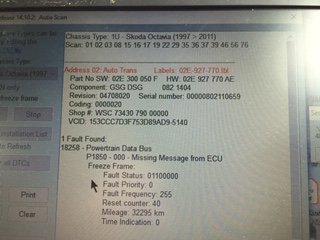

Haven't had a full VCDS scan done yet, all I've got direct access to is a cheap ebay code reader with an 'erase' option. The scan clears the lights for an instance, then the traction symbol comes back on with the flashing PRNDS lights.
Update, in that the car keeps returning to 'flashing PRNDS' status. At that point it cranks, but doesn't fire.
I can clear using a borrowed  VCDS, and at that point it will fire and indeed drive normally. As long as I don't switch off for more than 2 mins, or lock the car, everything is fine but after that, back to PRNDS status.

The picture you took of the VCDS autoscan is somewhat confusing.
The chassis type is 1U which is a MK1 Octavia yet the DSG part number appears to match a MK2 (1Z chassis). I assume the incorrect selection is what prevented the engine ECU appearing above the DSG too.
At this point, I'd suggest you do a full autoscan and leave the chassis type as 'auto select' or similar.
Once that's done, post the full autoscan rather than a blurry picture. You can either use the save button and attach the resulting txt file, or the copy button and paste the text into a forum post. Both options are much better than taking pictures...

On that basis, the car is now with local VAG independent specialist WCC, based in Neston on the Wirral. They ran a VCDS check and they've told me that the same 18258 - P1850 code is showing against the correct car type. A number of ABS related codes also showed up. The oddity, as reported to me me is that the VCDS wouldn't connect to the engine, they got around that by using the auto scan route, and that enabled them to get to the codes and clear them.
But the same problem reappears in that it immobilises again as soon as you stop the car. The second oddity is that when the car is running, there is absolutely no problem with it, mechanically it drives fine, changes gears when it should and stops fine. Some corrupted messages are getting back to the controlling system.
