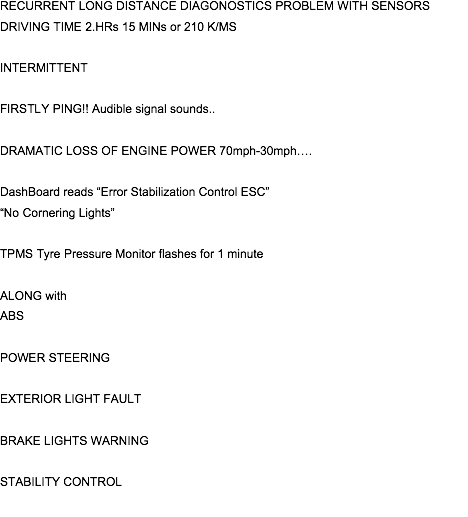

The following lights and error codes.

Dashboard reads .........
ERROR STABILIZATION CONTROL ESC
NO CORNERING LIGHTS
TPMS
ABS
Power Steering
STABILITY CONTROL
All same as before..........
