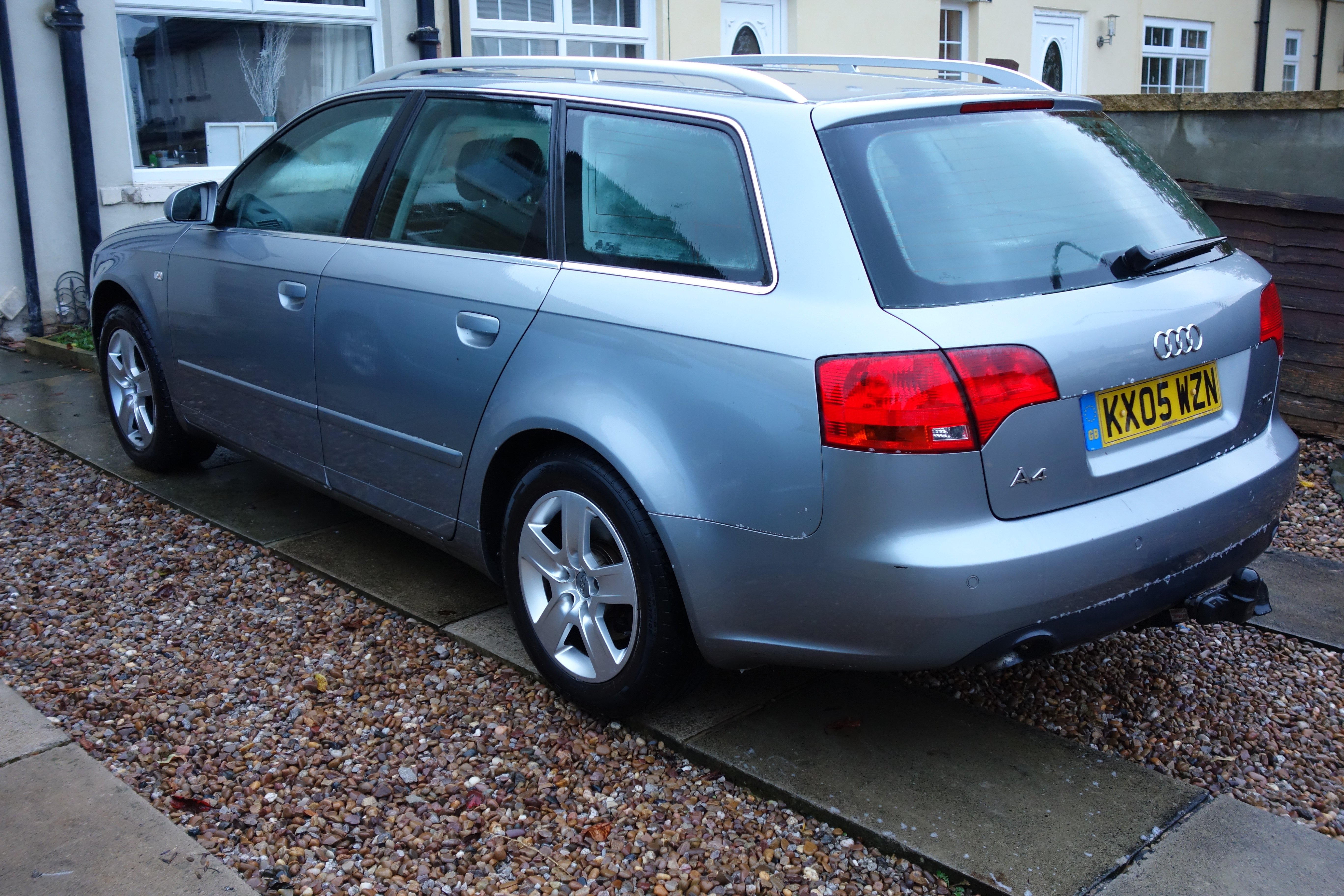

I've ended with with something a bit different an A Avant 2.5TDI - owned by someone who works next door to my brother (both mechanics) and known the car for ~5 years.
TBH after 3 time wasting dealers in a row, happy to deal with a real human. Great price, but a few niggles (needs new air-con compressor) and I've just fixed a couple of sticking air vent motors.
