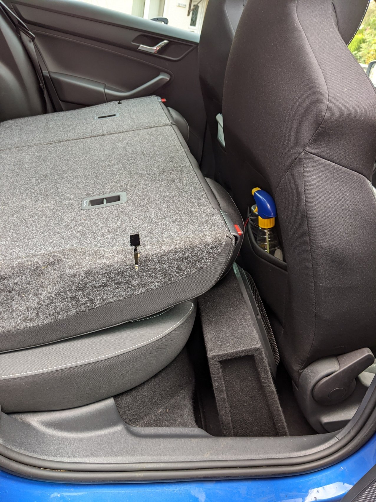

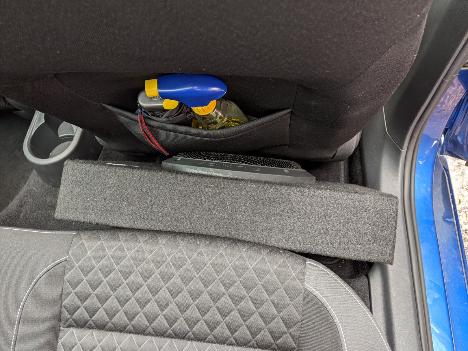

Just a quick couple of pics to show the sub box in it's alternate location, seats down, ready for a tip run:
Works just fine and I now have vibro-massage function for my back if I choose the right music :)

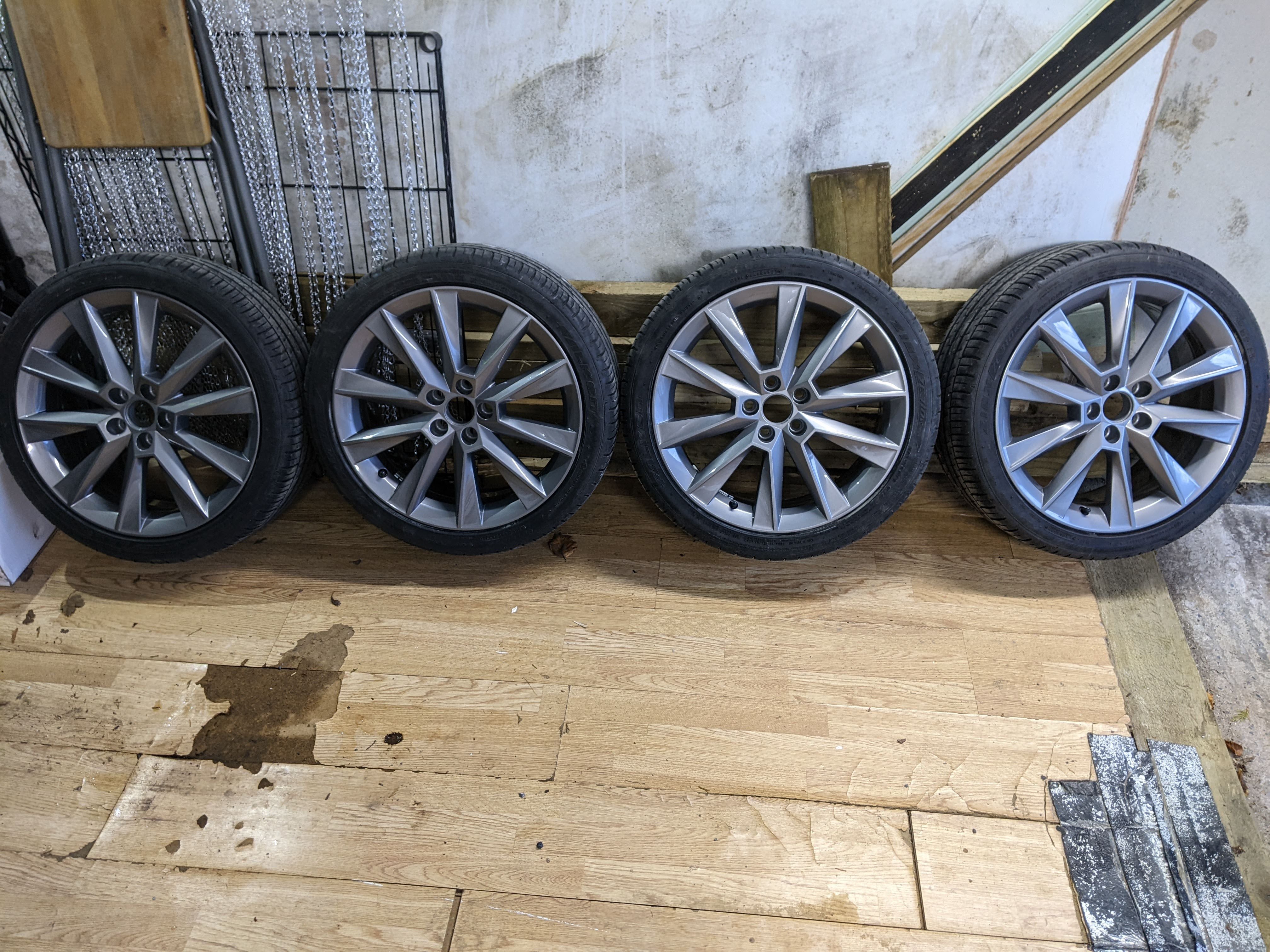

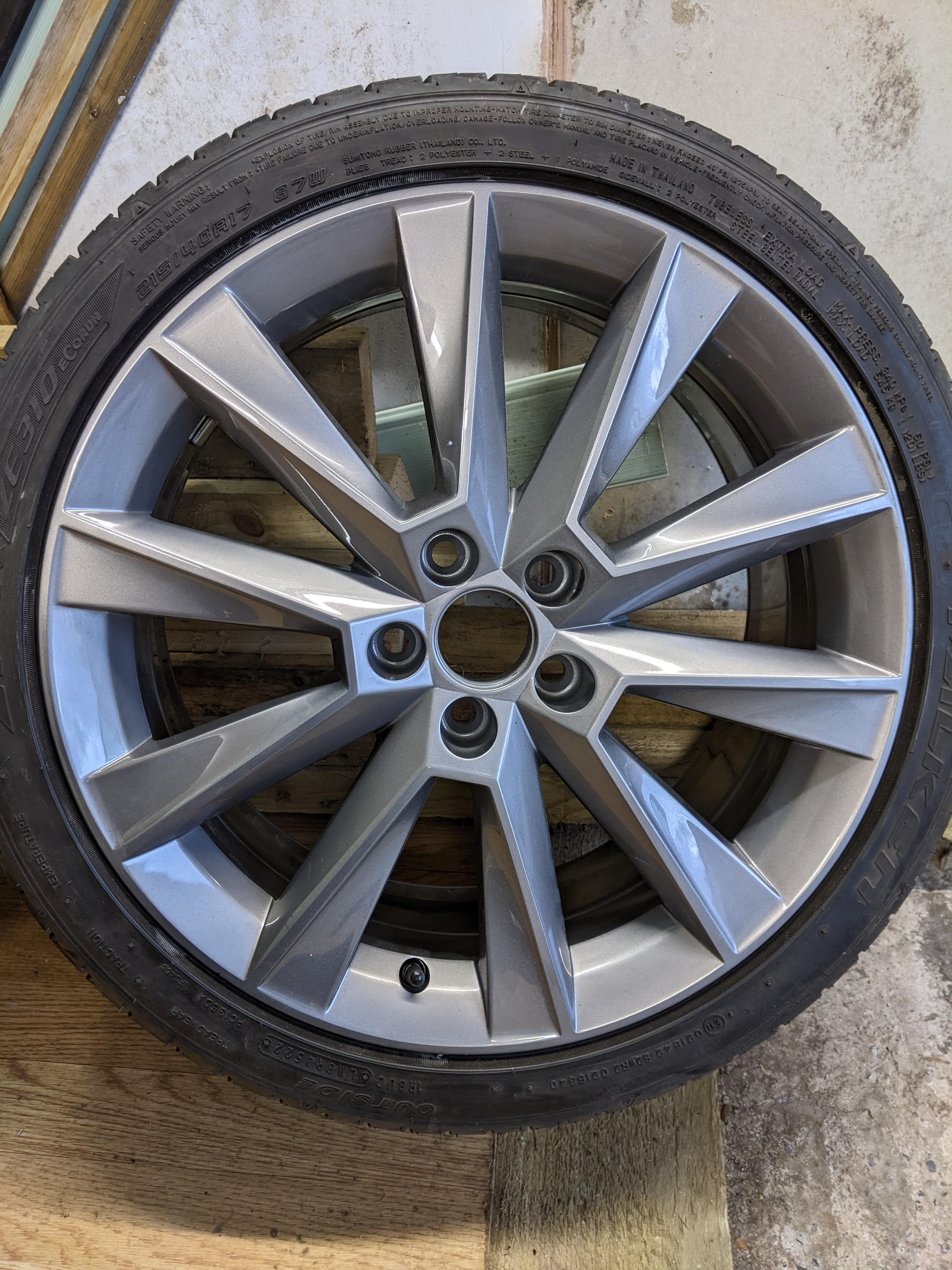

I have bought a set of 15" (Octavia) alloys for winter tyres:

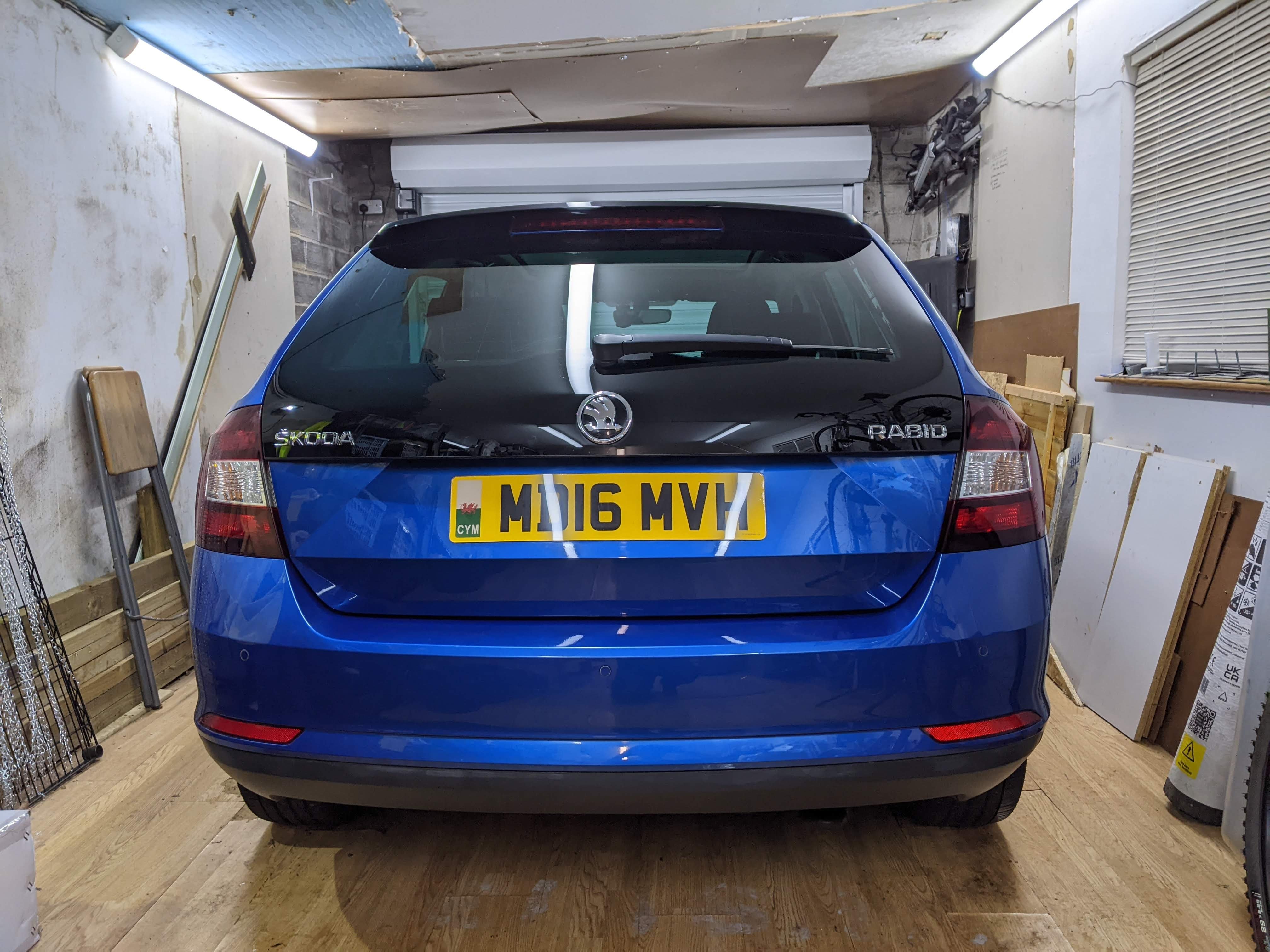

Had a day off today and it wasn't raining for once, so it got a full wash/clay/polish/wax today. Still comes up well for an 8.5 year old car, but it has certainly picked up some scratches especially around the boot from day-to-day use and tip runs. The wheels could do with a refurb now; I might get them done once I've swapped to the winters later in the year.

Had the wheels refurbed (in Audi Titanium):

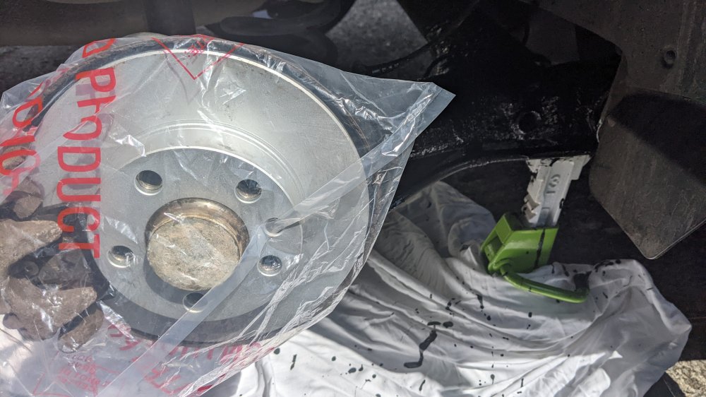

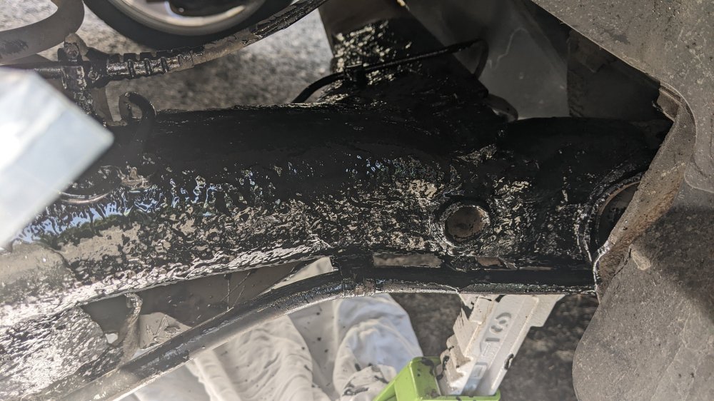

Having done the front brakes at Christmas, the rears needed some attention recently, especially the passenger side where the disc was quite lipped and in a bit of a state - I think the caliper/handbrake might have been sticking at some point. So new discs and pads both sides, and a new caliper on the passenger side.
The car is coming up 10 years old either June or July, so no surprise to see the rear subframe was getting quite crusty, so while the wheels were off, I scraped off the worst of the crust, wire brushed what I could, sprayed it all down with brake cleaner and brushed lashings of hammerite on, should help it last a bit longer )
