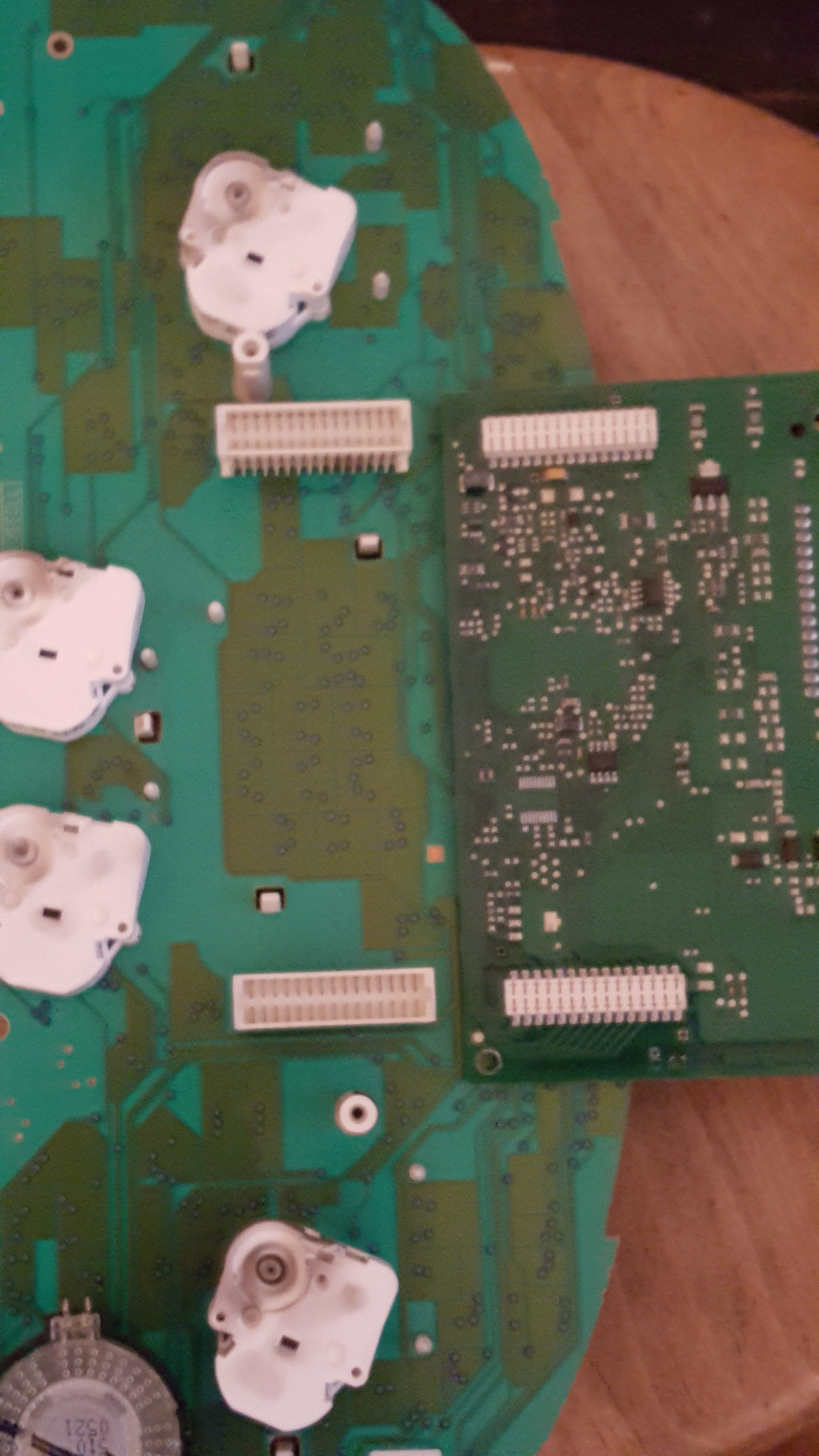

Your 2007 cluster has two PCBs that have two plugs that join the the PCBs together.
The rear smaller PCB is where your immobilser is located, so if the front PCB (dials) is total dead then you should check that they still are pushed together.

pic shows a golf cluster but the skoda one has the same set up
boards just push together
oh right I thought you meant the plugs at the back of the instrument cluster not the boards themselves
