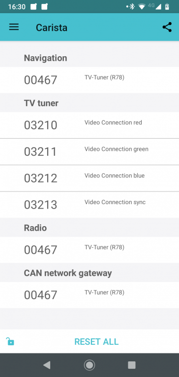

Fault codes any idea
Keep getting fault codes for TV tuner any idea why

The fault codes you see are clearly a video connection lead (rgb+s) so i suspect someone has had the columbus or tb module out and not refitted firmly.
that would also explain your other issues.
That makes sense I'll look into removing head unit and tuner and see if anythings a miss
