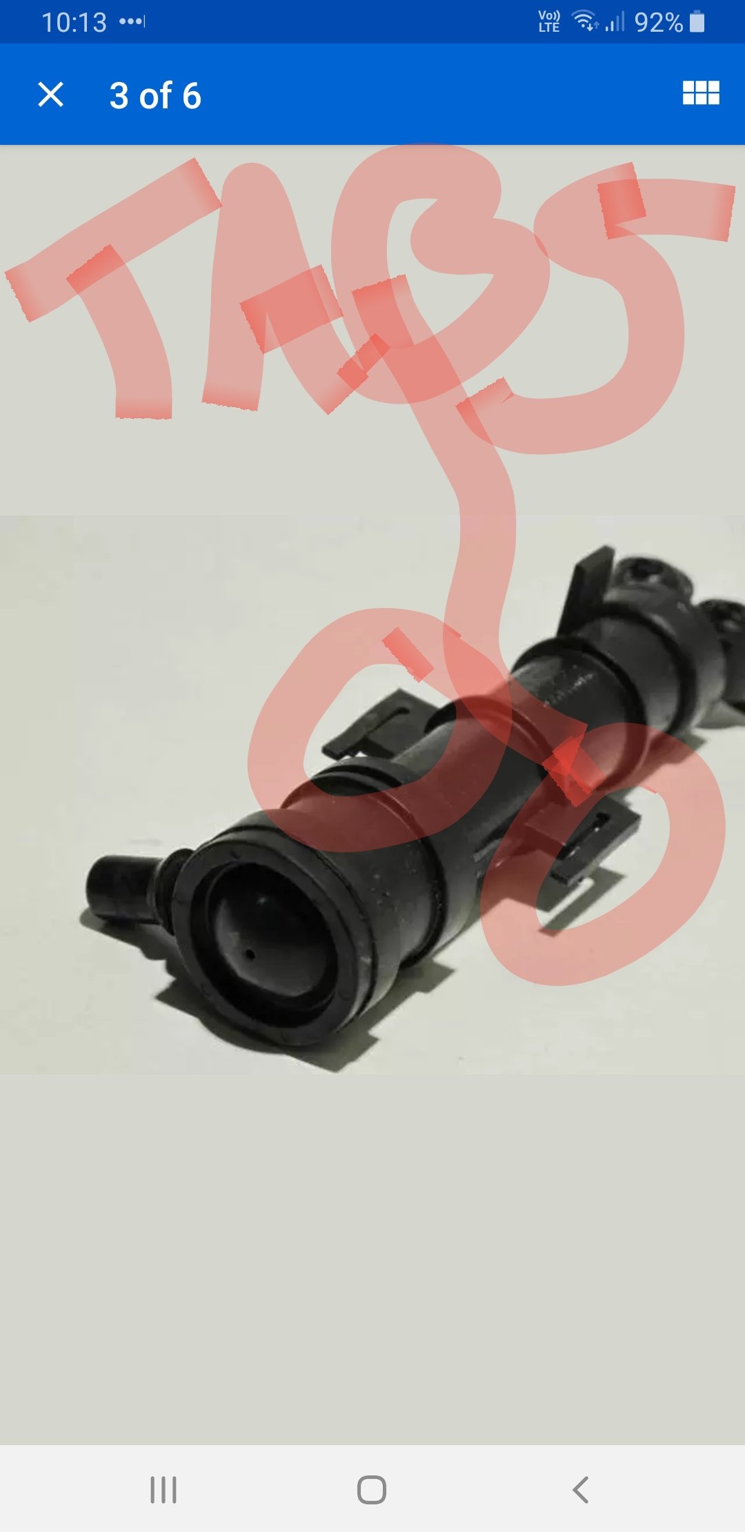

I don't know if they changed the part ever but I have replaced these on both sides last year on a 2011.
To remove them the passenger side is more of a pain to get to.
I'm going from memory so forgive me. Remove the airbox and associated pipe that sits in just behind the grill. Then you can get to them. The cylinders have 2 plastic tabs that clip it into a plastic housing. You need to lift both the plastic tabs at the same time and the you can pull the washer cylinder out towards the engine bay. I used plastic pry tools and watch sized screw drivers to keep the tab wedged up on one side while I could release the other. Once released from the housing, you'll need to manipulate the cylinder washer head through the housing by moving it on an angle as it's too wide to get through the hole in the housing.
The cylinder is connected to the washer pipe and secured with a blue plastic tab which you just lift up and off. Then just pull off the pipe.
If you have a feel on the drivers side there is more room to feel and see what I'm on about.
On a 2011 this part fitted mine.
Part number 5L0955965B
