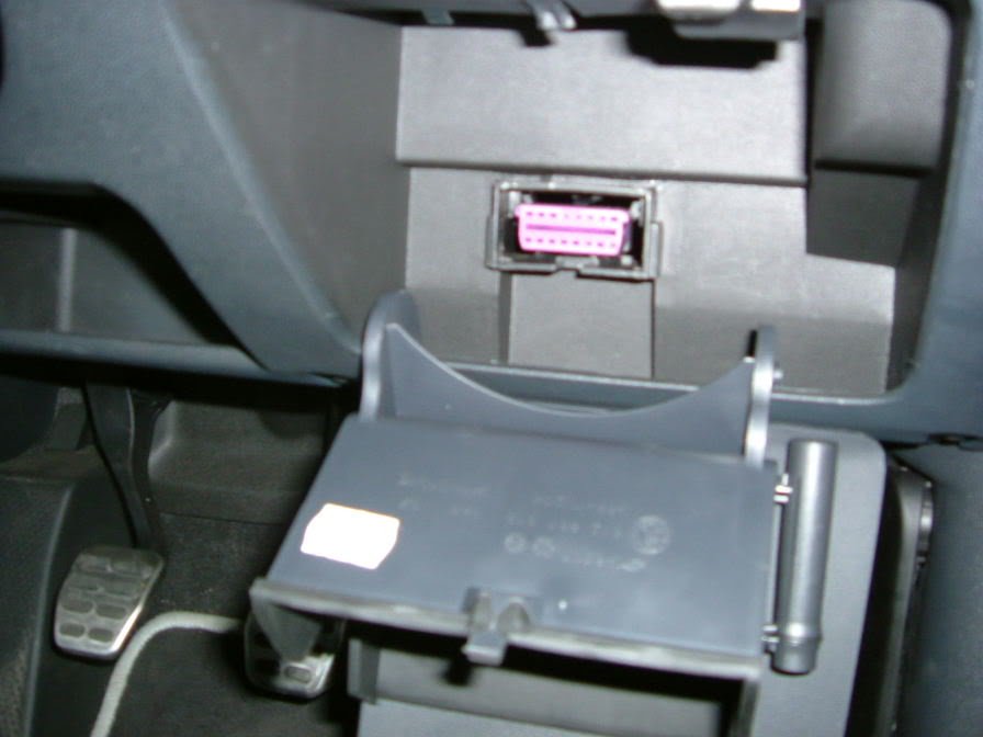

Pull hard on the cubby door right of steering wheel and you'll  find the diagnostic connector.

Pull harder. It won't break.

You open it, then you pull it harder, it opens further!
Pull the lid until it goes past the usual stop and hangs down.

Of course it's in there, pull it hard enough for it to come right out and hang down to the floor.
