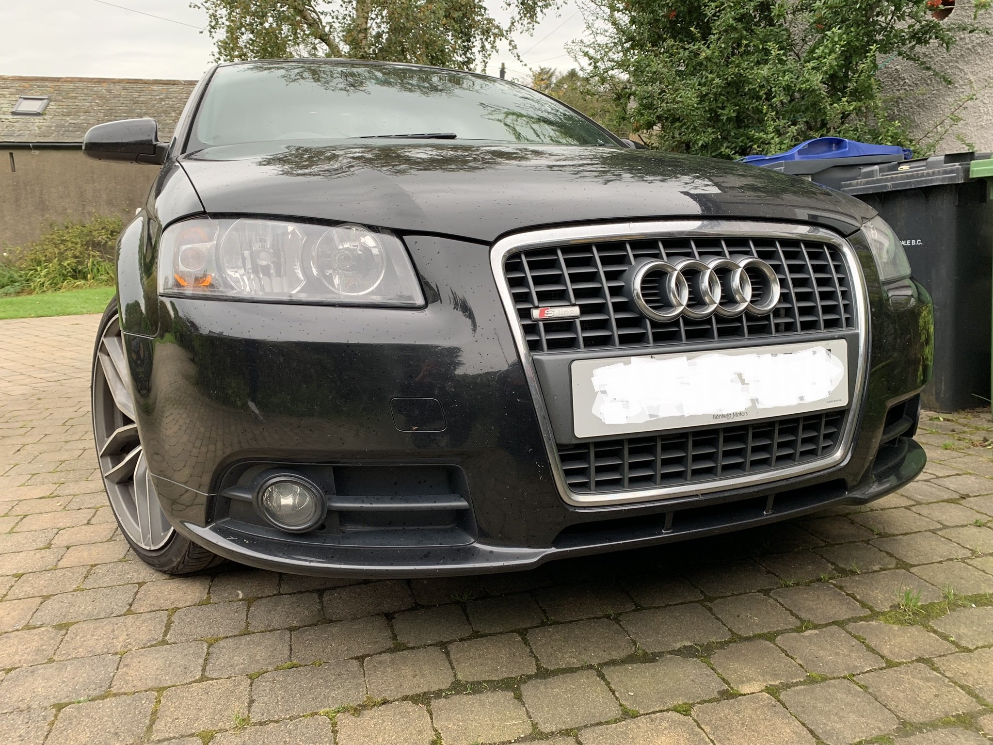

hey all , recently acquired an Audi A3 quattro , with the BWA engine, same as the octy II vRS .... I have a few questions if you would indulge me :)
firstly its a bit rattly on start up from cold.... this quickly quiets down, and doesn't do it from a warm start... i assume this is the oil pressure building in the cam chain tensioner, until pressure has built and  it tightens everything up... only lasts a few seconds, (had a recent oil change by audi tech) is this normal ? ( it used to be normal in my old 1.4 twin charger in my fabia vRS and nothing to worry about) just wondering if I have a problem and need to get things changed to pre-empt damage... ideas/experiances? (tia)
secondly , I have no idea if the cam follower has ever been changed, car is on 97,000 miles, and running perfectly , just been MOTd with no issues, no error codes ect .... how often do you guys change your cam followers, if at all ? some people say every 40k , some every 10k! VAG obviously say its not a consumable part lol... even though they made a harder cam for this engine after issues! 😮
Thanks for any replies, just looking to do preventative medicine if it needs it :)
