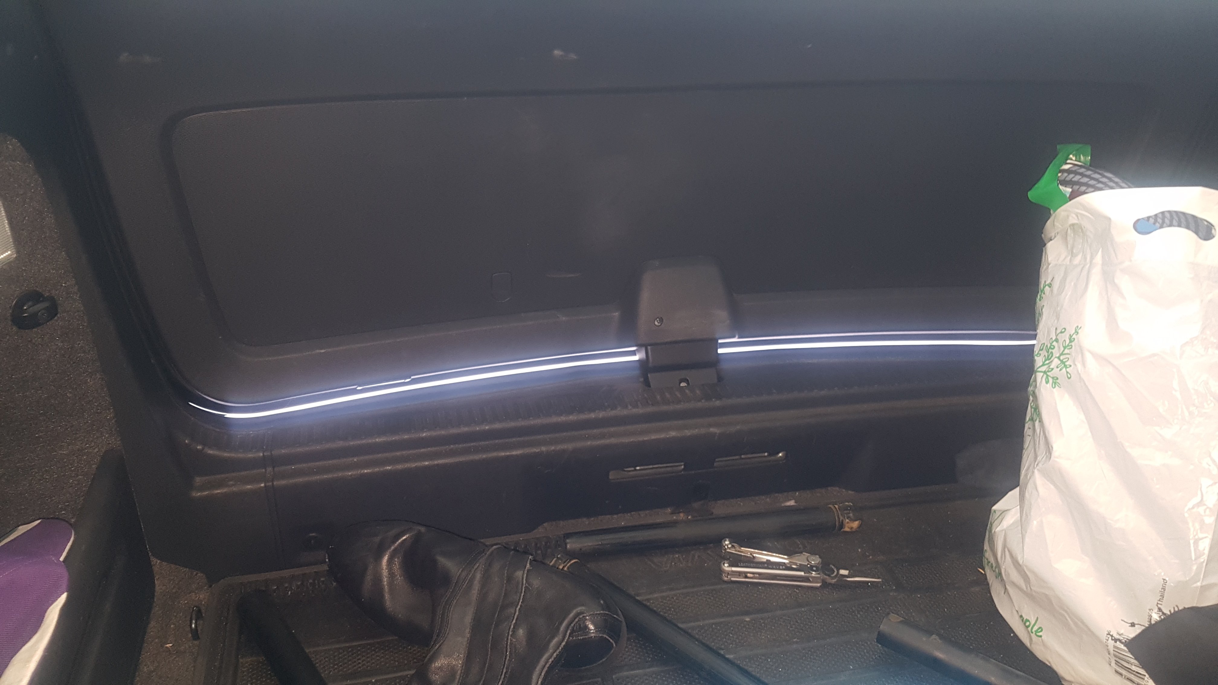

Sorry andreas... Can you explain what you did to allow it to fully close? Mine is currently doing as per the photo post changing to gas.

Hi Gilliehead,
If you study the striker plate (the part in the chassi), there is a metal rod that the bootlid locks on to. If you press it, you should be able to push it down with your thumb, and it should spring back when you lift the thumb.
The car normally pulls this down after the electric motors have registered that they have pulled all the way down. This doesn't happen either because the motors aren't running, or the sensor cables are broken.
To lock the metal rod in locked position, you need to remove the cover to access the striker plate. After this is removed, you should be able to remove the striker plate. Now you can manually pull the metal rod down. Find a 12V source (e.g. a car battery) and apply to the two pins for positive and ground. You may have to try around to find which are which.
After the metal rod is pulled all the way back, reinstall the striker plate without pluging it back in. That should be it
