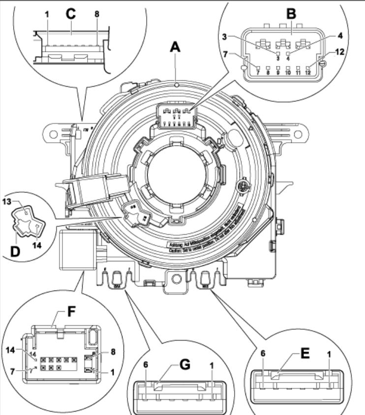

I have bought a clock spring 5q0 953569B (version c now supercedes b, so c should be fine also) which has the connector for heated wheel (see connector 'd' in diagram below)
The primary connector on the new heated version clockspring uses a 14pin connector (5q0 972 726) where the non-heated used a 16 pin connector.

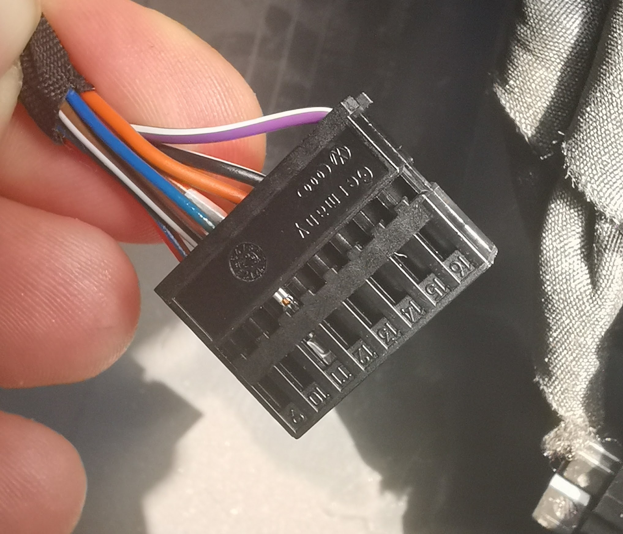

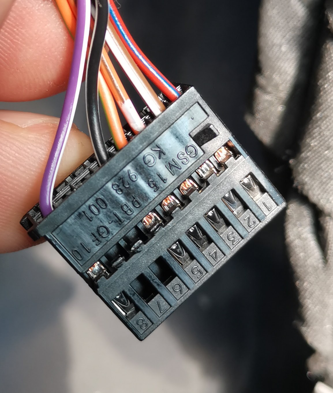

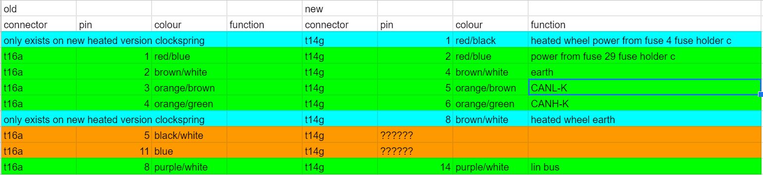

I've managed to review all the pinouts from wiring diagrams, see my translation table below - however I have a problem in that my original 16 pin connector seems to have 2x wires that I don't see described in the wiring diagrams. black/white in pin 5 and blue in pin 11. I'll need to figure out what they're for before I can complete the fitting.

just to confirm I've identified and correctly placed the final 2x missing wires, the black/white currently in t16a pin 5 goes to pin 7 on the new 14pin connector, and the blue/purple which is originally on t16a pin 11 goes to pin 14 on the new 14pin connector (for automatic/dsg to sense if the lever is in 'Park')
all that's left to complete the heated wheel retrofit now is to run 1mm red/black cable for live  from t14 pin 1 to 10a fuse number 4 on holder c, and follow the brown white earth from pin 4 on t14g to find where it turns from 0.5mm into brown and black 1.0mm cable - this is where I should join my new 1.0mm brown and white earth from t14 pin 8
