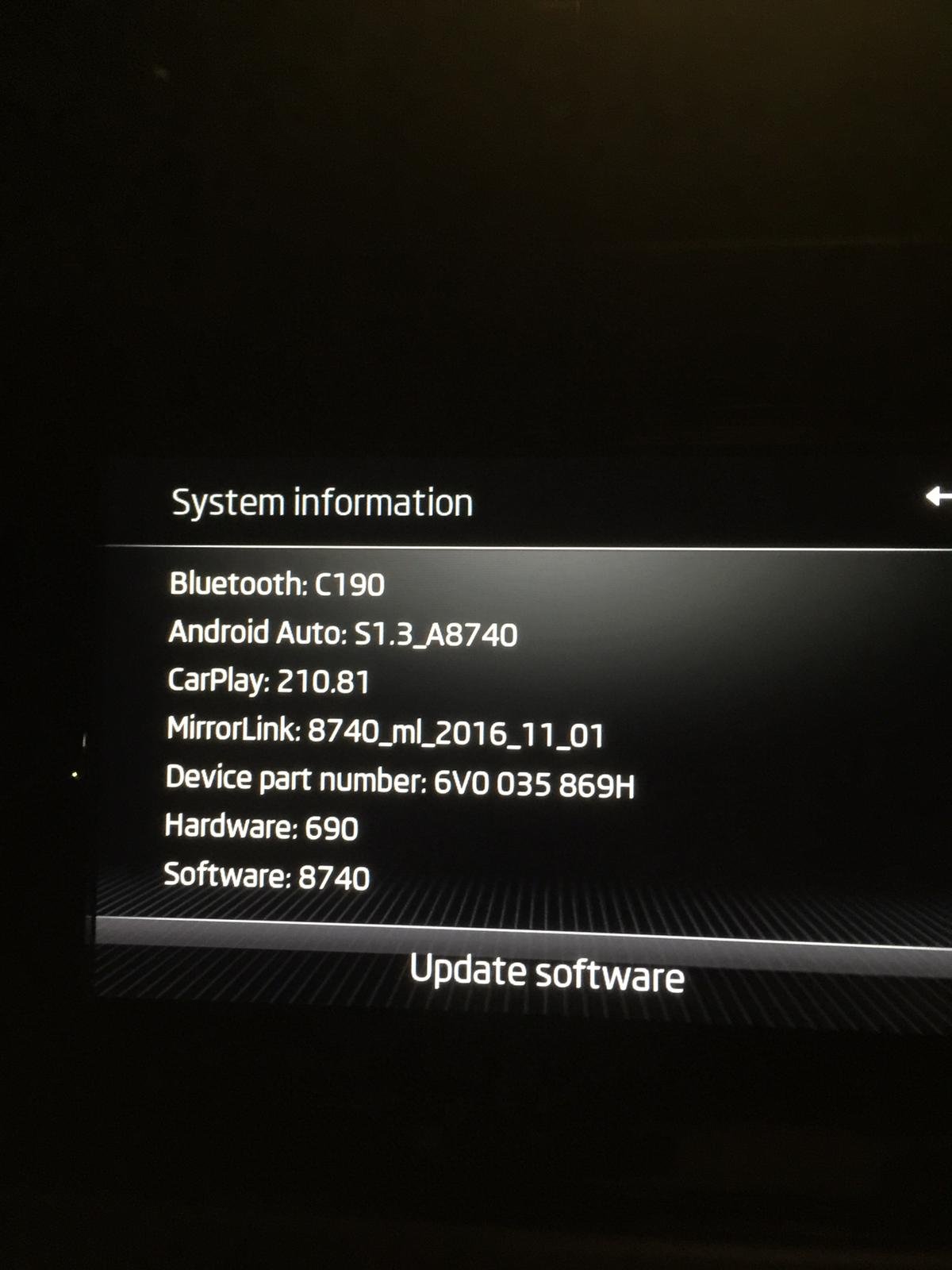

Get a screen shot of the model and software version. There is a thread on getting updated software called “ I need Bolero update”.

Software is the same on my car which works, but then doesn't on his.
They are saying his mpi colour doesn't have Apple play however as the screen shot of his software shows it does.

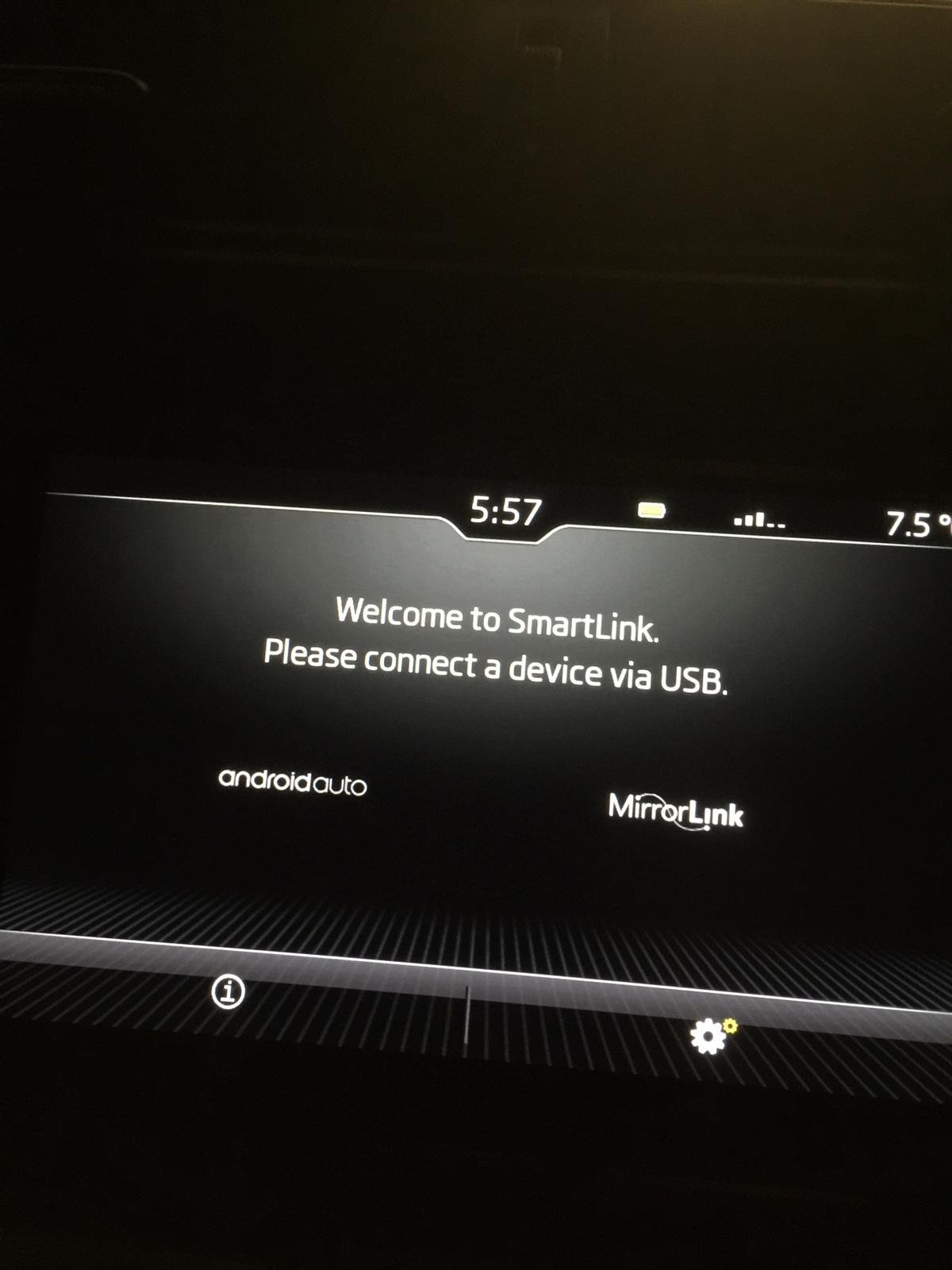

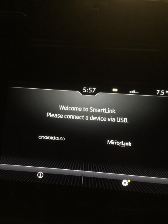

Screen shot below comes up when phone is plugged in and you select app on the right hand side
Thanks
A
The Apple Carplay logo is not showing, it is missing! Software fault?
Mirrorlink is NOT the logo you need.

Pls show three SmartLink startup screen:
- with no phone connected
- with Android phone connected
- with iPhone connected
Thanks @pab567

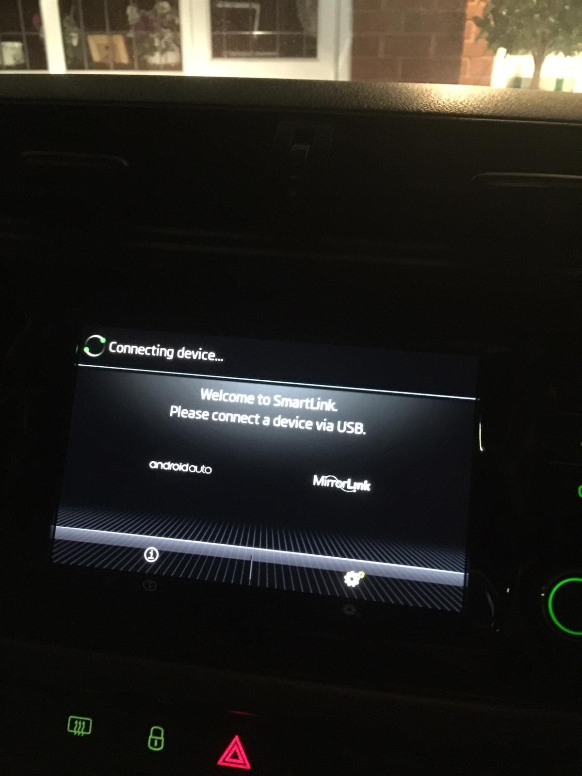

I wont get back to the car tomorrow however i can confirm
- no phone - shows android auto and mirror link (no sign of apple)
- Android - will try tomorrow
- Iphone - is the picture above with android auto & mirror link with the text at the top saying connecting
Thanks
A
If you have VCDS (or any other diagnostic tool, e.g. VCD, ODIS, OBD Eleven) then in 5F find adaptation channel with word "Apple", (typically: "ENG109862-ENG130249-Vehicle_configuration-Apple_DIO") and change it to "ON". This should make CarPlay visible in SmartLink start screen. If there is a license for CarPlay installed and you have USB that supports CarPlay then it should solve your problem.
