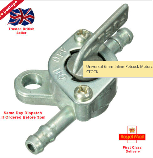

My throttle body was damaged and having replaced it I had a theory that it was the jamming that put on the CEL. Tried it with a dismantled throttle body the motor turned and the light came on. I tried blocking the EGR| at the manifold 3 days and the light was on so that didn't work. I am thinking of adding a fuel cut off valve to the vacuum pipe going to the EGR something like the one in the photo reduce the vacuum slightly. Does anyone know if this would make a difference?

If a vacuum controlled intake component puts the CEL on then generally it's a MAP sensor reading which signals the fault and you can't fake that so I doubt your fuel valve solution will have any effect.
