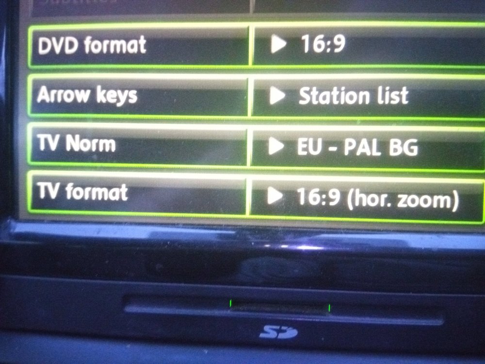

You can go into setup button then scroll down to
TV Norm and highlight the options across from it this will bring up alternative frequency's
Then scroll down to UK IRE PAL 1 or try other that look close😎
Mines was set to Italy as the guy before used it abroad a lot
