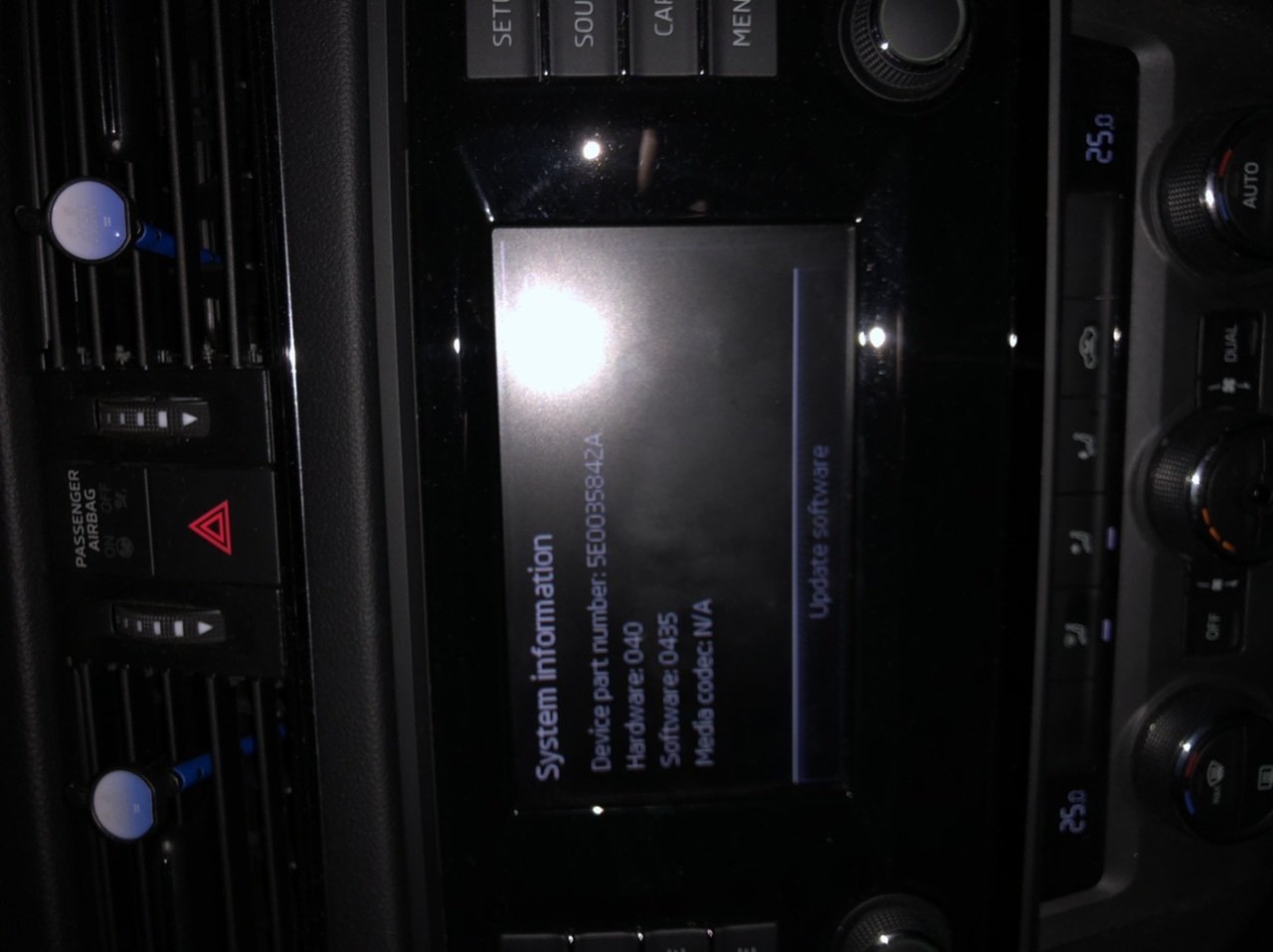

After looking through other threads i have come to the conclusion that I have a Bolero unit in my car with the 5.8” screen and i have read that it is possible to upgrade to the Newer style screens
I take it it’s not just as simple as popping out old unit and screen and replacing?
I’m looking for guidance as to what I need to buy and what Work I need done

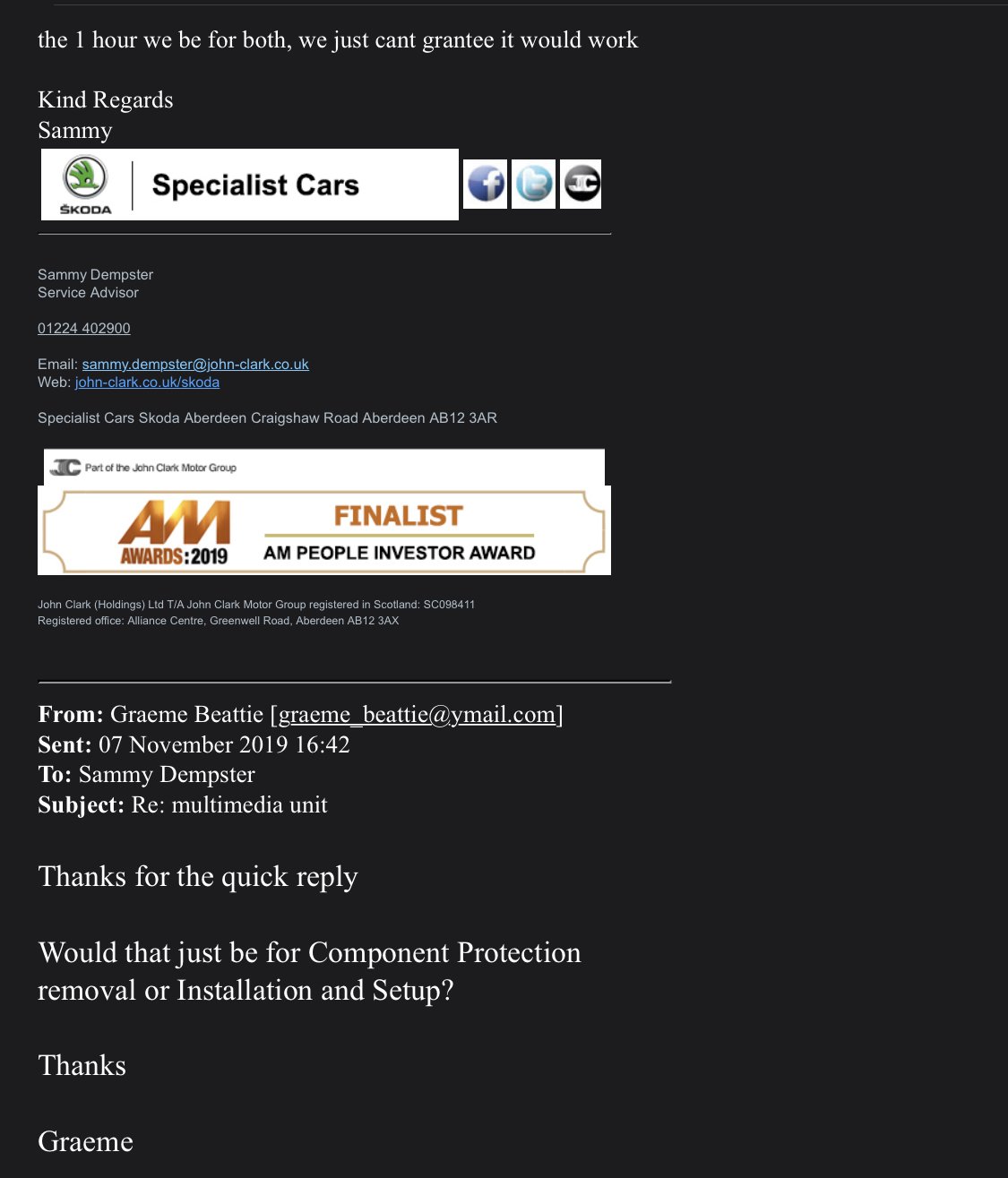

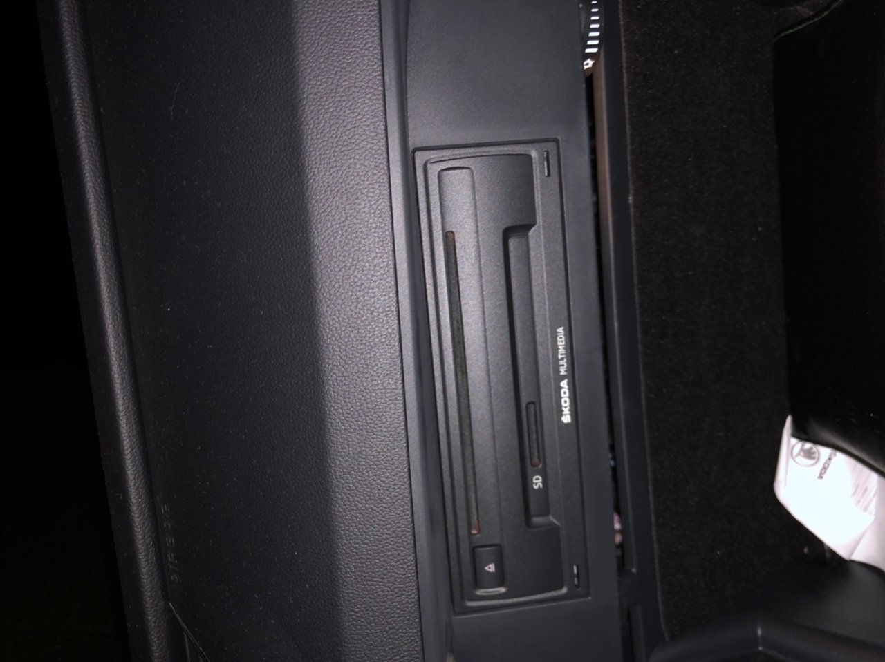

I emailed John Clark Skoda near me and explained that I wanted to upgrade my Infotainment setup in my car to MIB2 unit with Amundsen 8” screen that I’ve found from a breakers yard. And asked them if they would do CP removal and if they also do fitment. This was their reply
What’s your thoughts on this?
If it’s a 5Q0035874A Amundsen then CP removal is all the dealer needs to do, they won’t be able to make anything other than the radio, media player and phone work. The rest needs Pawel. If it’s a newer radio it may have to go to Pawel off the bat. What is the part number?
