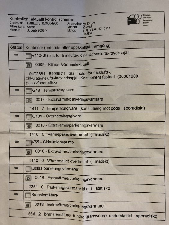

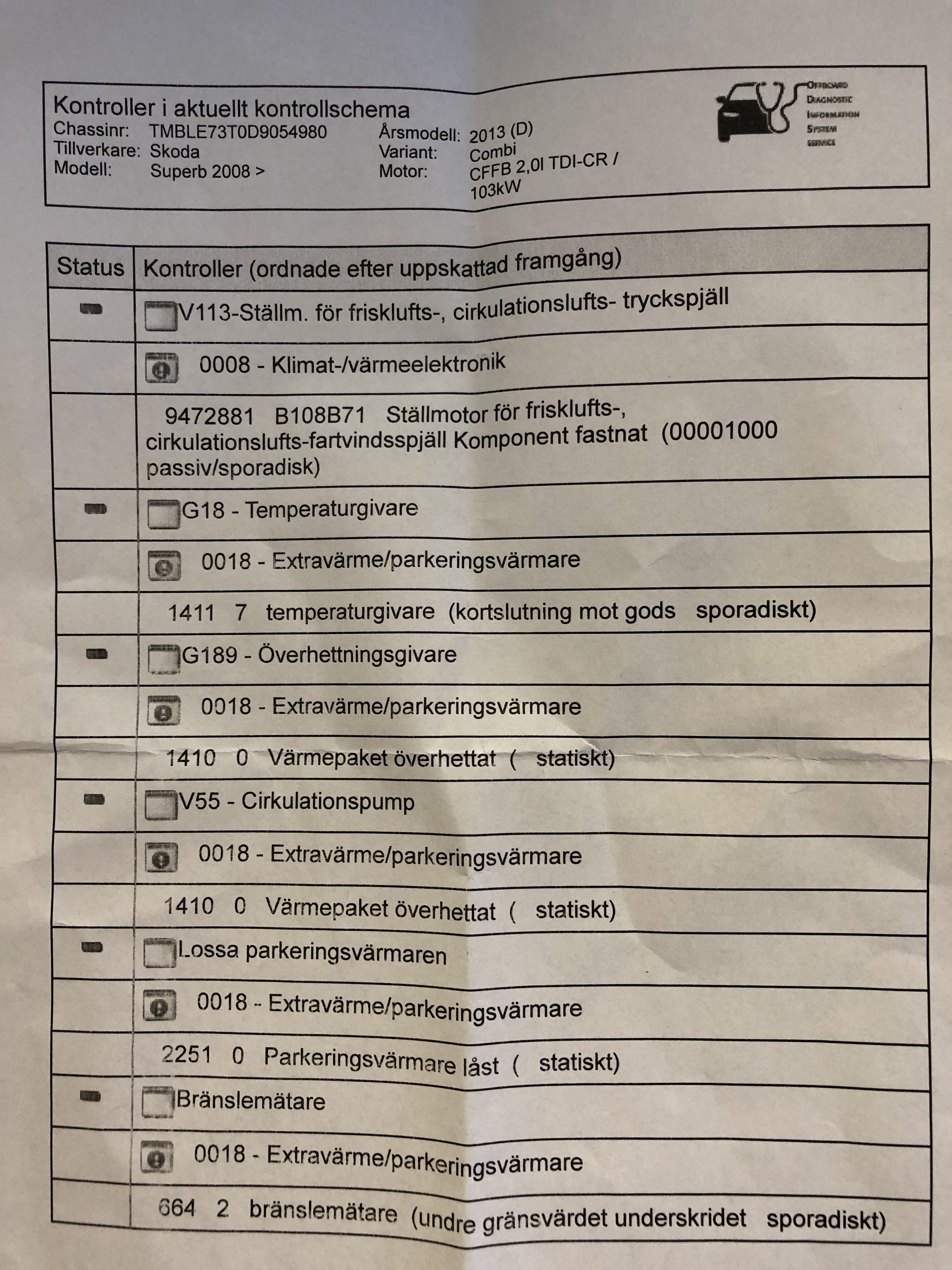

I read out the fault code today, see picture below.
It says in Swedish that the circulation pump is overheated, so most probably I need to change that one.
Most likely it will start if I disconnect/connect battery, but will probably fail after a while.
Planning to change the circulation pump myself.
