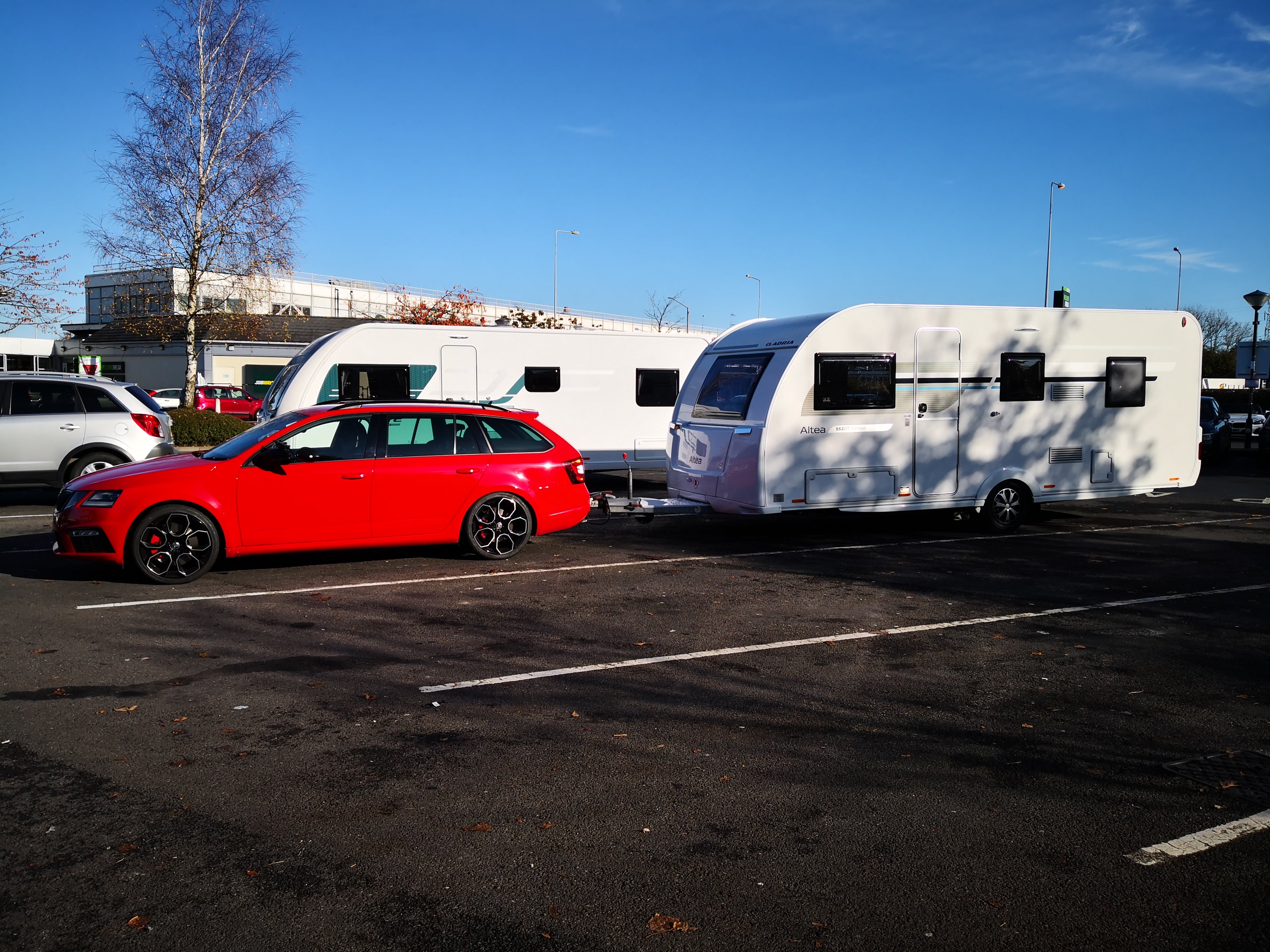

I have a detachable Westfalia on my 245 estate. Only recently fitted it and purchased a caravan.
Posted this photo in the 245 thread already... Going away next week!

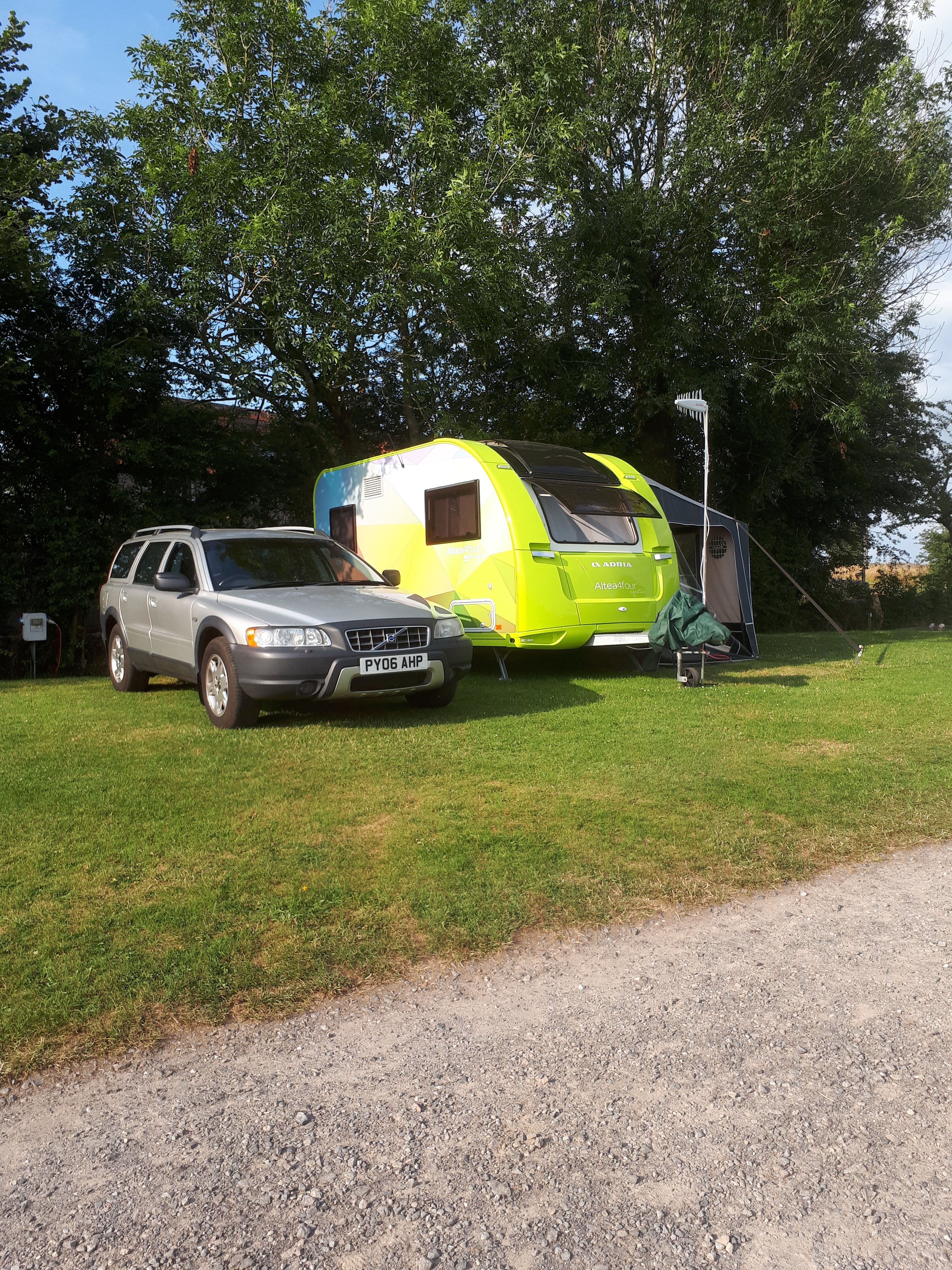

Hi Swirly 182, looks very smart, love the bright red, is it the metallic velvet one.
We have the Adria Altea four 4 in bright green with kaleidoscope sides, its a lot like marmite.

Wow! Never seen one of those before. Limited edition is it?

Hi swirly 182, yes it was a celebration of Adria being in uk for 50 yrs,one like it was on display at the caravan show in the nec, 2014, it could be bought in loads of colour combinations,  we chose  the same and had to wait 9 months for delivery.
Get some funny looks when towing tho.
Only 2 like this in uk, not available any more.

Ok, got you. The 3500kg rule makes sense for 17 to ~24 year olds? But it prevents me (34) from buying a Volvo V70 or similar and having a more stable and potentially safer tow car, unless I pass the trailer test. Having said that, recently I watched dash cam footage of a Nissan Patrol LWB rolling 3 times after snaking with a single axle caravan, not too dissimilar to mine. Obviously driving too fast and possible incorrect loading.
I had never towed anything before picking up the caravan (pictured) so I was apprehensive heading on to the motorway. But the Octavia felt more than stable and easily coped with the inclines at 55 to 60mph in 6th. Fuel economy on the other hand.............
Hi Swirly 182, I remember the first time towing an old Lunar caravan with our Octavia hatch , pulled it ok  but like you pretty apprehensive first trip to near Skipton, bit narrow section of road after leaving the m6 to Kirkby lonsdale,
