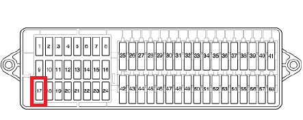

Is the numberplate light working? That shares the same fuse as the left tail light and side light, fuse 17:
Hi Wino, thank you for that - unfortunately, for me, that is not the problem - fuse 17 is intact
