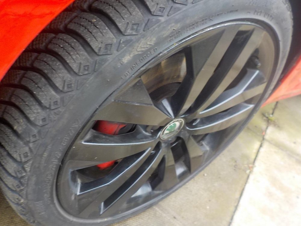

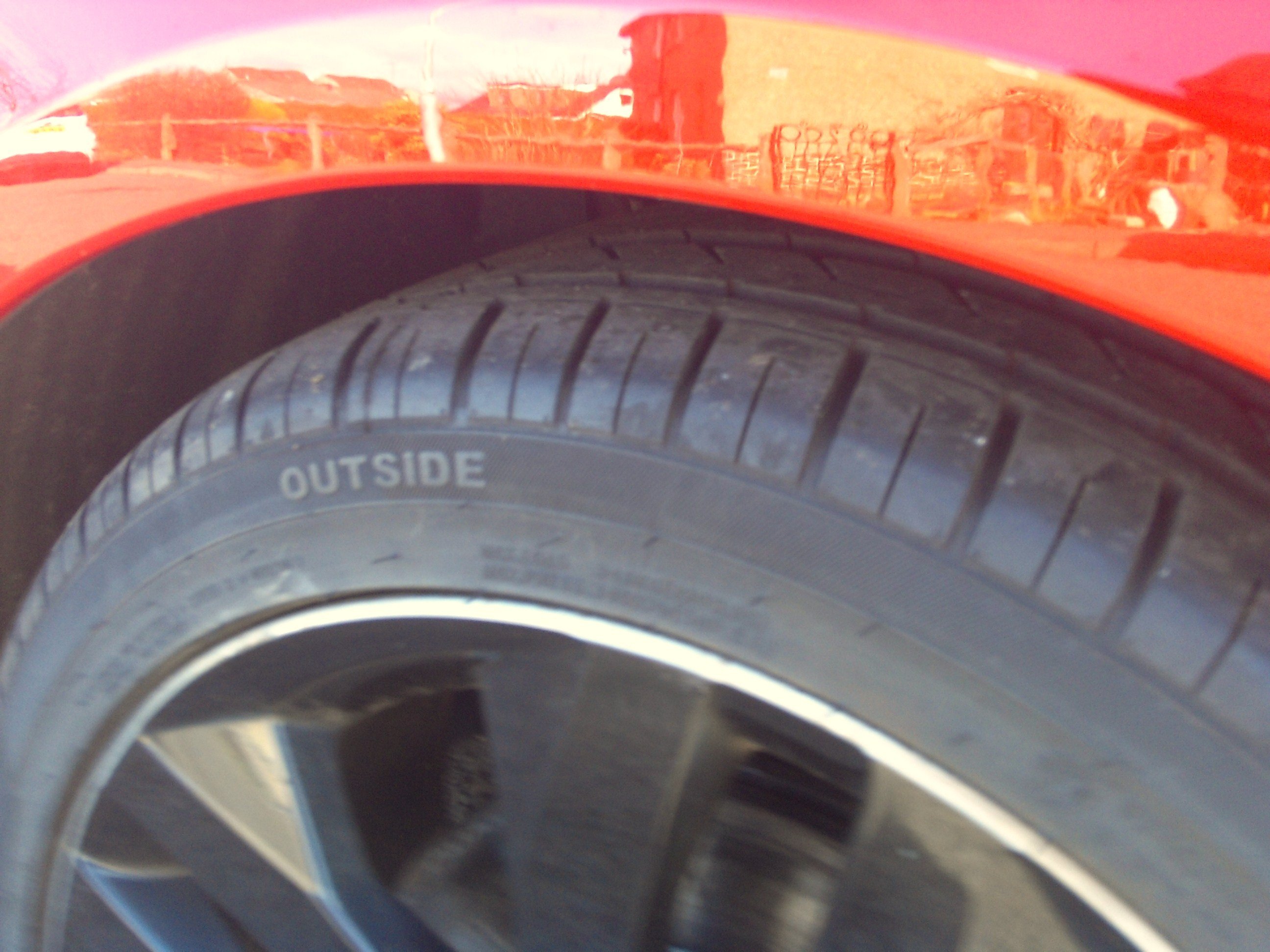

If tyres are XL (reinforced) sidewall makes a difference.
There are low profile tyre cars on models as OEM and some are not with XL's and some have Rim Protection and some do not.
Rim protection has never made any difference to comfort or ride in my experience, as the protection is at the tyre bead and rim.
@Carlston
Since you do not say i have asked a few times are you in the UK,
& what vehicles is it that you are fitting these tyres to with motor bike tyre levers or what sized rims?
I find the firmer bead and rim protector makes getting a bead on much easier but then its different from brand to brand, rim types & tyres compounds and tyre types. Some can be a battle, some a doddle.
Not many DIY fit tyres or break the bead off rims these days in the UK on Alloys on modern vehicles using tyre levers and bead breakers unless offroading or where the likes when tyre fitters or mobile tyre fitters are readily available.
Personally i have had the good the bad and the ugly as well as some totally crap tyres from Pirelli on the same cars, same suspension and the same roads and XL sidewalls and Rim Protectors are not an issue if the pressures are right and the cars suspension is,
and going narrow and taller sidewall does not improve crap suspension but can maybe please some, or disguise the issue a car has.
