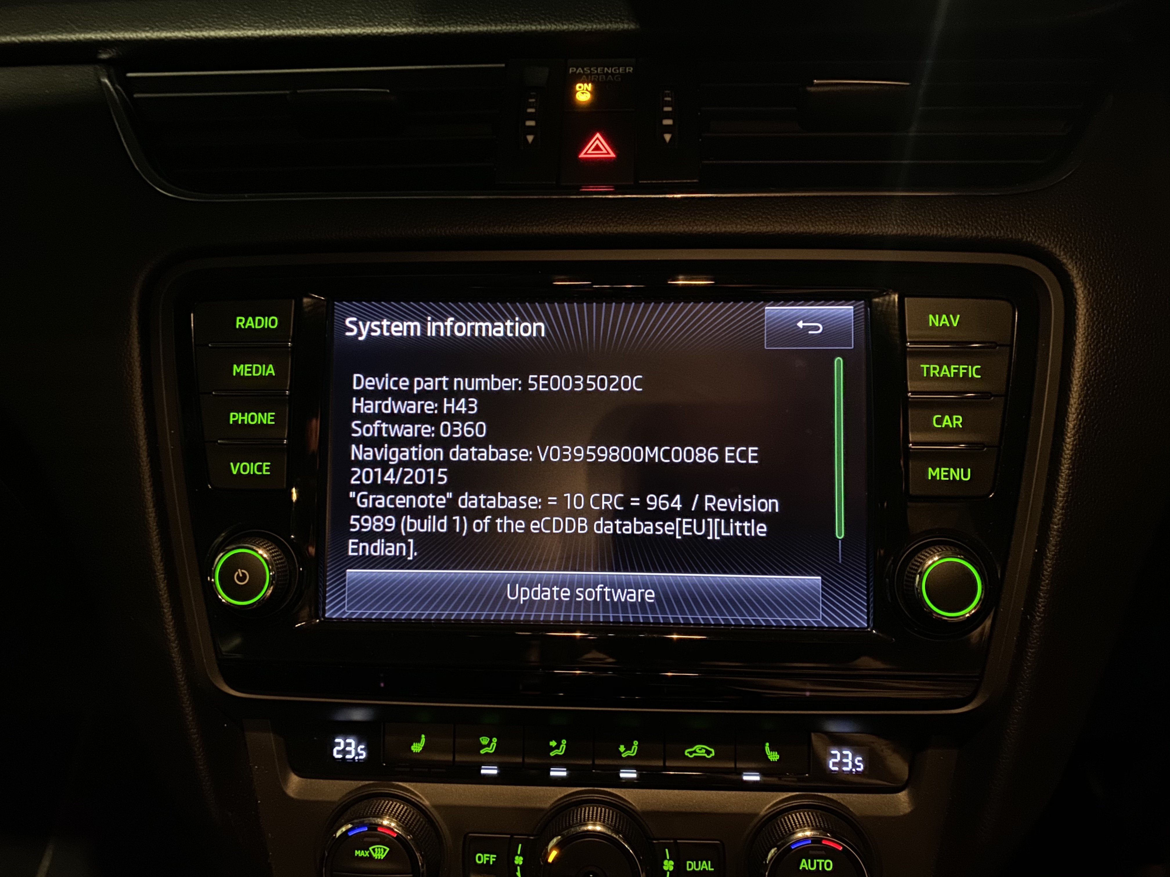

My Octavia is a 64 plate and I’d like to upgrade it to mib2.5.
can one of you please confirm what I have and what I’ll need?

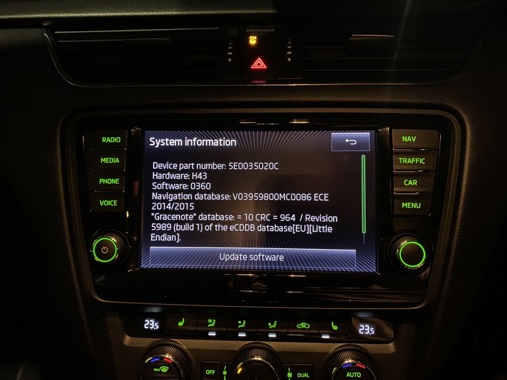

@System0fAClown you have Columbus MIB1. The questions are:
- do you want to move to Amundsen (e.g. lik ethe one you linked), Columbus MIB2 (both can work with your current screen or the screen you linked) or Columbus MIB2.5 (requires screen changed to 9.2" model number 5E0919606D)?
- do you have CANTON Sound System?
- do you plan to retrofit AID (Active Info Display aka Virtual cockpit) in the future?

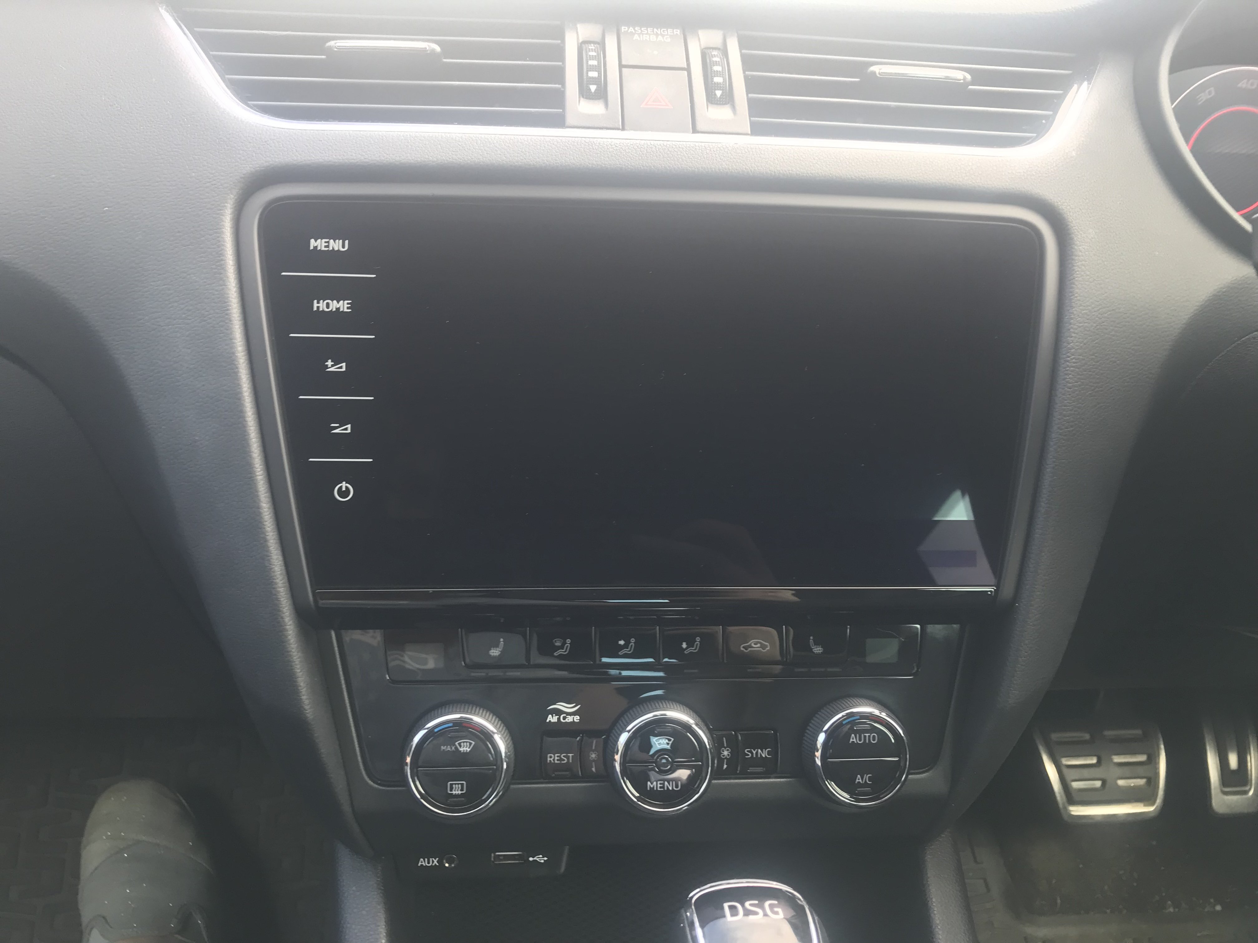

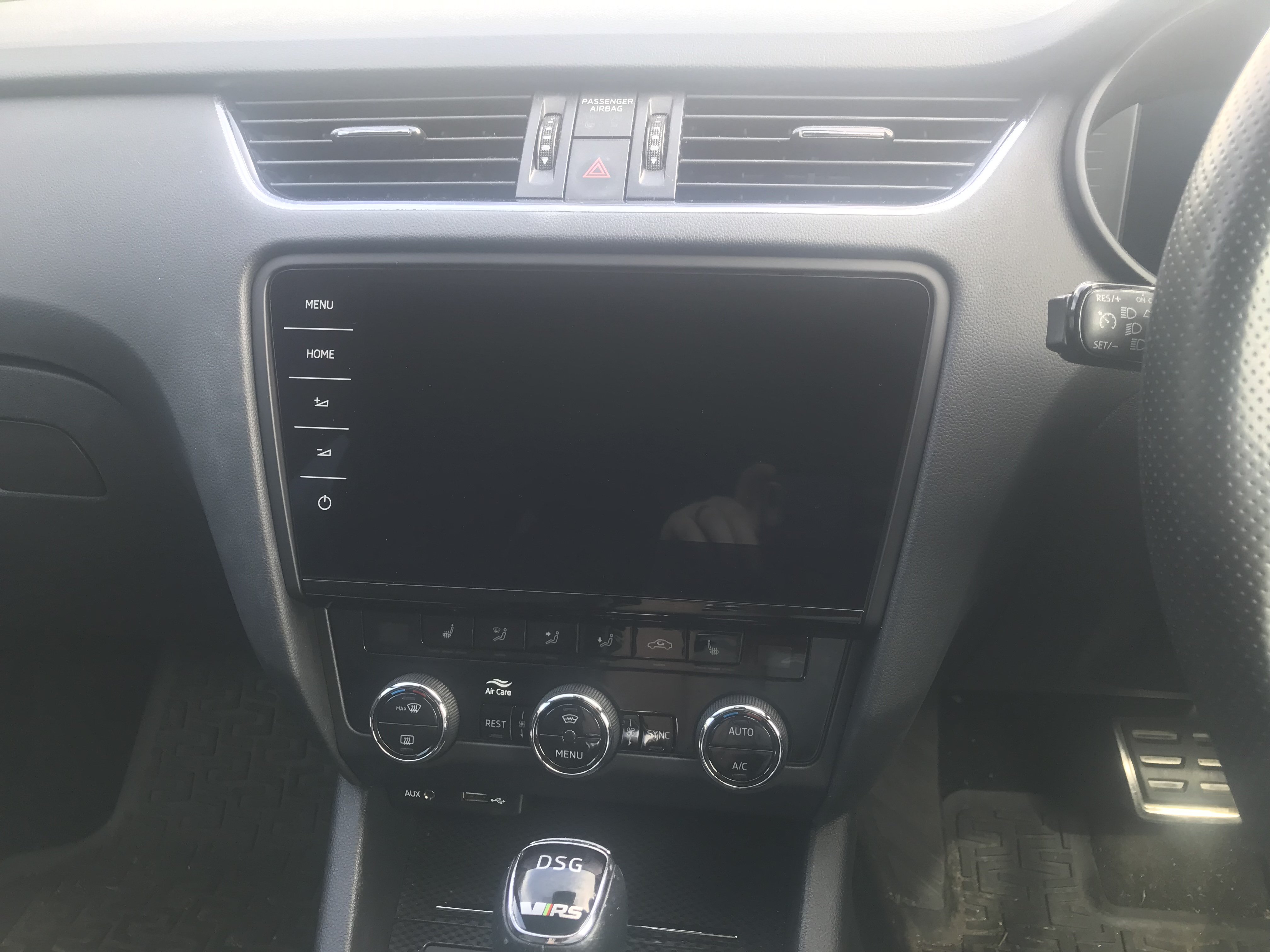

Would be nice to have seen some photos with the display active. Some display units can have defective lines.
The one I bought does (but I knew that before buying)
5 hours ago, pab567 said:
Question is if it is just CP removal or CP removal plus activations and what exactly activations are included...
I've just messaged him again about this, if not could i arrange for you to do it?
This seller has a few different ones up for sale and he does state if they have lines, this one looks OK.

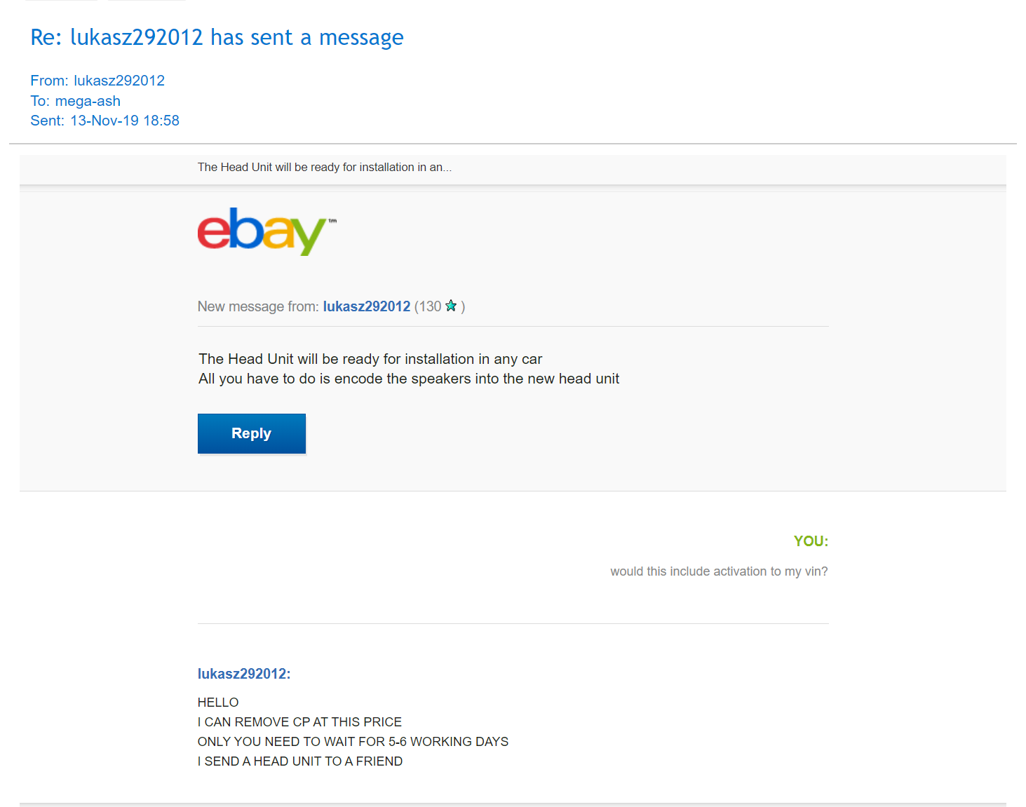

His reply.
If this is correct would i just need someone local that can do vsdc?
That doesn’t answer the question and is typical of many people who supply these units. ‘Everything’ usually just means nav and SmartLink rather than everything that is possible and I would want to see pictures of this. Also the coding to match your car is complex if you are new to it. Spend a little more and get a unit from Pawel. It will be 100% perfect and he is by far the most talented and transparent person in this field.

All you have to do is encode the speakers in to the new unit?
Encode the speakers?
Any idea what that Ebay advert meant Sasha? I can see a different head unit needing to be paired to the car, but having to tell the head unit about speakers?   Sounds weird.
Could well be meaning that you need to set the right speaker set up for the car, for example if the car has the Canton sub.

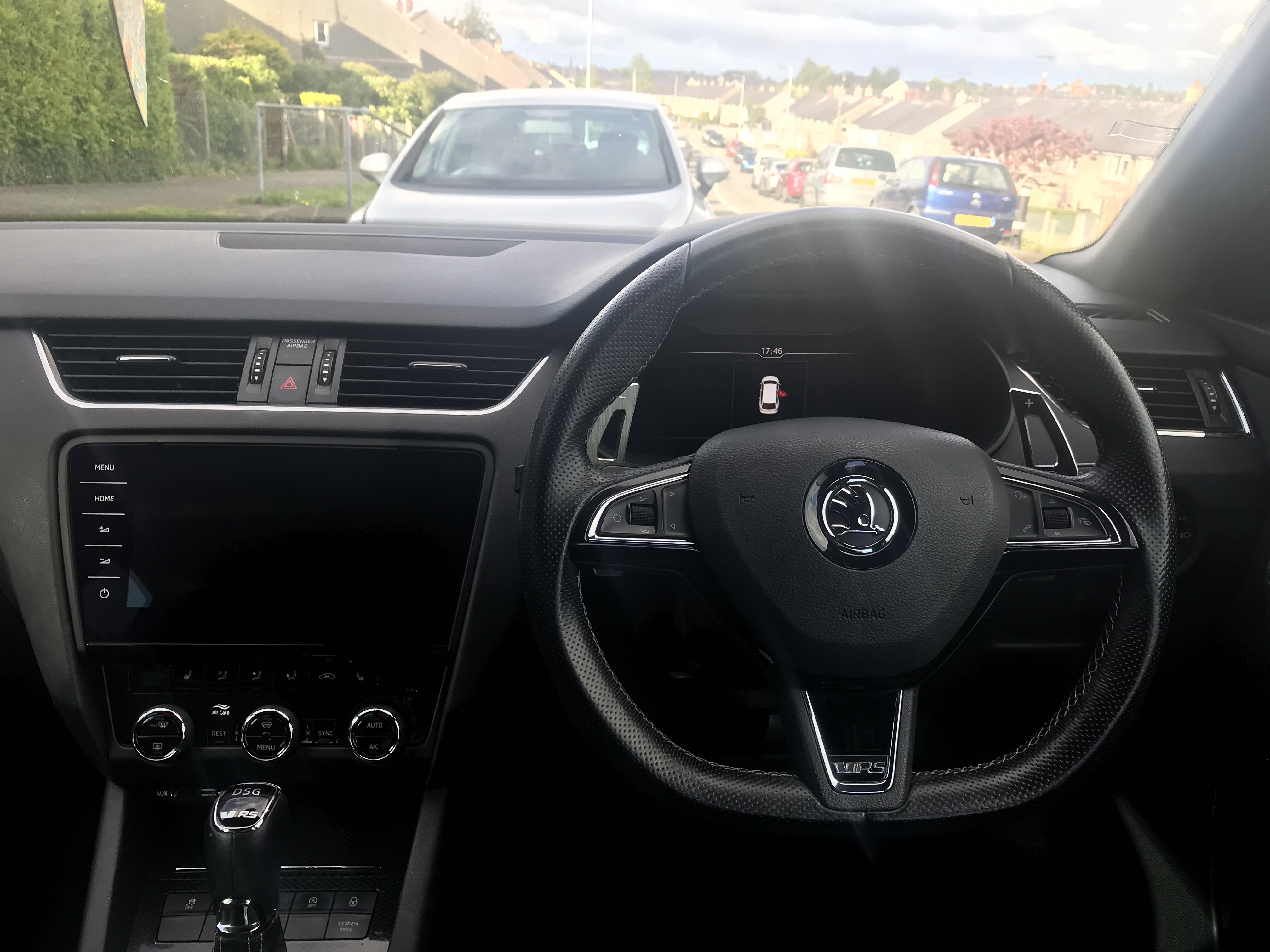

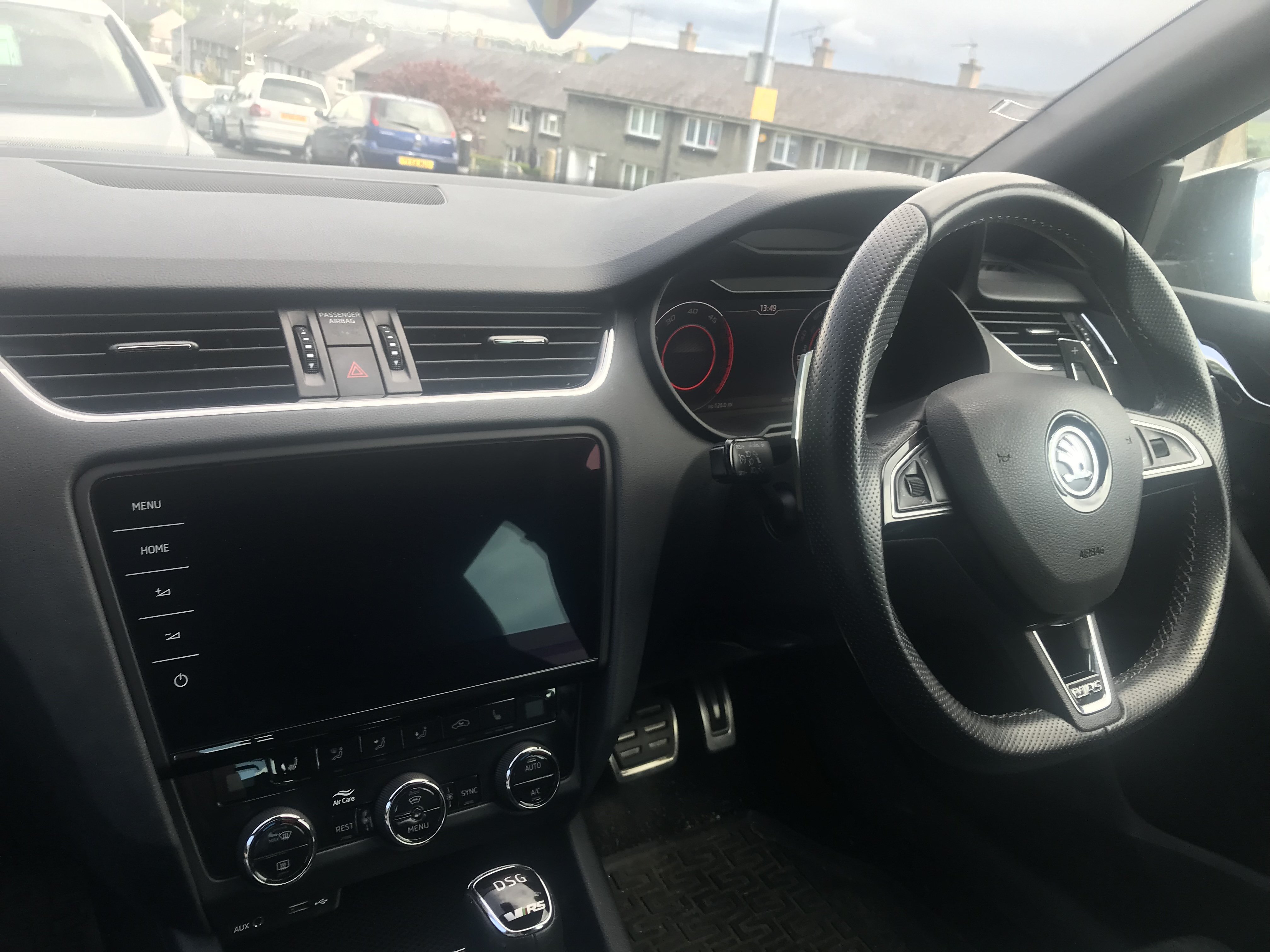

Just thought I’d update this to say really happy with this, can’t thank @pab567 enough!F0EFE51B-76D9-452A-8BED-8DF1385DB663.thumb.jpeg.2edacdcffd155c9272d3fbbcfefaea9c.jpegWorth every penny.
My pleasure :)
