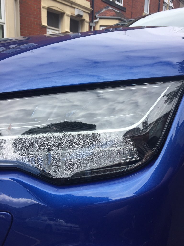

Just think what Audi owners with the same lights are thinking :)

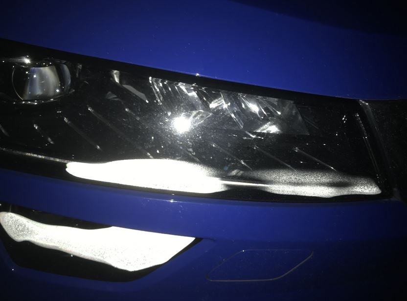

Had the Karoq for 3 days not been washed etc it has been stood out in the rain but after and hour drive last night this morning this!
Wouldn`t call that misting.

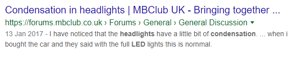

SEAT...
BMW...
Audi...
Mercedes-Benz...
Even the manufacturer says it is normal...
Edited by silver1011

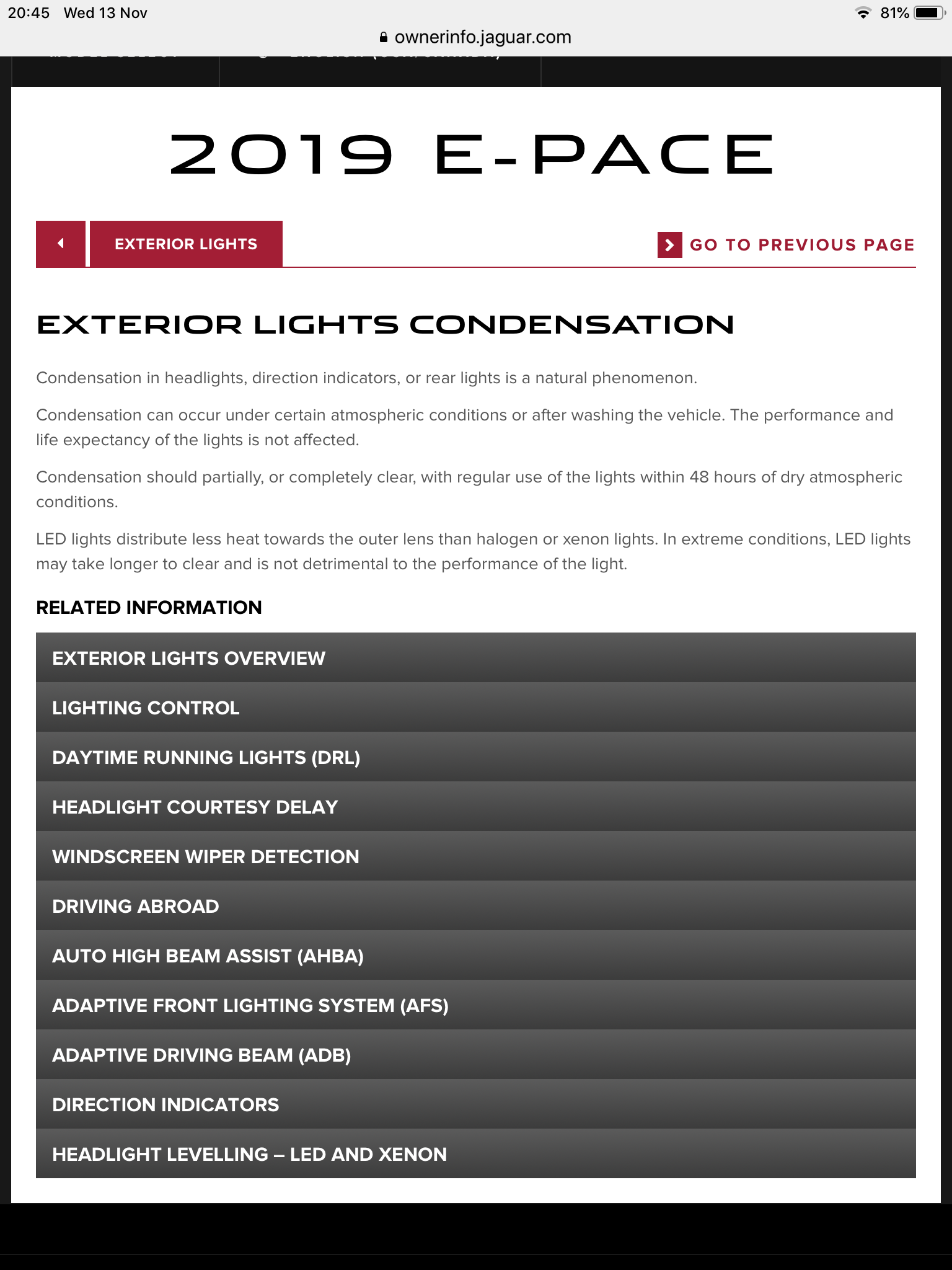

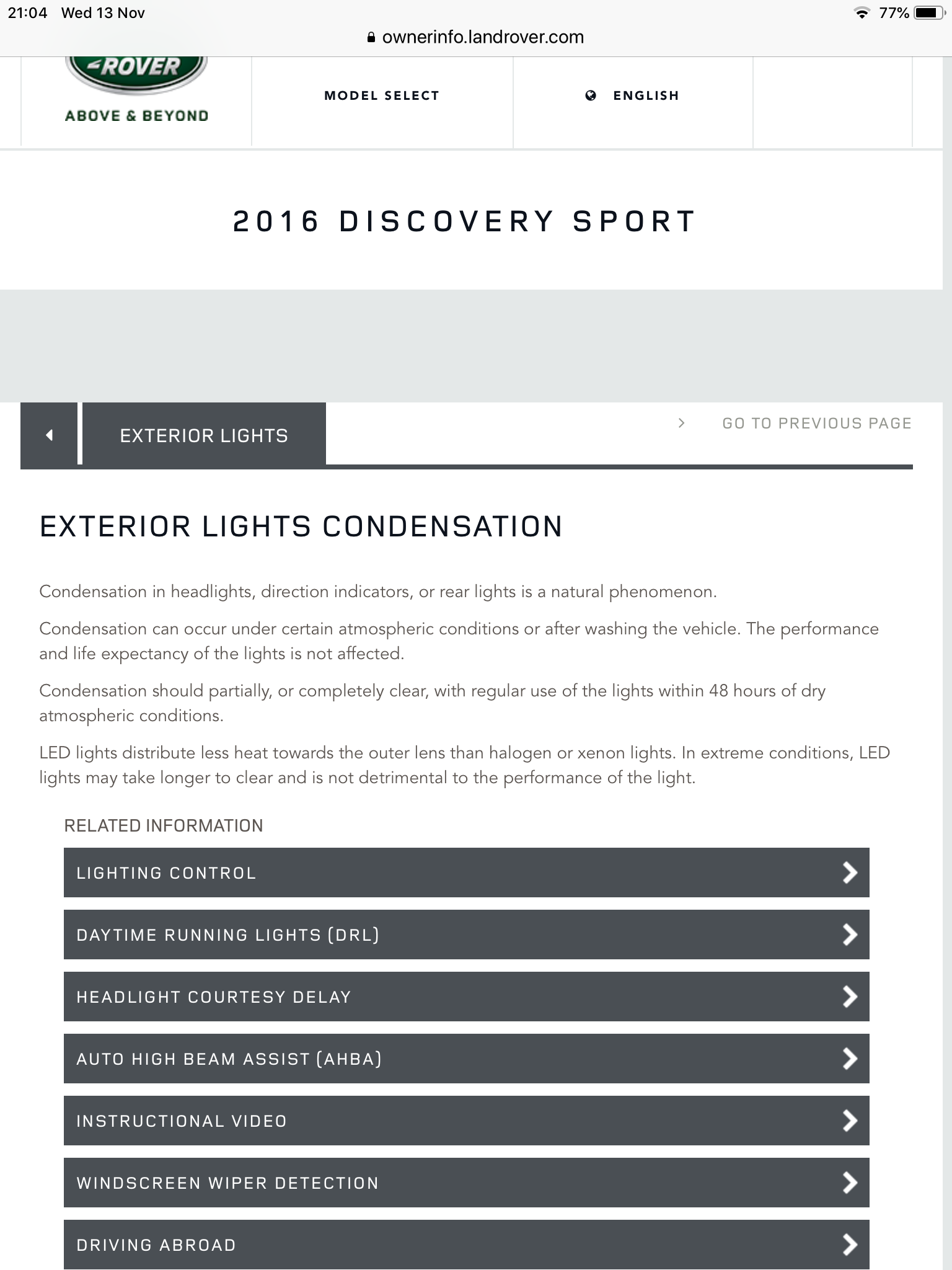

Interestingly my brother in-law has just been round he is a Development Engineer for Jaguar Land Rover and it is part of his job to sort out faults with vehicles when customer complaints come in and he says  that misting of LED headlights just doesn`t happen certainly not in his experience like he said when the lense is misted it is masking the light beam reducing efficiency and lights should not be designed to do that he looked at my Karoq and said you need to take it back and complain!
He obviously doesn’t know his products then :)
Edited by Kenny R
Given that the Range Rover and Discovery Sport have just been declared the least reliable cars on sale in the UK, I'm guessing a small amount of condensation in the headlights of the cars he is developing is the least of his worries 🤣
And they're a lot more expensive than your Skoda!
All I know is he reckons its not been an issue that has warranted any action to deal with the problem and his E Pace is OK as is his daughters Evoque - he does have some interesting stories though  for example apparently the Chinese don`t accept the warranty period on a new Land Rovers and when a customers Range Rover broke down out of warranty he towed it with a team of donkeys to a new motor show and parked it outside claiming it was defective and should be fixed.

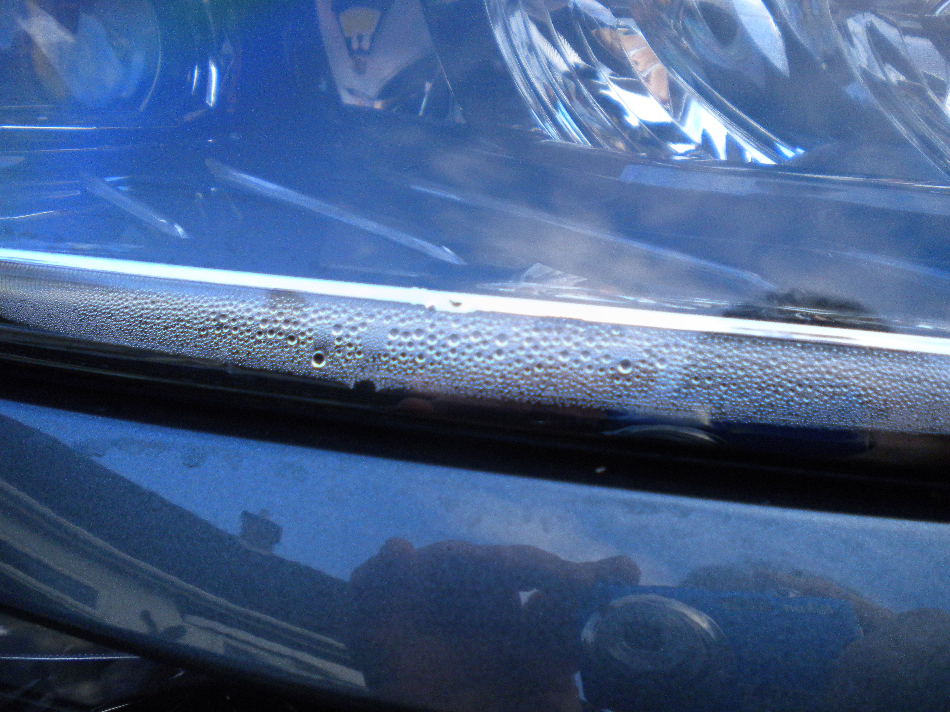

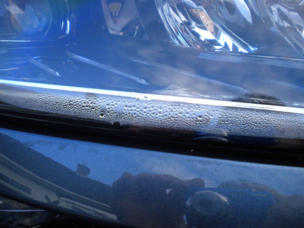

After 3 weeks ownership there is still a small amount of condensation in the very bottom of the RH lamp in two places over the DRL  I gently dried it out completely with a hair dryer but it is back again and the lamp does mist up which disappears after the lights have been on but the condensation remains in the RH lamp.
Does anyone else get this continual condensation in one lamp?
Been out early today in the frost, came back to the car park with motor sitting facing bright sunshine and all 4 lamps had lots of condensation.....not a good look.
Just been out check the situation and after 40 odd miles with the head lights / cornering fogs on.
Attached is offside but the nearside is just the same.
Edited by Berisford
Was that misting or actual condensation ie water droplets?
Misting I would accept but continual condensation will begin to leave watermarks from any minerals in the water.
This I call condensation.
Edited by Delanor
