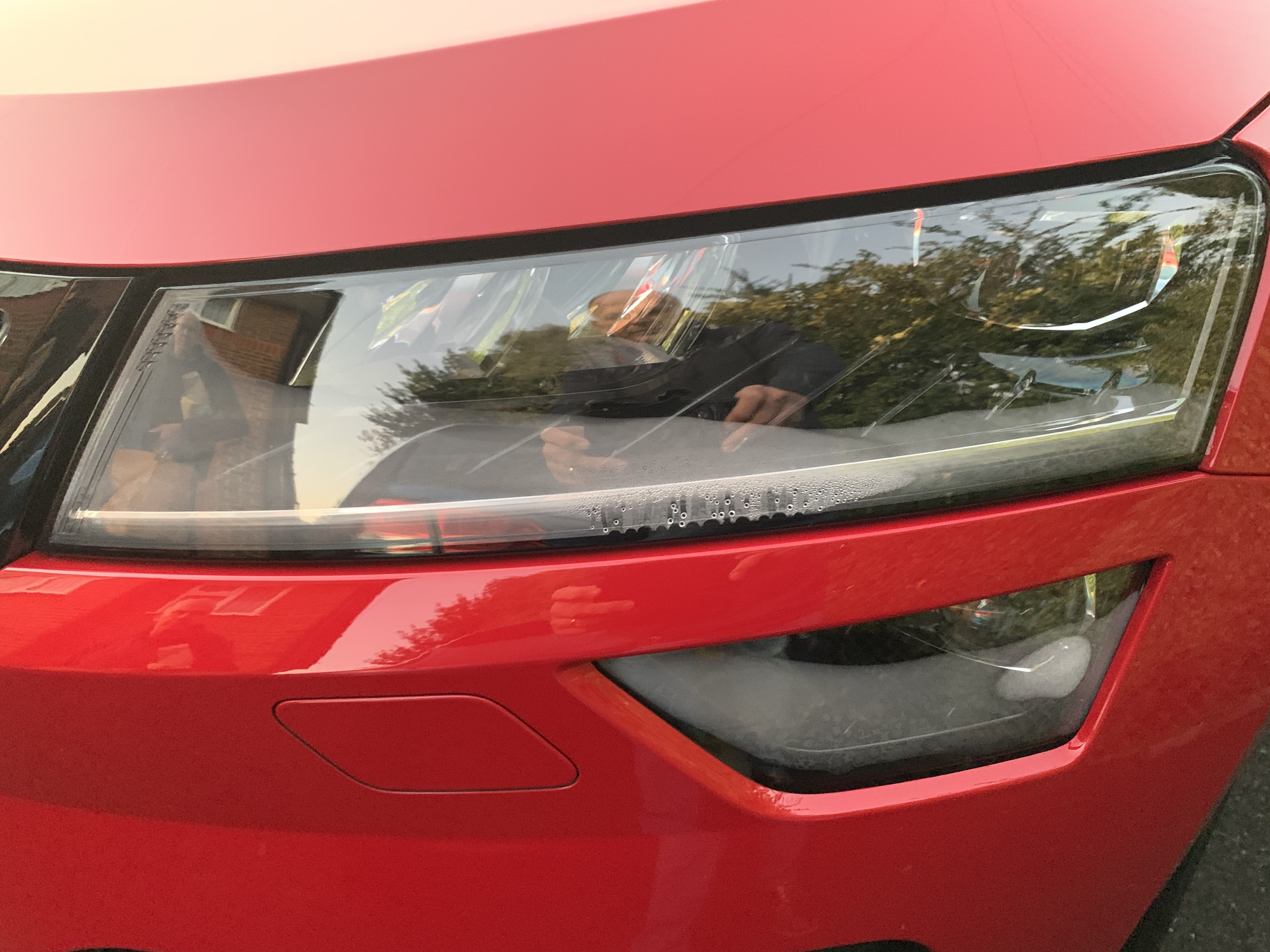

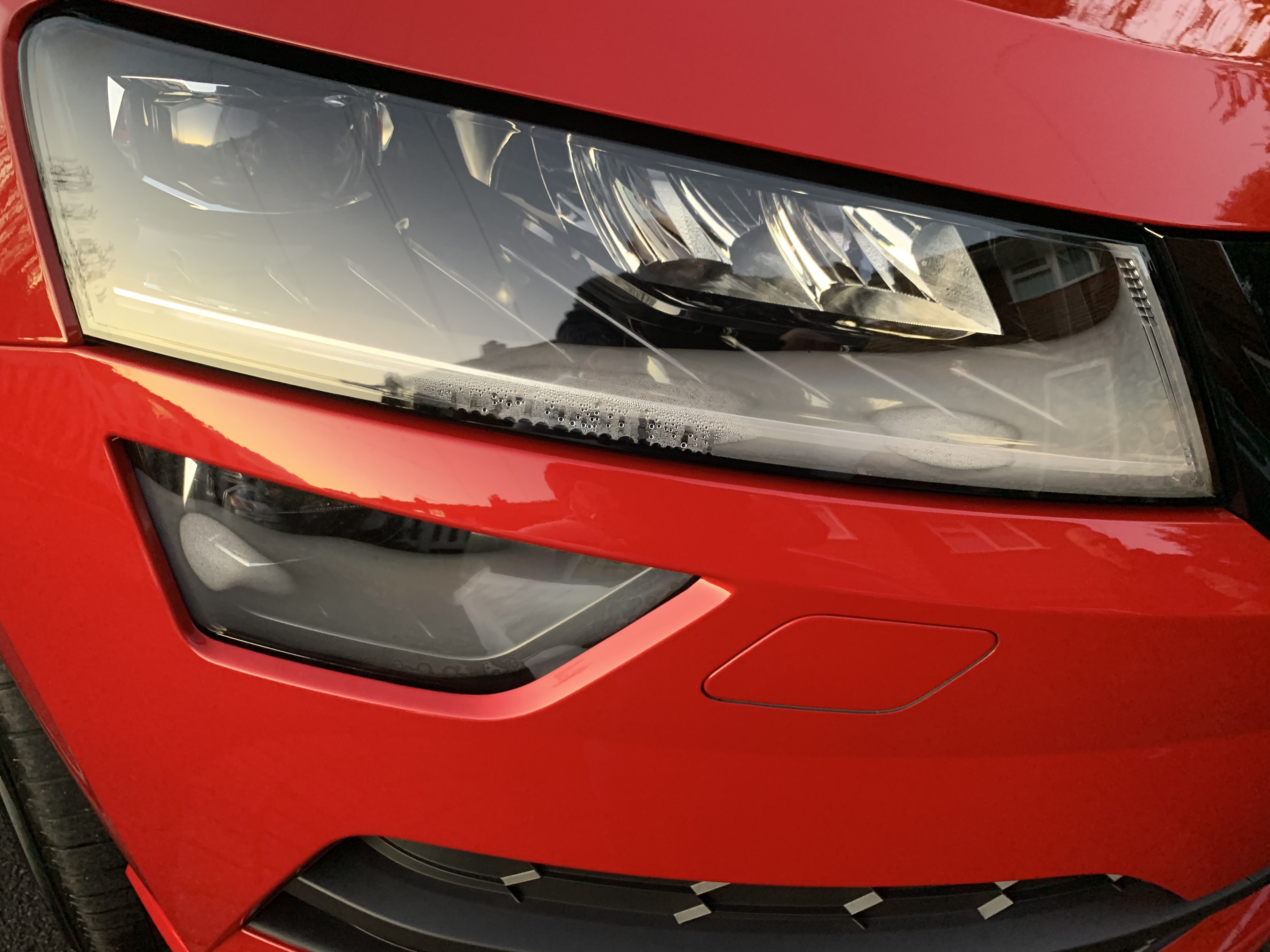

Hi, I have just taken delivery of a new Karoq Sportline DSG 4x4 from a dealership in Berkshire. I have had it 4 days and have noticed that it has heavy condensation in both headlights and the lights below (?fog/side). I have raised this with the dealership who have told me this is normal.
Unfortunately I have to strongly disagree with this. Condensation in a light fitting is far from “normal”. As condensation increases, the water will then pool at the bottom of the sealed units. Over a period of time, that water will rise and splash around inside the unit. How on earth can that be normal?!
My previous Skoda never had this problem and neither did any of the other 50+ Skoda’s in my employer’s fleet.
I took the opportunity to look at several other new Skoda’s yesterday, and none of them had this problem. If it was “normal”, all Skoda’s would have had water in the headlights. This effectively raises the question, “are those vehicles without condensation in the light fitting, deemed to be abnormal, or indeed faulty?
I would welcome your comments before I take this much further.
Thank you.

The light units are not sealed.
Did your previous Skoda have LED lights? This phenomenon is particular to LED lights as they do not run as hot as halogen or xenon lamps so it takes longer to drive the moisture out.
Have the other cars you inspected had the lights on, just been power washed, as yours probably was before you collected it, been driving around in the same conditions you have?

You repeatedly say no other Skodas you have seen experience this yet there's a whole thread here about it and you'll find condensation reports on other Skoda model threads as well.
You also say water will pool at bottom of sealed units. That's not the case, it will evaporate.
Yes there will be those who have faulty headlights, as happens with every manufacturer, but the picture you have posted is norml condensation. It only occurs under certain climatic conditions. When I visted my dealer last week, the guy had just been out washing down all the cars on the forecourt and many of them were left with exactly the same condensation as your photo above.
Please read the owners manual, it says this is perfectly normal.

I have had mine a month on Friday I get misting in the headlights and fog lights which comes and goes when using the lights which I can accept that as the norm to a certain extent but I also get exactly the same condensation at the bottom of the lamp but just in the O/S headlight, it never goes, I removed it with a hair dryer but it just came back which suggests to me that the lamp is faulty or they would both be the same.
I am still monitoring it as I haven`t decided what to do about it yet as I am not really happy with it.
Just to add I can accept misting in some LED lamps but its certainly not affecting all makes as a friend has a new CX5 with LED`s and no sign of condensation, brother inlaw has a new Vauxhall Grandland no sign on that a neighbour has a new VW T Roc no sign on that either last night daughters fella turned up in a brand new Kuga nothing on that either.

It is a defect if the word moisture is used to describe water ingress. Water ingress is indeed a defect.
On the left moisture, on the right water ingress...
Moisture and water ingress are effectively one and the same thing. But by mentioning the word 'moisture' in their owners manual does not absolve Skoda from rectifying faults.
As far as I am concerned the minute the moisture turns into water droplets and / or collects or can be seen to run down the inside of the headlight, then this is a genuine warranty concern.
I am sure there will be some extreme cases, as I listed earlier where the moisture levels are excessive but may not be directly attributable to a fault, such as...

We're going around in circles. The link you posted from Hella has already been posted back on page 1.
The bulletin from Nissan makes mention of droplets of water larger than 3mm. None of the pictures posted on this thread show any droplets that size.
All of the evidence provided so far suggests what you're experiencing is perfectly normal.
