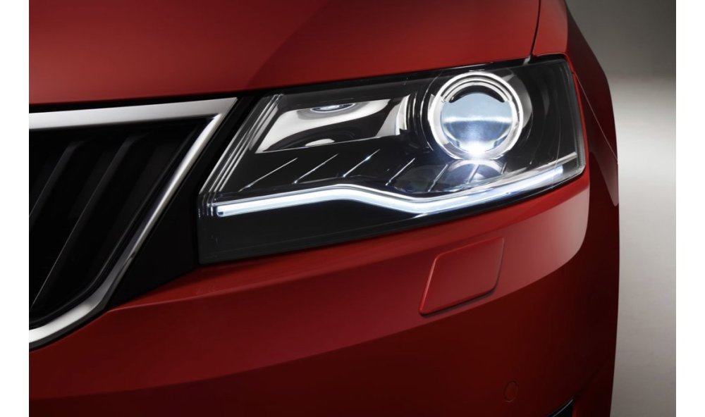

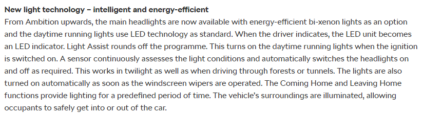

Pay the extra and get a 2 year younger facelift Rapid (2017>) with the factory fitted optional bi-xenon headlights...
They are rare though.

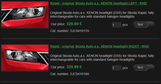

So it might be an option to buy the headlights as a retrofit. As they're under 2,000 lumens you don't need the headlight washers or self-levelling system either.
From Superskoda. These are the pre-FL versions too (incandescent DRL and indicators, rather than the LED DRL/indicator light tube on the facelift)...
http://www.superskoda.com/Skoda/RAPID/Rapid-original-Skoda-Autoas-XENON-headlight-LEFT-RHD

How did you get on with this. I would like to upgrade my headlights of my 2016 rapid spaceback to facelift ones with LED indicator and running light but unsure if they would just plug in and work or some other stuff needs to be done first. The cost is big so want to check if this works or not.
Headlights with Xenon D5s are with normal bulbs for other purposes... not LED indicator... no LED DRL
I like my Xenon D5s... Lights output is much greater then normal halogen...
RHD headlights costs about 120 GBP each
