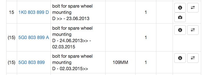

2. Does anyone know the part number of the spare wheel retaining bolt for the MKIII? The manual shows a removable locking mechanism on top of the bolt but the only one I can find that looks correct  here on Skoda Parts is listed as incompatible everywhere else while this one seems correct it lacks the locking mechanism.

2) After March 2015 it looks like 5G0 803 899 is what you're looking for.  There are revisions A & D but these are for cars before 03/2015.

2) Thank you! I couldn't find a database to confirm that part number. Seems to be slightly larger than the previous generation.

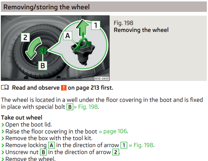

21 hours ago, gregoir said:
I've never heard of a locking mechanism for a spare wheel inside a lockable luggage compartment.
Underneath the car, yes.
It looks like a plastic ring-pull that simply stops it unscrewing from vibration. From the manual:
