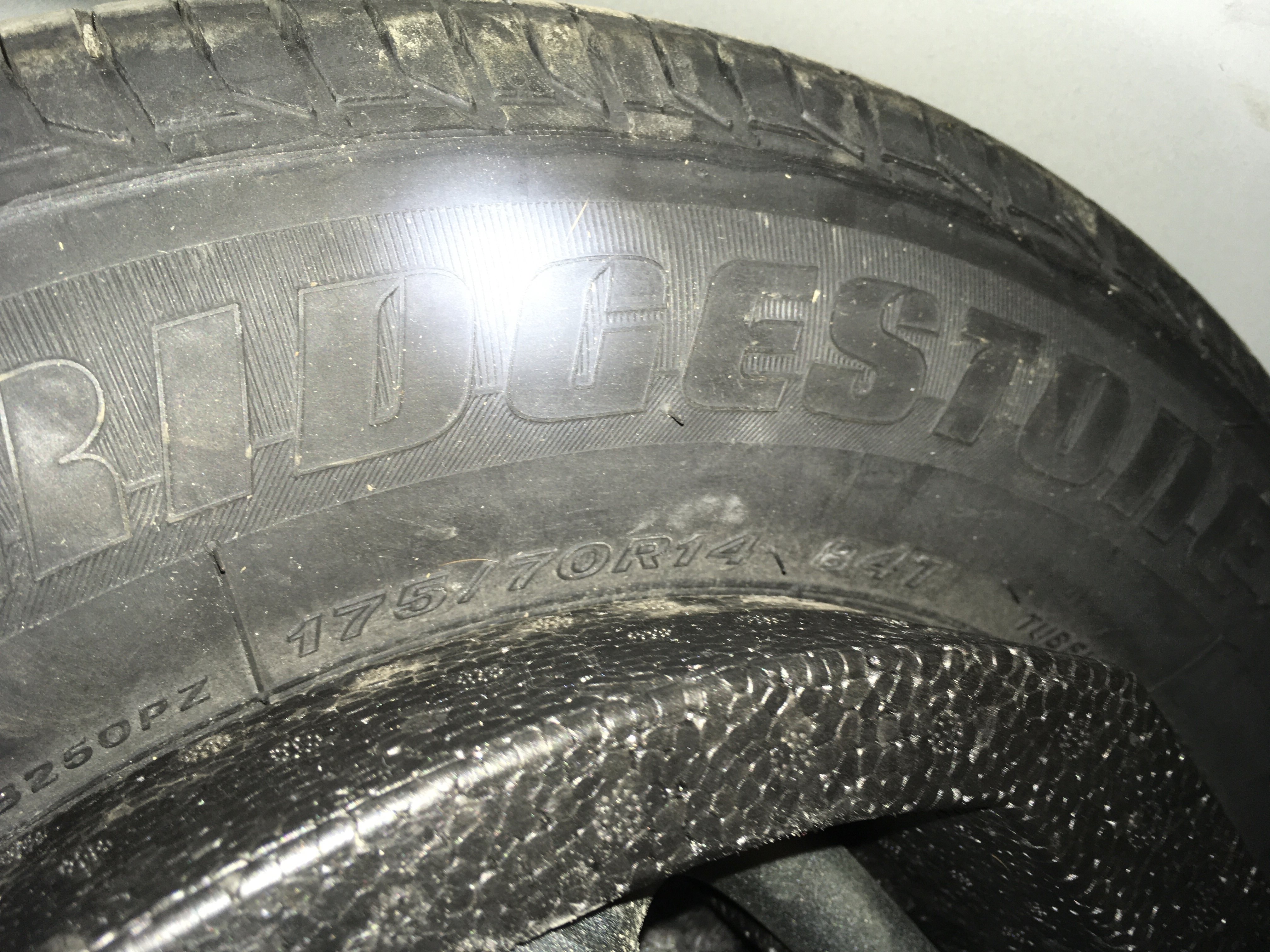

Turns out I misremembered the rim diameter of our spare wheel. The spare is a 175/70/R14 (in 84T).
Given that the r14 diameter is listed in the sticker on the inside of the fuel door the size must be legally allowed for use on the Fabia.
Whether or not it's a good idea to go for this tyre size as a fulltime solution is a different matter. For actual driving on snow a narrower tyre might indeed be the better choice, but that should still remain the exception...

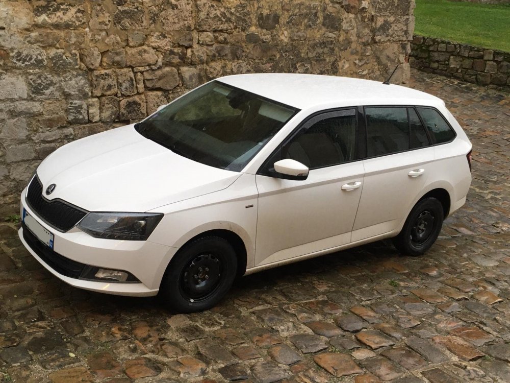

New wheels!
175/70R14. Seeing them next to the huge 215 wheels that came off they looked puny but on the car they don't look flimsy at all. I never drove the car before yesterday  when I took it to and from the workshop - and on the way back I had the 4 summer wheels in the trunk so had to drive really carefully. The ride should be softer, and that I should be able to confirm next time I have to be in the back :)
The rims look like the Alcars mentioned above, and they're indeed not as good-looking as my own steel rims (which are Alcars too, curiously). It must help that mine didn't need any balancing weights.
But: surprising how much smaller the car actually is than my Octy. As a passenger I never really noticed it, and the difference in trunk size isn't easily noticeable either. But behind the wheel it cries out: even with the chair all the way back I only have just enough leg room (in the Octy I still have several clicks more on the rail). In the previous C3 I had to be really careful not to hit the brake and accelerator pedals at the same time; that's no longer the case but with the top-hinged action I do catch my toes on something above the pedal when I try to brake.
I tested the cruise control which my wife never uses: turns out that it allows you to shift gears without having to re-engage the control. That's something I missed in the past but to which I adjusted; now I actually like to disengage the cruise control with my left foot rather than via the brake (not to mention via the finicky switch that you're actually supposed to use).
The clutch action is also much earlier on the pedal course; is that related to this being a petrol car, or is it an indication that the clutch in my Octy is nearing its end of life?
