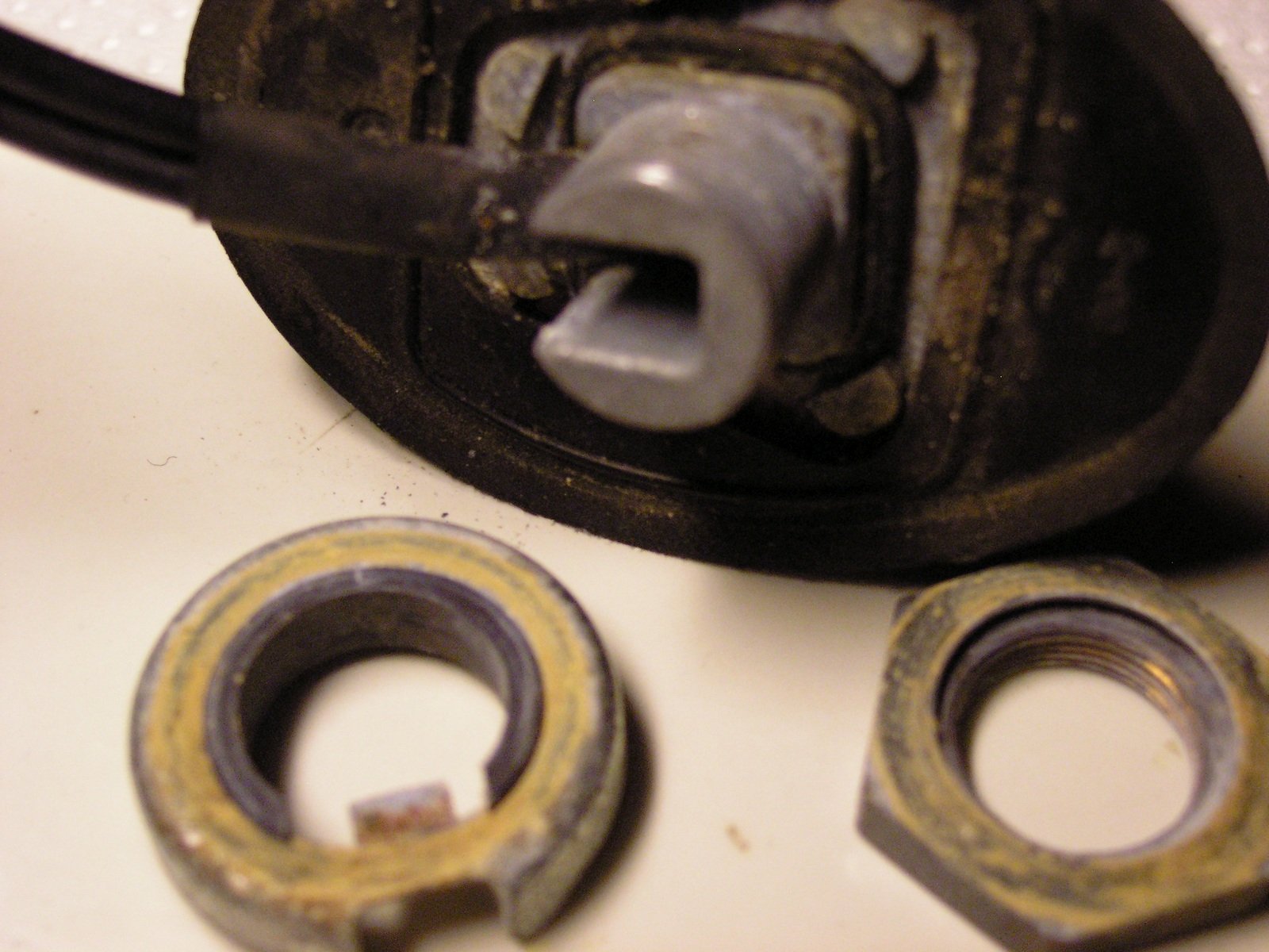

Diagnosis, round 3: Find a Youtube video of how to access antenna on the roof (-00 estate so it's in the back) and notice it's actually simple, just remove the plastic rear panel from the roof and one panel stud holding the soft roof in place. Nice. Disconnect 2 wires (radio & GSM) and use a 22mm wrench to open the nut keeping the roof unit in place. Notice that absolutely 0 connectivity between roof unit chassis and grounding point leaning to roof. OK, problem #1 (pic PB162179.jpg sorry for quality on that): Rust on the steel ring on the left, thoroughly black ("rusted") brass nut on the right and unit body on top. Grounding is supposed to go from roof to steel ring, from there to nut and from there to unit body.
Only connection actually working was between steel ring and roof. Cleaned steel ring and nut with sandpaper and thread with Autosol (good stuff). OK, connectivity achieved, put everything back. Still no good reception, problem #2.

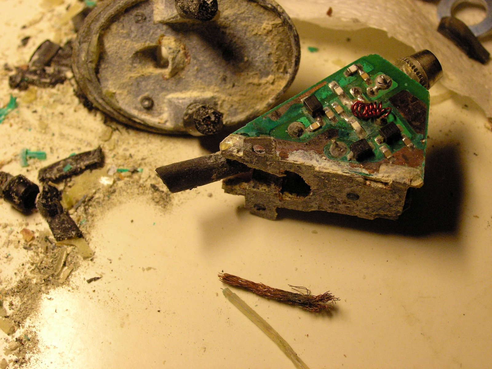

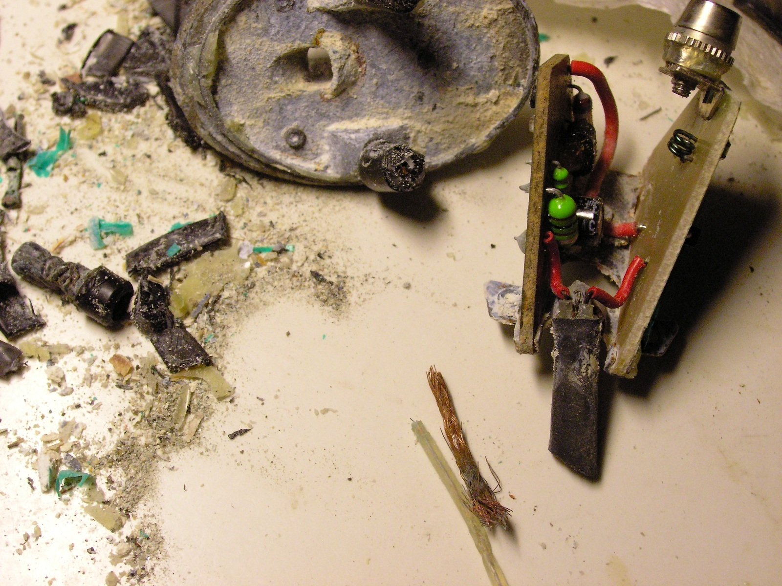

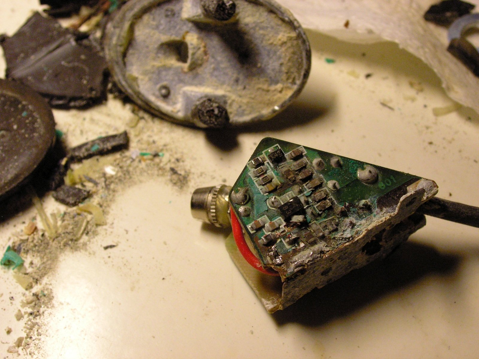

Diagnosis, round 8: No signs of leaking roof, so I disassembled (with very much brute force) the roof unit. You could have opened it with two screws (under the glue) but too fancy: This is a scrapped unit anyway. What I found was basically trash: Rusted and oxidized components of something what has been a RF-filter splitting signal to GSM- and radio-segments. Worst condition for piece of electronics i've seen in long time. See the other 3 pics.

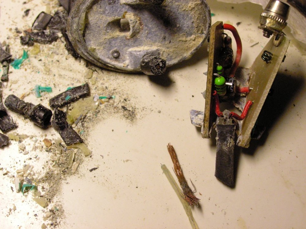

The PB172182.jpg shows the reason why the wires were so bad, as it shows the roof unit end of the wires and as you can see, there's nothing at all blocking water entering the wires. Thick black section goes out and small red wires feed them ... see how the copper is totally black and capillary force nicely pulls that dampness all the way through wire.
Usually this kind of outputs use hot glue or something like that as dampness prevention. And of course lacquered circuit boards. These ones don't have anything at all, as if this was designed to normal office environment and not to roof of a car.  Ridiculous level of cost savings, if you ask me.
A least the case was glued shut but obviously that wasn't enough.
