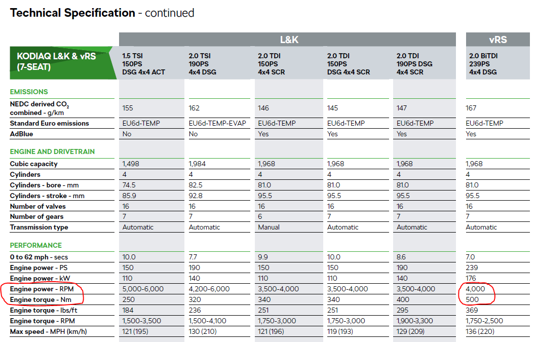

You're not getting all of that 500Nm until 4,000rpm, hence the car holding onto the gears...
Max engine power is available at 4000 rpm, correct.
But max torque is available between 1750 - 2500 rpm.
You're using the rpm for max power...definitely agree however that using 2/3 throttle and complaining about high revs is a bit weird.
It should also be noted that the Kodiaq RS has a short first gear ratio of 3.80 (for reference, the 190PS TDI's first gear ratio is 3.40), so that could a factor into why the car shifts later than expected, given the torque figure.
