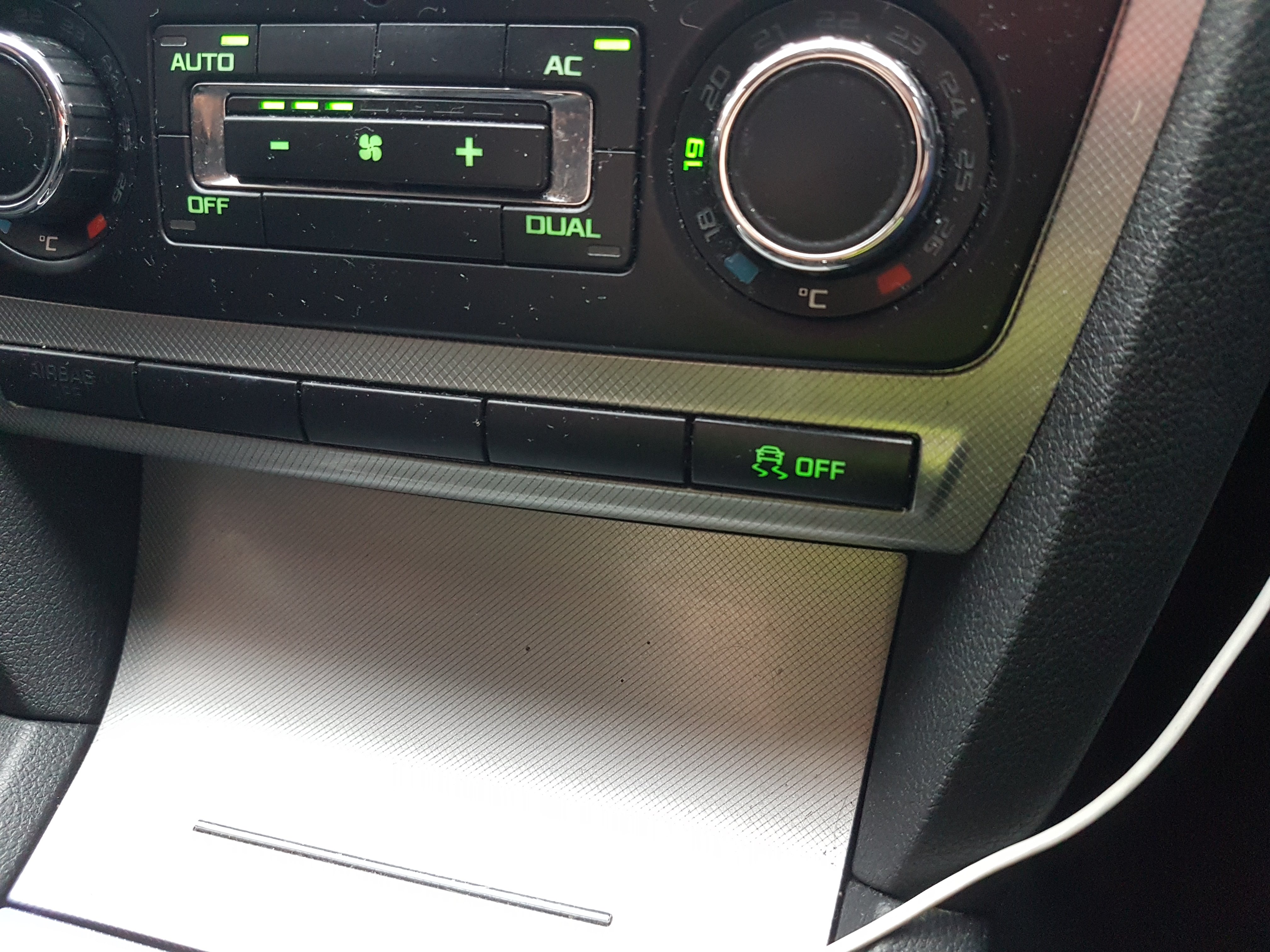

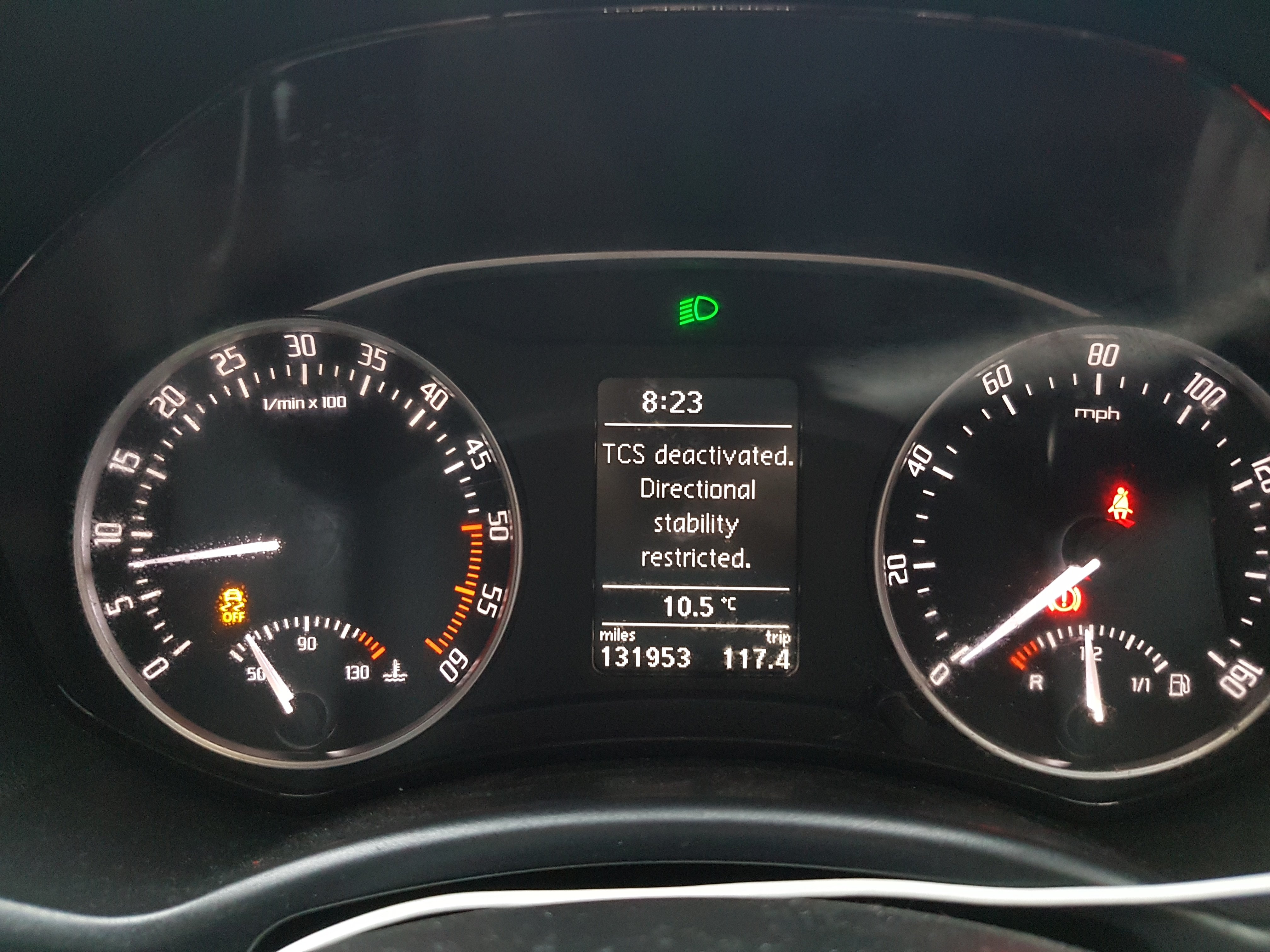

This is what I get when I disable TCS. It's a solid light, not flashing
I have the MK60EC1 ABS pump and the following button
I believe the cluster behaviour changes depending what software version it's running.

And also the button is first on the left.
Mine's behaves like MadaRS180's

The button layout is mirrored on LHD cars
Sorry, yes, my fault of thought..
