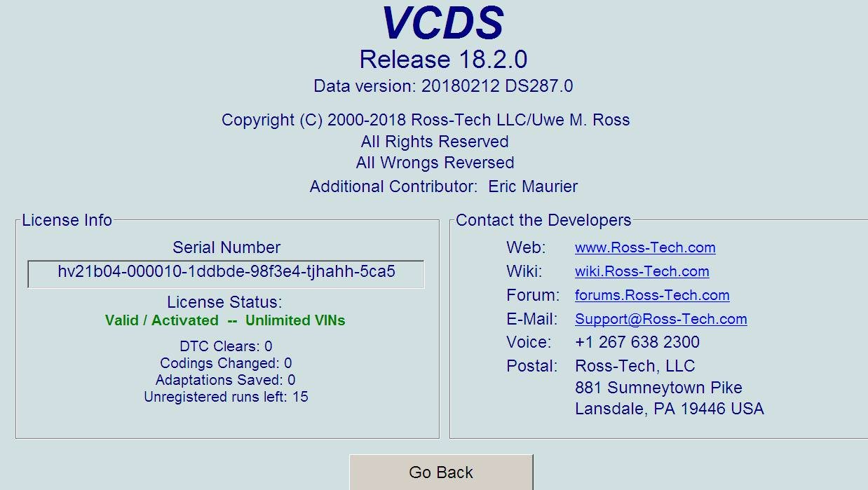

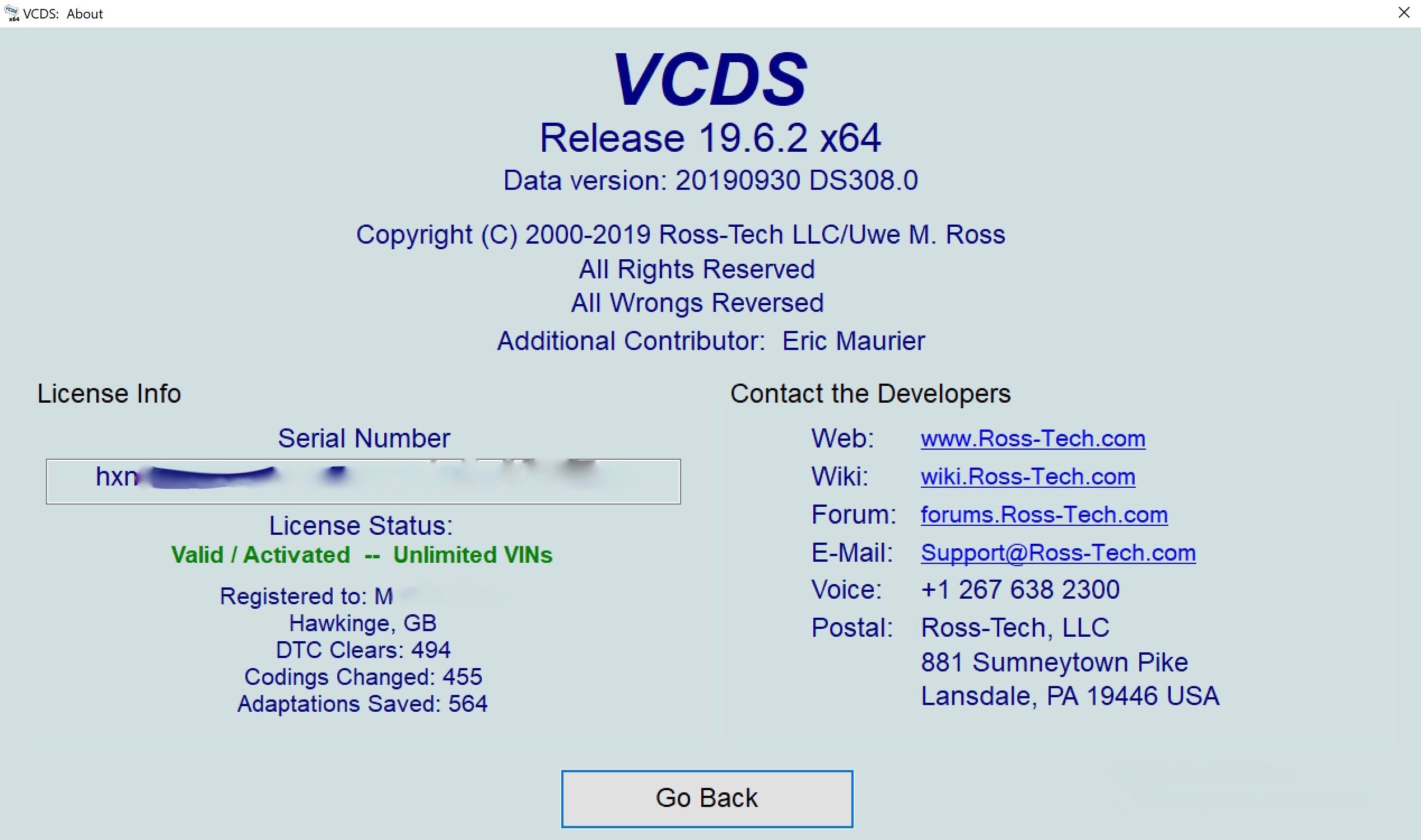

The info is also under the about page once you have opened up VCDS (with the cable plugged in):
This is mine hxn = HEX-NET
as you can see there is a fair bit of info on there that can be useful.
