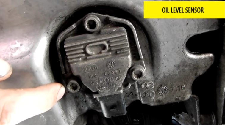

The sensor should look like this on the bottom of the sump Tom...
Thanks @TMB and @Tech1e, I'l have a look at the bonnet catch in the morning and if its still illuminated, i'l get my mechanic to check the sensor under the sump when it goes in next week.
