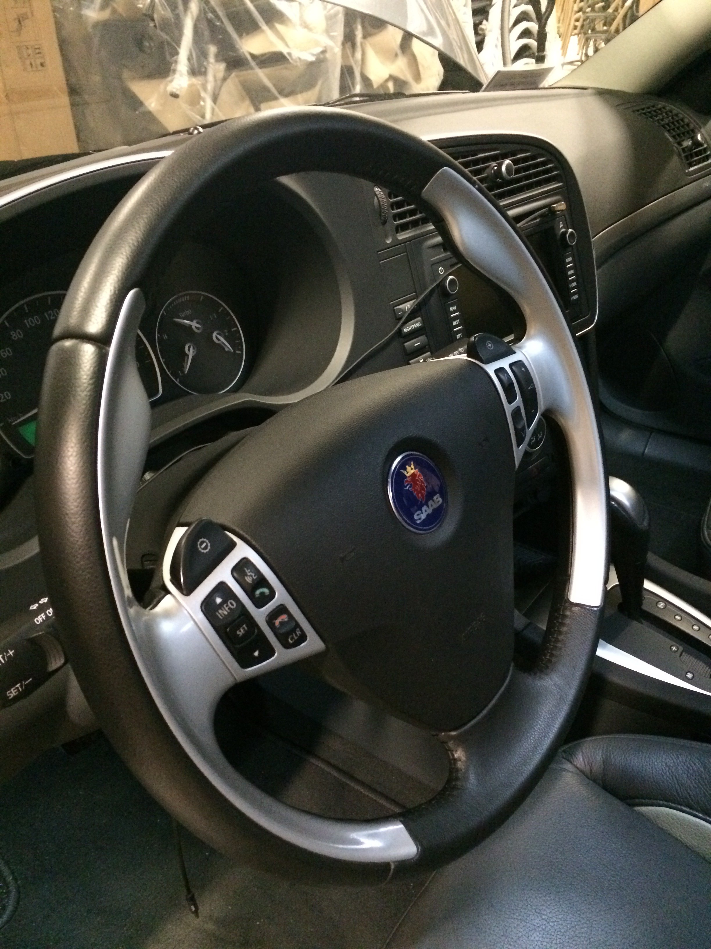

This is not a great picture, but this is what my old cars wheel looked like after 90 000 km (it even looked better/not shiny at all irl):CF1D5F86-9E84-4677-AAC0-5EDD6AA67AAB.thumb.jpeg.f143f68f93fa3aacece7a2d0a22555dd.jpeg
So if you just want the matt finish instead of switching the wheel, cleaning it is MUCH cheaper. ;)
