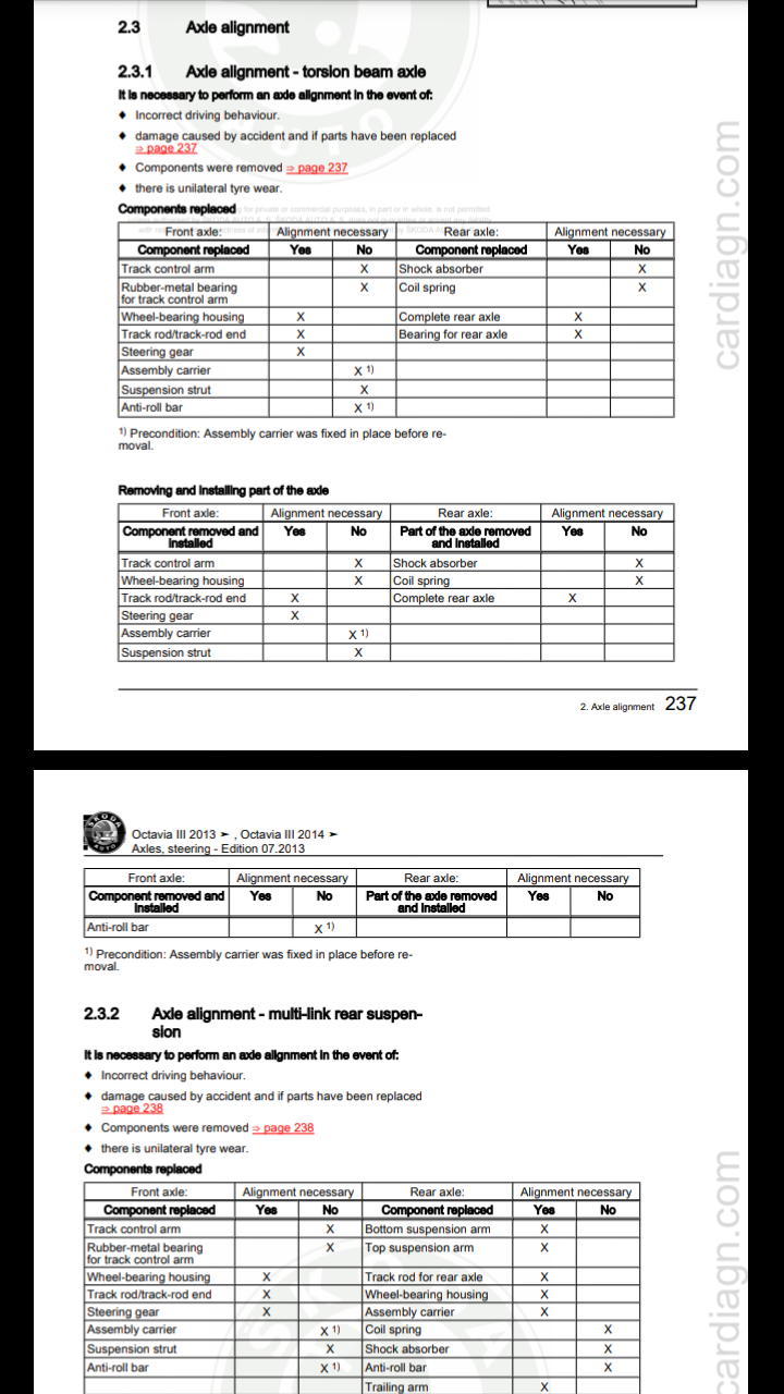

19 hours ago, newskodadriver said:
Do wheels need an alignment after bushes are changed?
Provided you have not done an alignment change at time when the bushes were worn out then no, no alignment is necessary. Inserting new bushes, merely restores the bushing geometry back to the factory fresh condition.
The following table is for the Octavia iii but Im sure the mk2 would be the same.

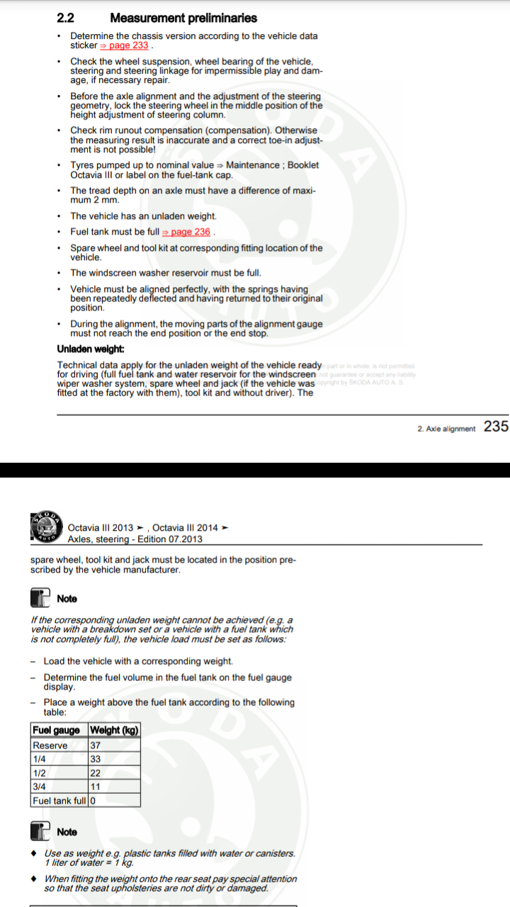

Remember that correct alignment requires, good evenly worn tyres the car to be correctly weighted, and suspension properly settled.
