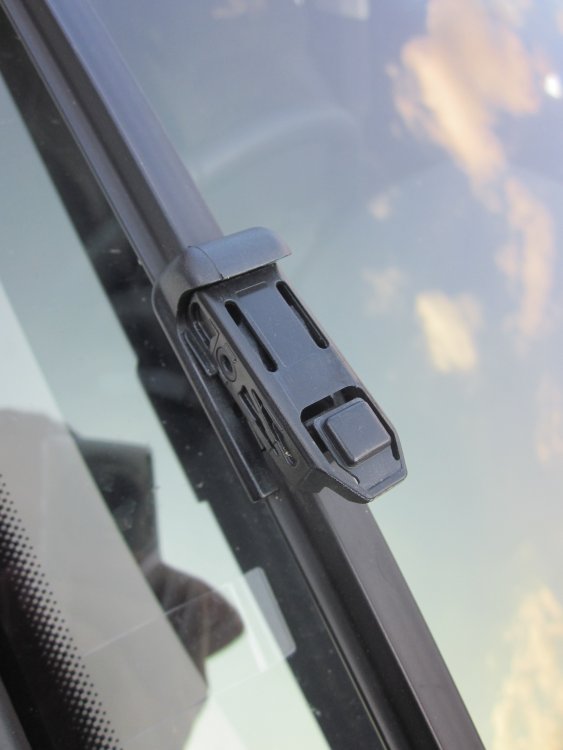

However, I'm unable to get the passenger side wiper blade off.  The little clip/button that you depress to release the blade has actually broken off - the wiper moves a couple of mm in and out of the arm but I can't get it to release and slide out.
Any suggestions as to what needs pressing/etc seeing as how the clip is no longer there to hold it in place?
Use a small flat bladed screwdriver the press the broken clip.

Even after pressing the clip, there is still quite a bit of tension / friction that you need to overcome in order to slide the blade out of the arm.
If in your case the clip has completely deteriorated then there shouldn't be anything holding the blade in, unless the way in which the clip has broken is somehow jamming out of site.
I'd be tempted to try a little brute force and wiggling before giving up.

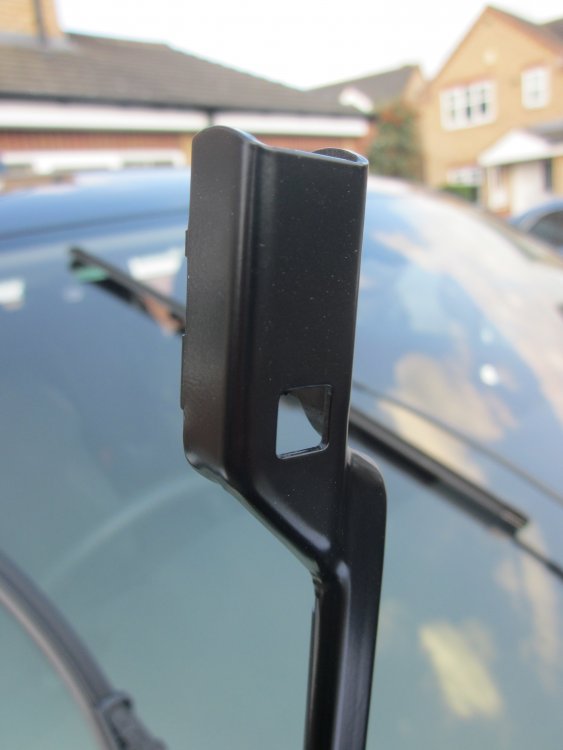

Thanks for all the suggestions, and the photos.  As far as I can see, the clip has broken off completely so there shouldn't be anything else holding it in.
There is a certain amount of quite free movement (about 3 mm) which wasn't there before the clip broke but then it's as if there's still something solid stopping it coming out any further.  Looking at the old driver's side blade I can't see anything else that could be stopping it.  I've tried a bit of brute force and even a large flat-blade screwdriver between the blade and the arm where I can now create a small gap, but it appears to still be solidly attached.  I'm a bit hesitant to heave on it too much as I need the car later today and it's heaving it down with rain, so I don't want to damage it but still not be able to get it out.

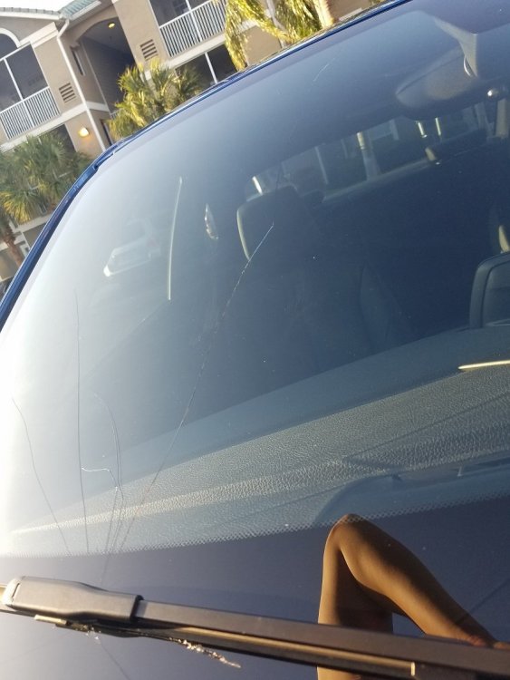

Or worse still, when the blade finally releases from off the wiper arm (now without the blade attached) it slams back down onto the windscreen, smashing it.
It happens more often than you might think!

I discovered the knack of removing these wipers is to twist slight upwards as you pull, having depressed the square button - they slide straight out easily.
