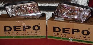

I didn't get my lights from ECP, I got a pair of Depo ones off ebay but it was ages ago now. I also put Osram Night Breaker bulbs in them and it made quite a difference. Still very happy with them.
