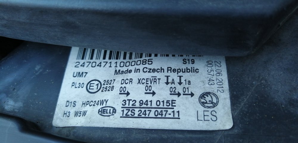

Hi, chapz,
I have a RHD 2012 Skoda Superb FJ12 WNF with Xenons and I need a nearside headlight.  My part number is 1ZS 247 047-11 but I cannot find that part number ANYWHERE on the internet.  I can find plenty of 1ZS 247 047-361, however.
Will the 1ZS 247 047-361 fit, do you think?

Try looking 3T2 941 015 E instead 😉
Thanks but that throws up mainly halogen units.  The 1ZS... is specifically xenon...
The 3T number is the correct Skoda part number. The 1ZS number is probably Hella's p/n for it but you might have a hard time finding that in a search.

Erm... If you match the full 3T2 part number it'll be an exact match to your existing unit. There are other similar part numbers which can be halogen but the last three digits or suffix will be different.
For example, eBay items 223561447154 and 273890701496 are both matches and xenon.
