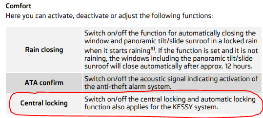

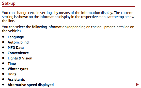

You can alter the behaviour in the setup menu on the MFD. Go into Settings->Convenience->Central Locking and it should be in there. There are a few options for controlling how & when the car locks and unlocks which are pretty self-explanatory.

Have you looked at the settings for selective unlocking?
Aside from that, do all of the controls on the driver's door for other doors (mirrors/windows/etc) work properly?
