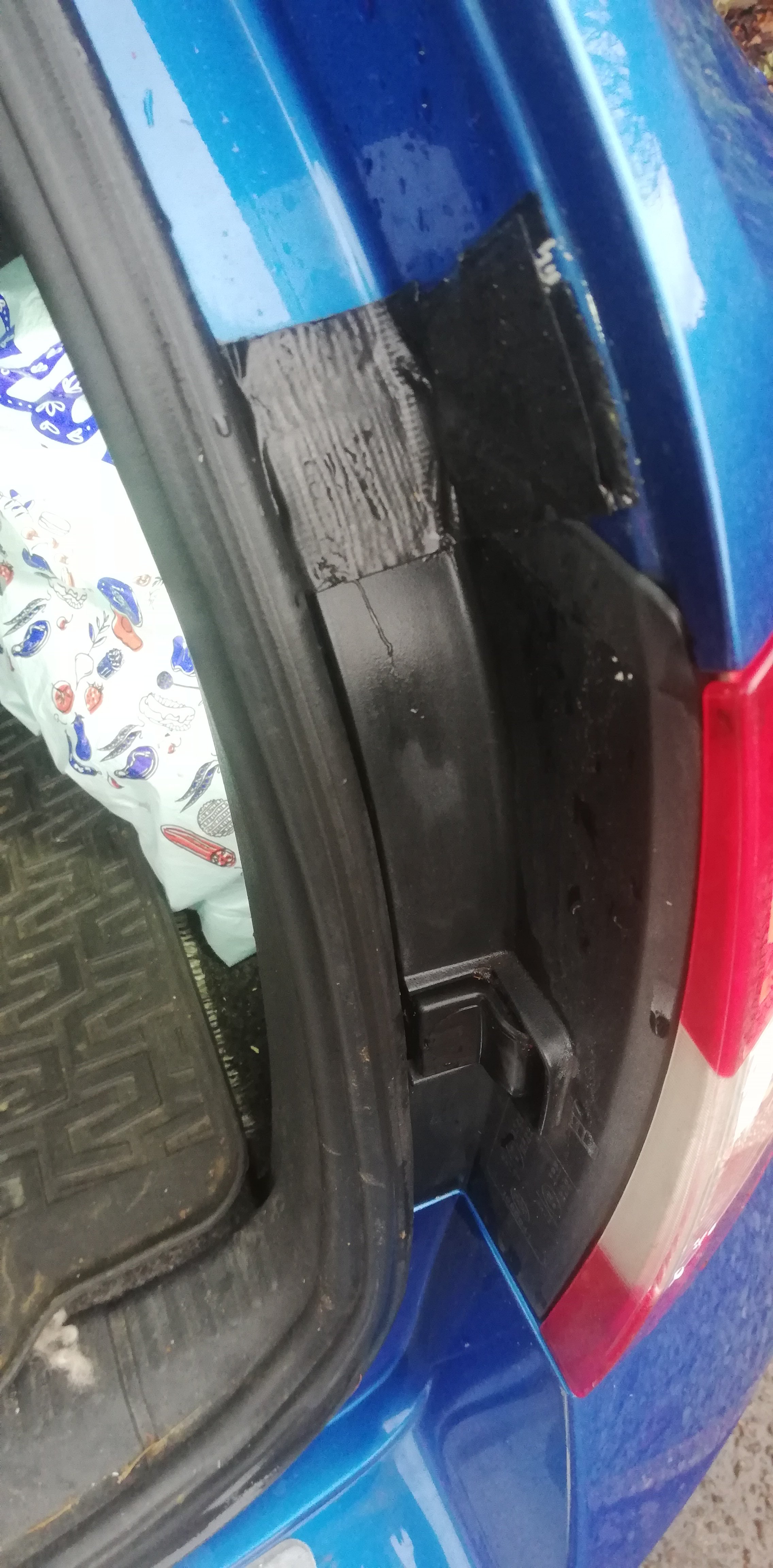

I had a similar problem a couple of years ago.  Ended up with an inch of water in the wheel well.  Having drained it, and dried it I covered the whole area in talc powder and waited for the rain to come back.  This very effectively shows me the track of the water ingress.  Turned out to be coming in under the black plastic trim next to the rear lights after running down the side of the car where the boot shuts onto it.  It then went half way across the car inside the plastic cover and ran down a rivet to drain into the wheel well.  A simple piece of gaffer tape across it stopped it permanently.  Can't get to the car at the mo, but I'll post up a pic if that doesn't sound clear
Thanks for the reply I may well give this ago sounds like a very good idea.  Please can you you post a pic it would be very much appreciated.  The water in mine seems to sit on top of the rubber seal then finds it way in.

Here you go.
Water would run down the side and underneath the plastic.  The gaffer tape redirects it down to the bottom and then on to the bumper and away.  Worked for me!

2 hours ago, Burchy said:
Here you go.
Thanks for the pic I'll take a look tomorrow in daylight.
