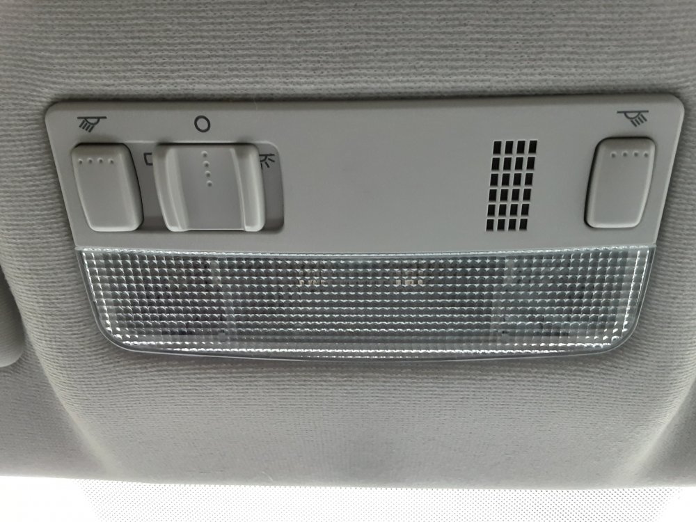

My wife's 18 plate Citigo has developed a problem with the interior light.
The auto centre position doesn't work but it can still be switched on manually.
The car is in warranty but I wondered if anyone else has had this problem and is it an easy fix?
It's the type on the left in the photo.

The central position you mentioned as being faulty is the 'OFF' position 'O', so the light isn't meant to illuminate when the switch is in this position?

I do realise now that the centre position is off but it wasn't working in the 'auto' position (switch to the right) either where the light comes on when the car is unlocked.

That light is the standard one that is/was fitted to any number of VAG vehicles over many years and is a straight swap for the light without the individual reading lights. I fitted one in both the Citigos I have had.

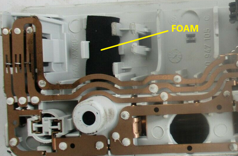

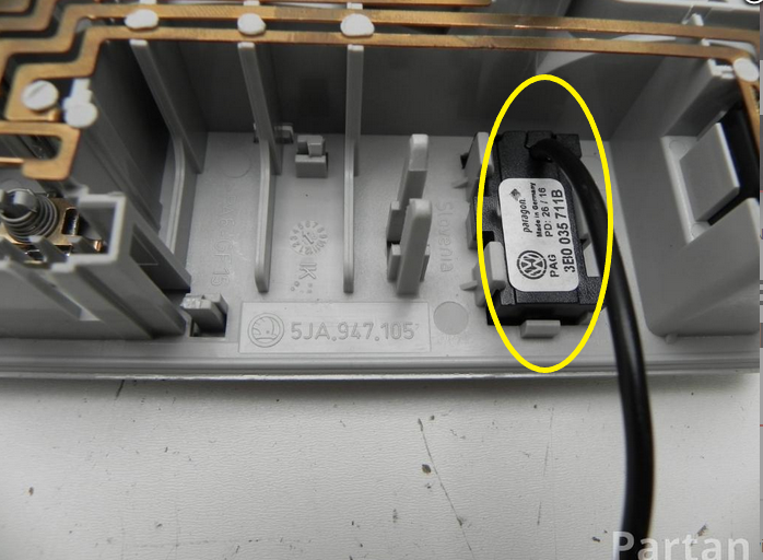

By the way,what's the rectangular grid for as shown in my photo?
It's a Bluetooth microphone (or position for it). If not fitted there is usually just a lump of foam shoved over the holes.
