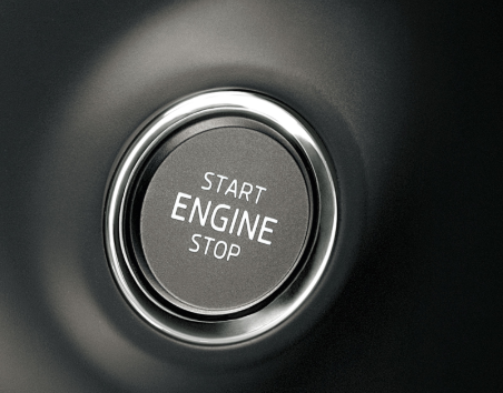

Just for Clarity, my guide refers to the Engine Start/Stop Round button switch mounted in the lower cowl of the steering column, where an ignition key would normally be found. Standard fitment on certain models at the time (keyless ignition). Removing the chrome outer ring and a liberal spraying through the holes with contact cleaner briefly helped, but I replaced switch in the end.

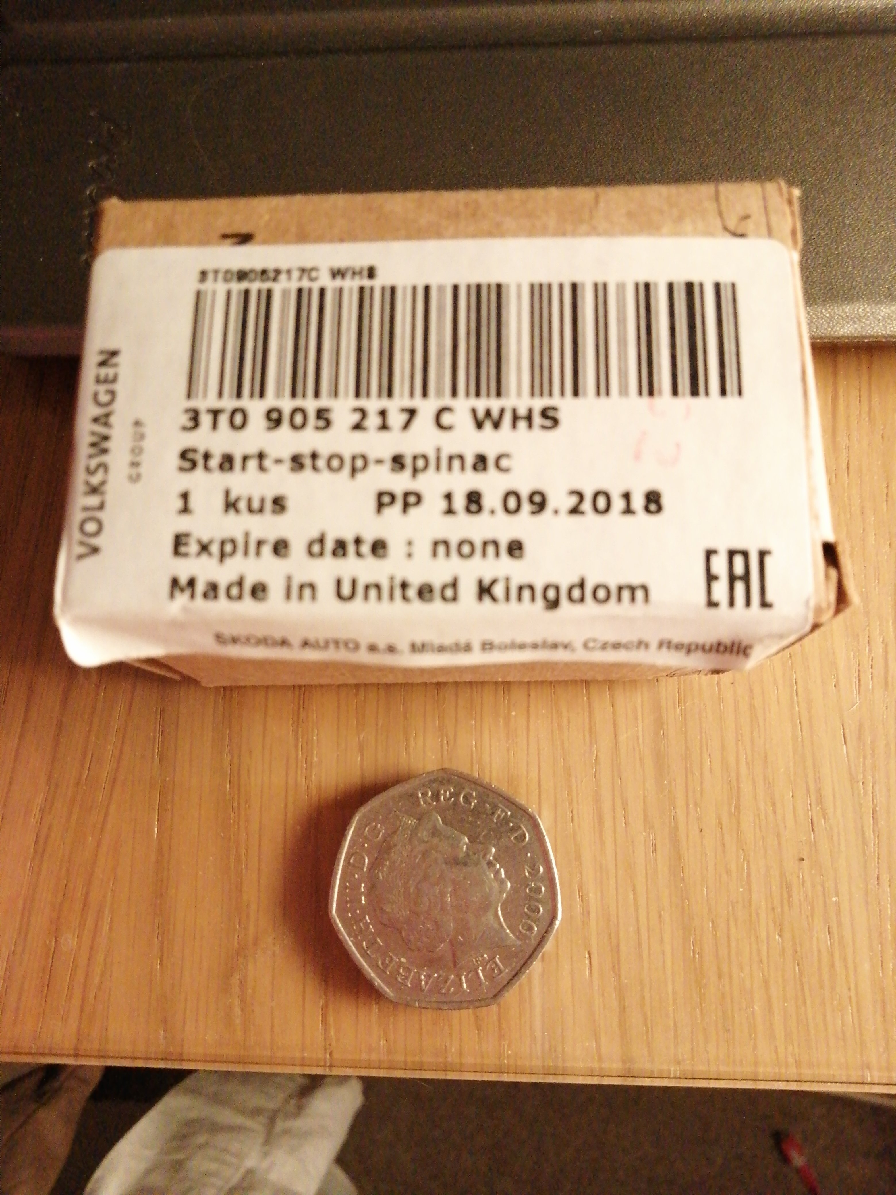

Hi, Only too glad to help, the part number on box is
3T0905217CWHS Start-Stop Switch, paid about £32, from TPS Poole, genuine parts supplier (branches Nationwide I believe).
I resisted changing it until it was absolutely necessary.
Good Luck
Start-Stop-Spinac (not sure what a Spinac is?), but this is the box!
Made in United Kingdom 😮  👍
