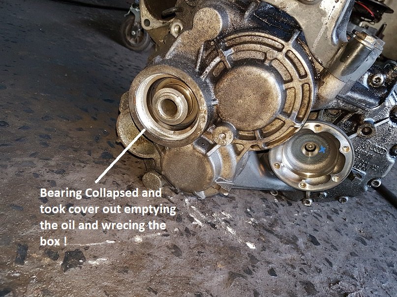

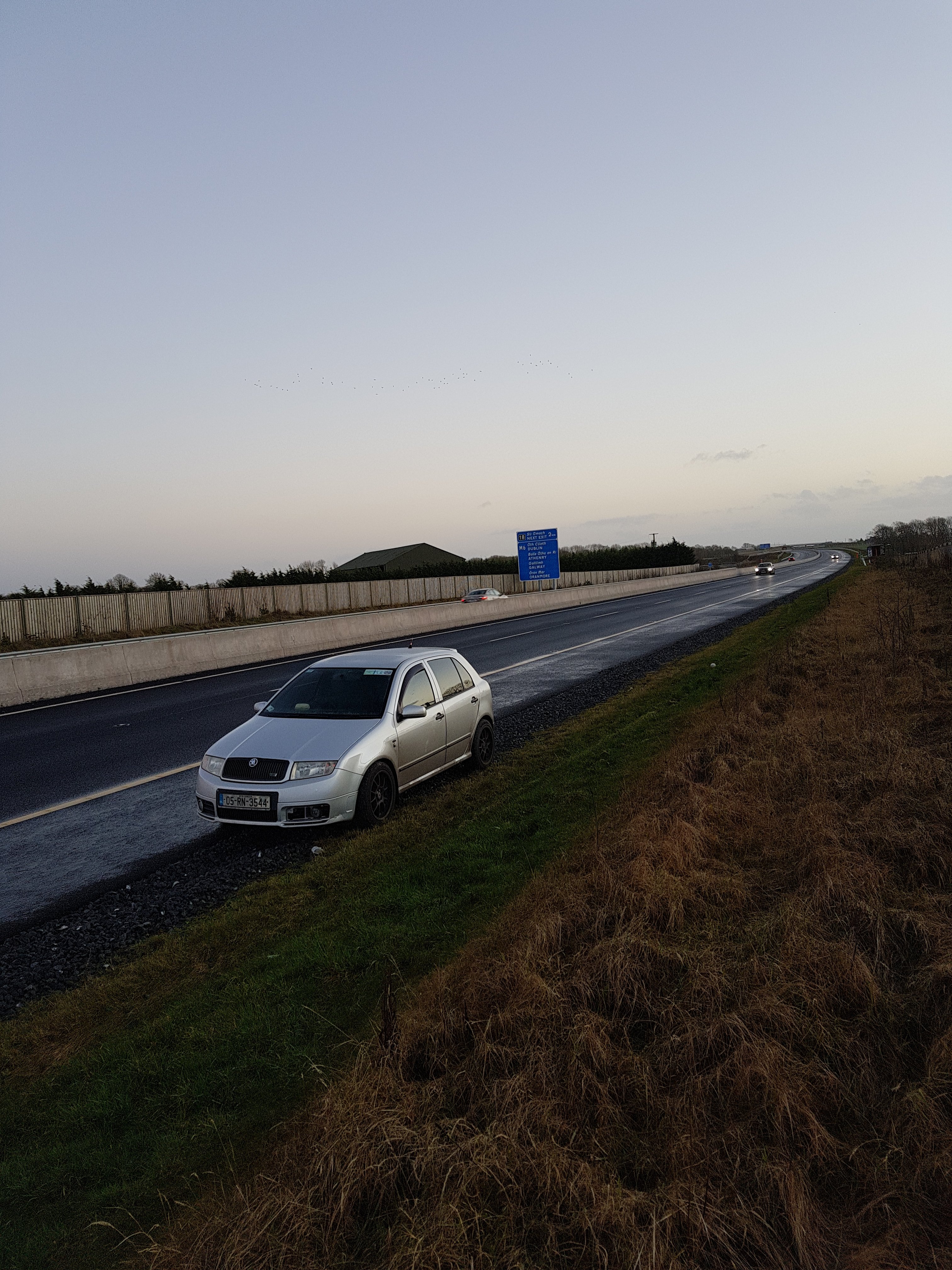

Well the story of nursing the gearbox ended in failure this afternoon - I got a date for next week but alas she stopped- suspected broken input shaft as the gearbox rattled in neutral now it's silent whether the clutch is in or out !
I got a tow to Clonberne so she is now awaiting TLC
Hi All

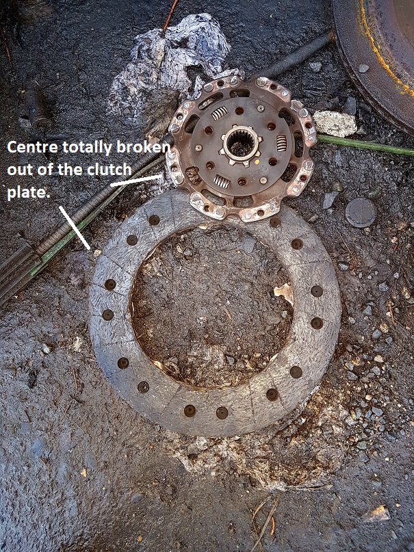

        The strip down was interesting ! All notions of building a gearbox from the damaged one have faded ! The post mortem revealed that one of the bearings collapsed and broke the casing emptying the oil - I didn't realise this and drove on ! The clutch disc then broke up probably due to the stress of a seizing gearbox !
