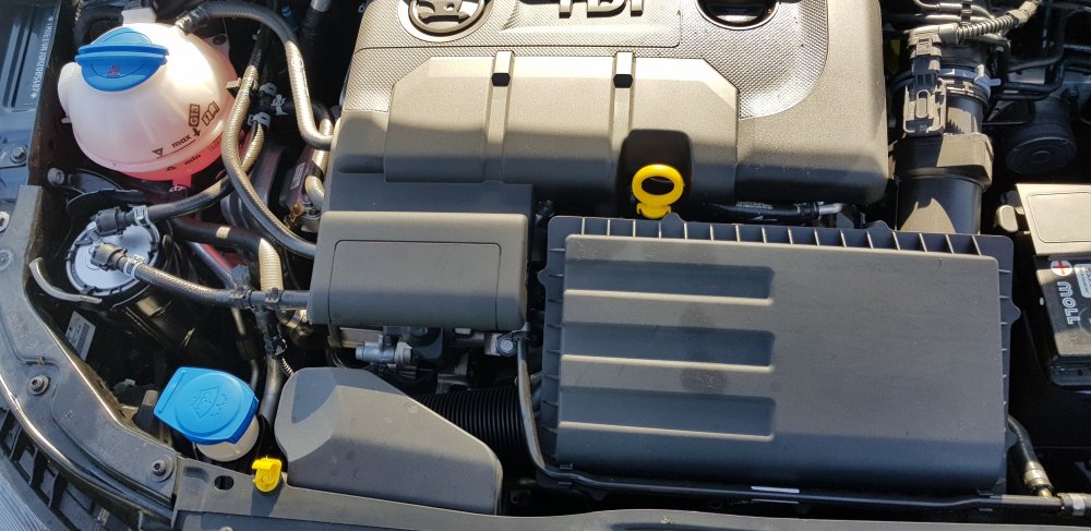

I have purchase a skoda fabia mk3 1.4 tdi 75cv since years now, so now I would like to change its filters at my own. As first thing I would like to change the air filter can somebody guide me on how to do that since I didn't find anything on that.

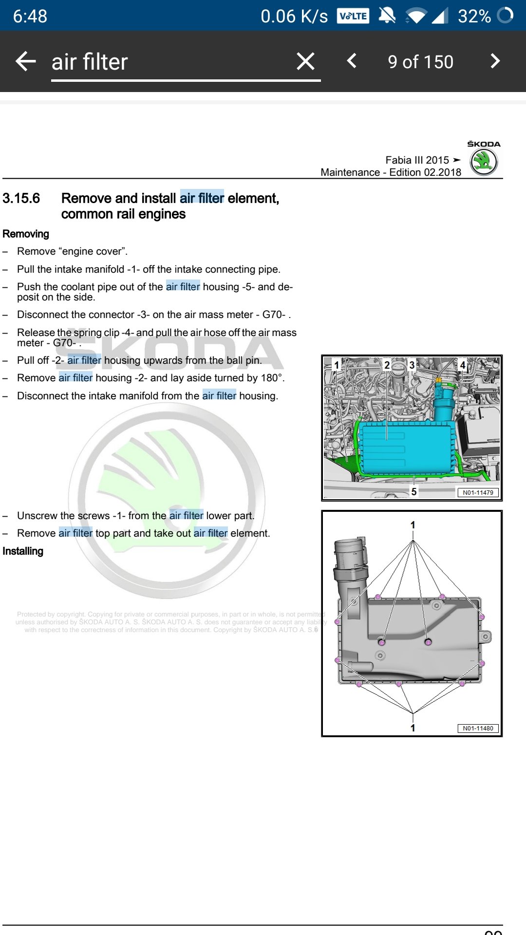

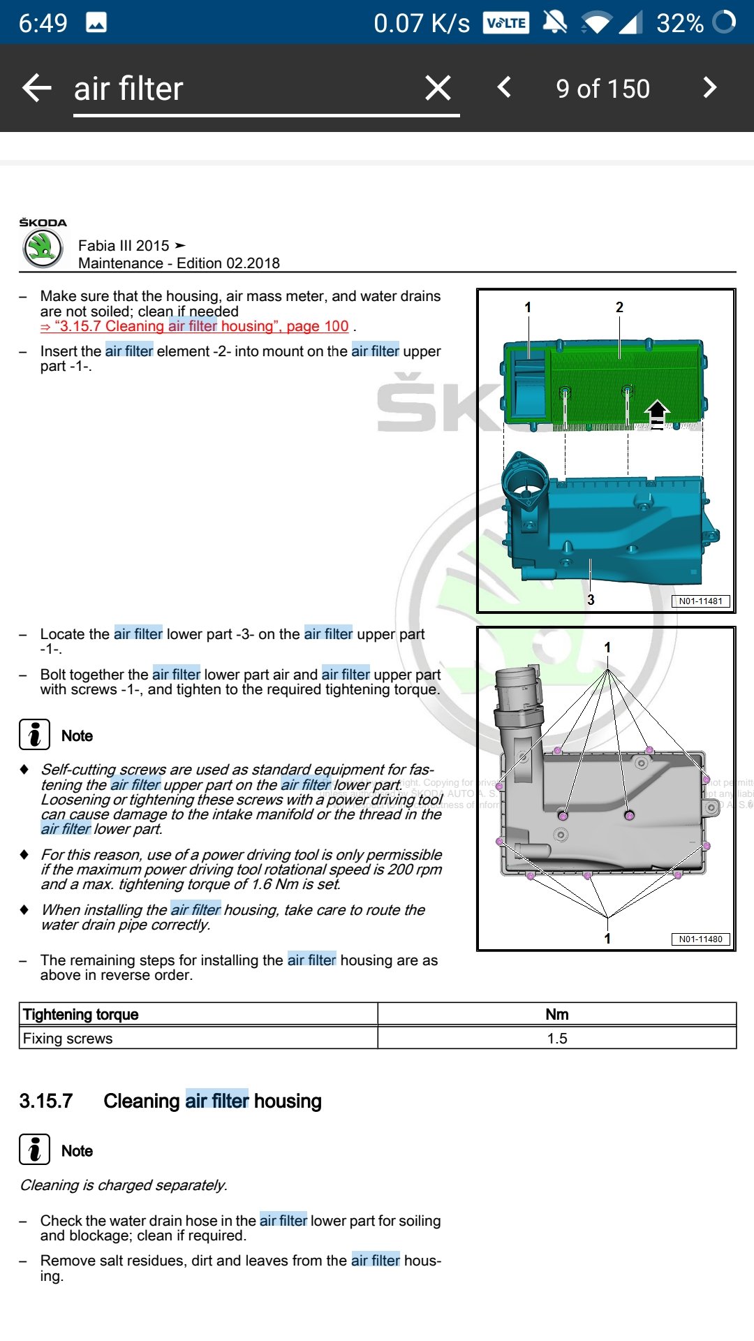

Screenshots from a manual I have. Also.

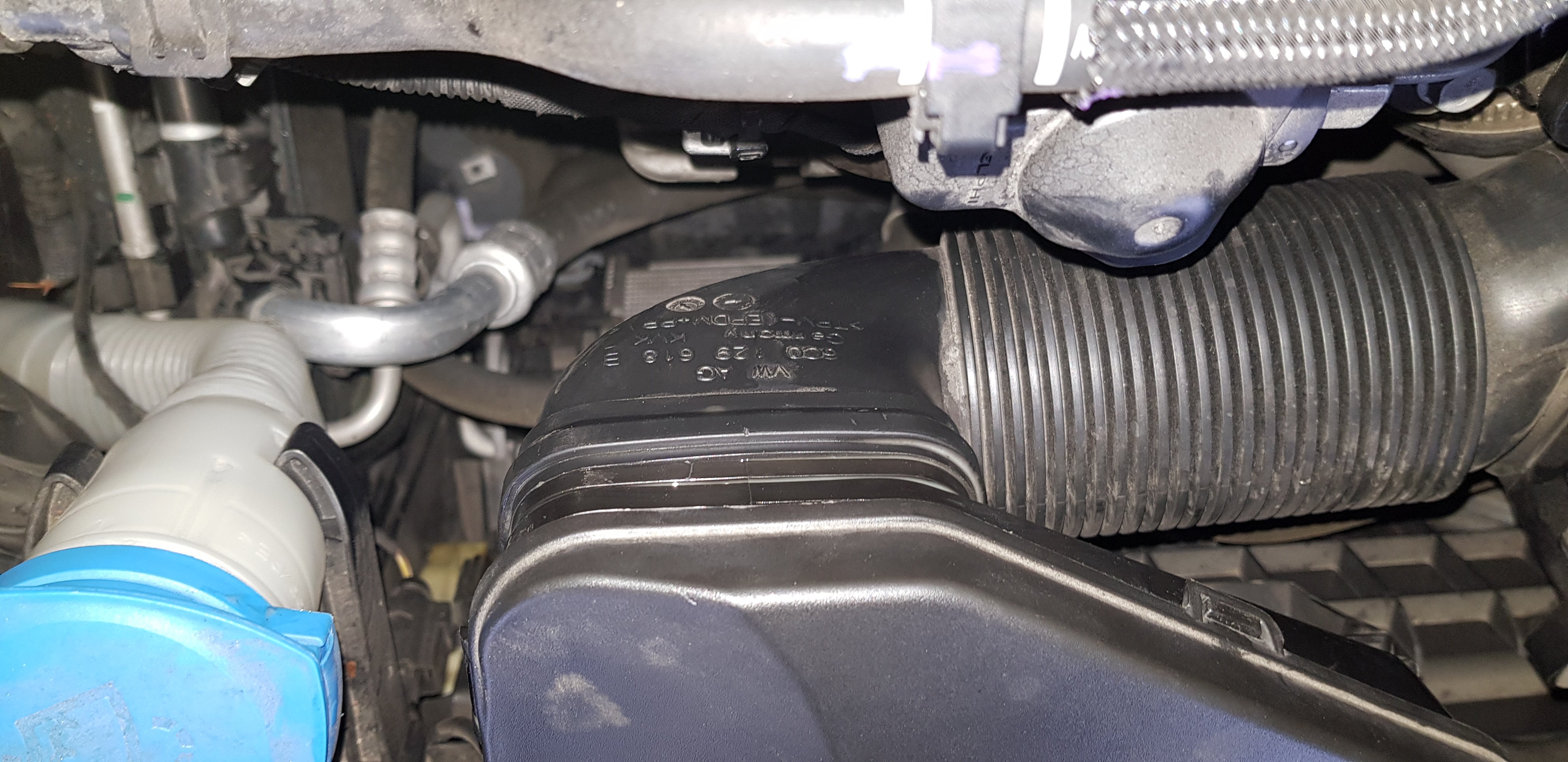

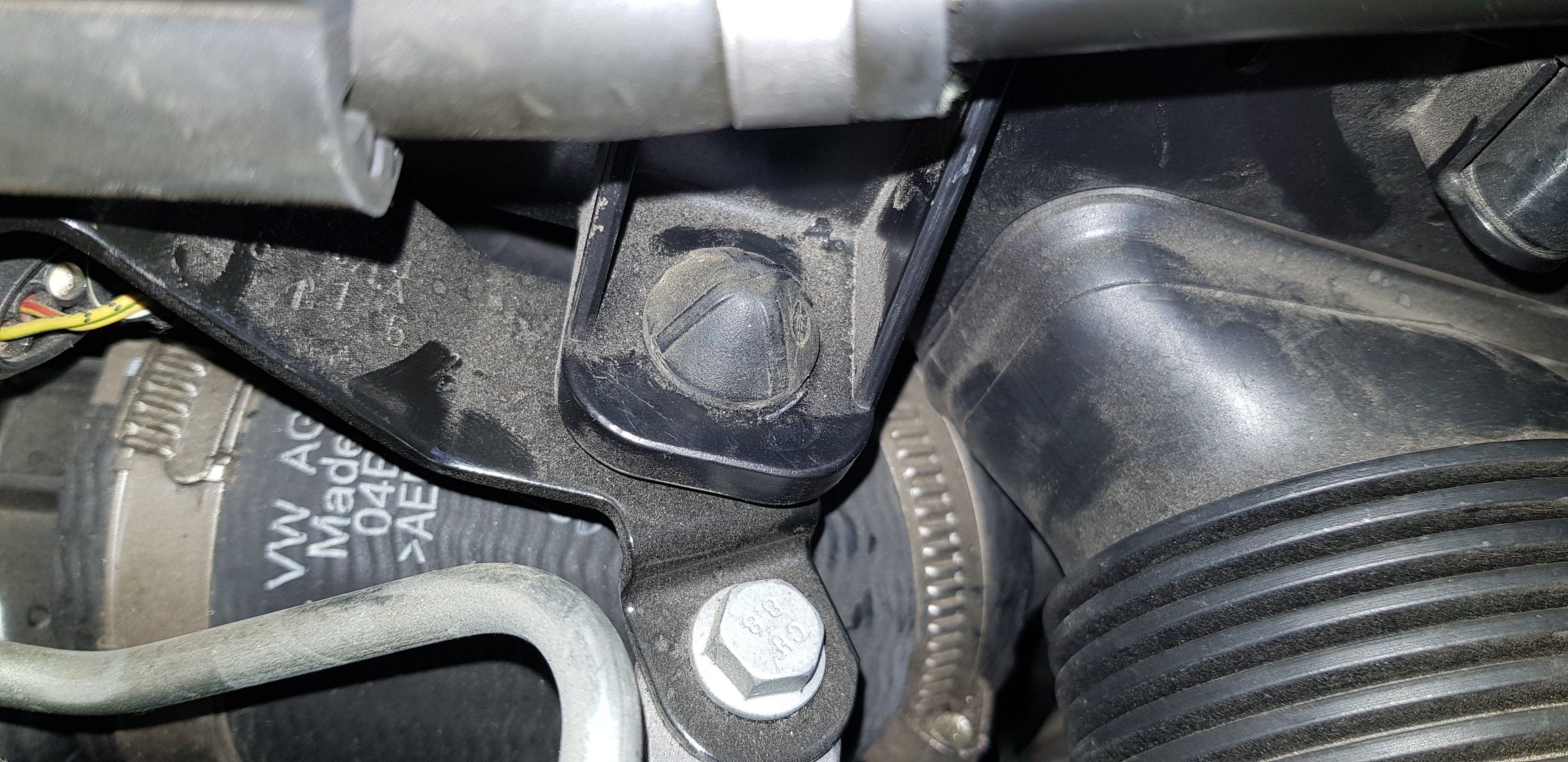

Hi, well I have tried as you said but I can't figure out how to pull out the air hose because it's seemed to be stucked, and I have no idea how to unscrew the rubber nut. Is there any video showing how to change the air filter on this car.

To remove any VW Group engine air filter assembly that is retained by these fixings, you need to be quite brave when doing it the first time, try "rocking" one corner up and down increasing the force/pressure that you are grabbing it by, then move onto the next corner - and on and on.
